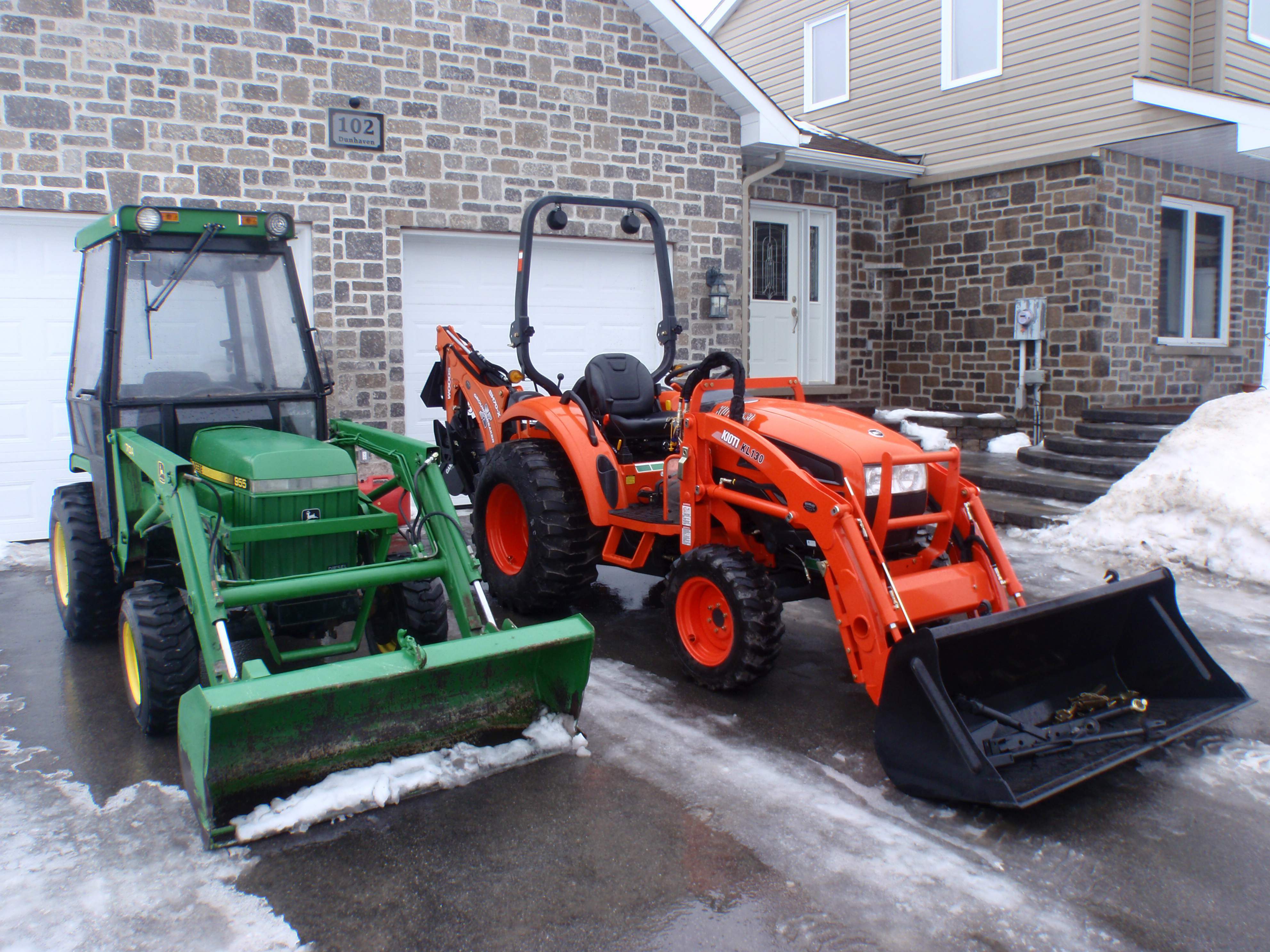

You never told us what they're asking for either of the tractors. Also, is there a reason you've focused on the JD X55 series? When I bought my first tractor, I would only look at JD or Kubota, I figured I was safe with the two that I knew. I'd be hard pressed to say my JD 955 was a mistake, it was a great little tractor, but I now know there are plenty more colors that are worth looking at. Not sure if this is your first "tractor" (gx345 isn't in the same league) or how you settled on the X55, but posting a budget and other possible uses may open up a whole new world of choices for you. The 855 you're looking at sounds like my 955, beaten and neglected, but a fun project. Unfortunately, there was always something to fix, even after I did a pretty good restore on it. It blew a hole in the rear housing and that was all I could take.
You're on 10 acres and have horses. I can almost guarantee you'll find uses for a tractor that will far exceed what an 855 is capable of doing. I think it sounds like a great second tractor in a situation like yours, but there are going to be times that you're going to want more hp, more weight and more lift, both FEL and 3 pt. I bought 3 tractors in 3 years moving from a JD 955 (approx 2000 lbs) to a Kioti DK45 (approx 6500 lbs). I bought the 955 for a specific project and now use the DK45 for stuff I would never have imagined. I fear you may be going down the same path I did.
