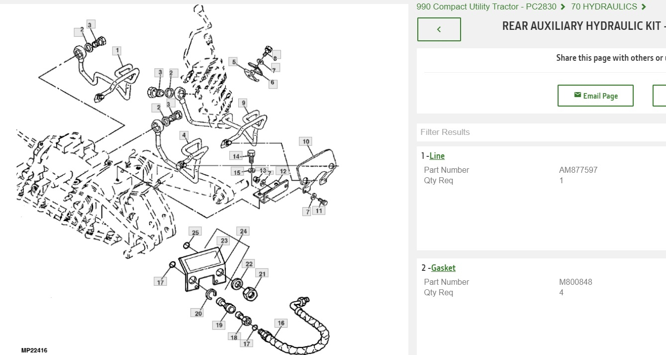

We'd like to hear more about y our JD 990. What you use it for and what you are going to add to need power beyond. Maybe a back hoe? or a grapple to the FEL?
Use my added 3rd SCV to activate the hyd. top arm, and then switch connections to run a Thumb on the forks.
JD parts shows a kit (probably the one no longer available) with part numbers. You can check it out and wander the other pages for some more info and part #'s
Copy of one page to see what I'm talking about.
