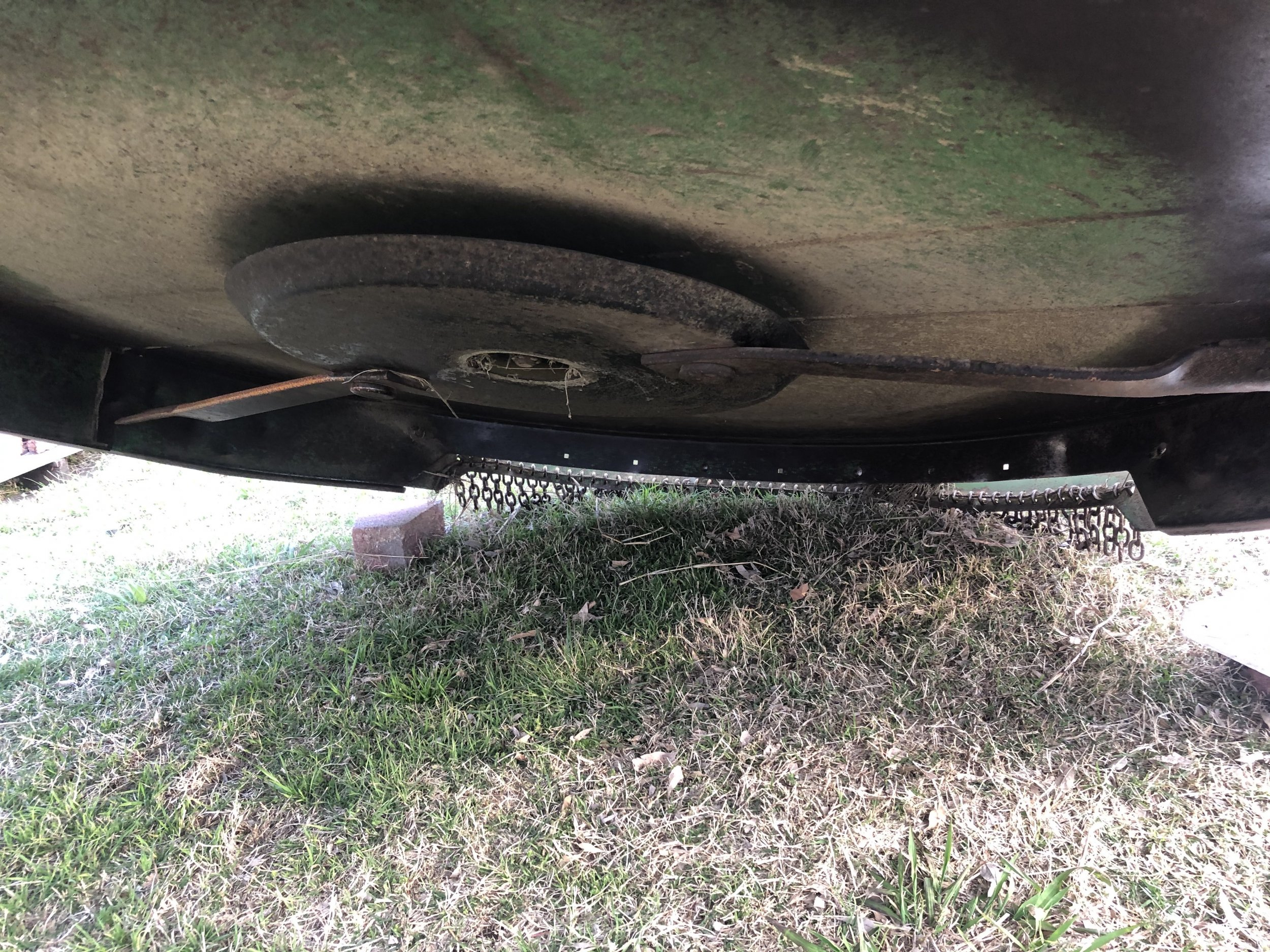

Get a small Angle Grinder with a coarse Flap Wheel. Raise the blade to maximum height and prop it in position with chunks of wood or Axle Jacks. Cement blocks can crumble.
There is only a few inches at each end that needs to be sharpened and not knife sharp either. Leave a 1/16" flat at the edge. Try to take the same number of passes on each side to keep balance. You may need a Vise Grips to hold the blade for you. Safety GOGGLES.

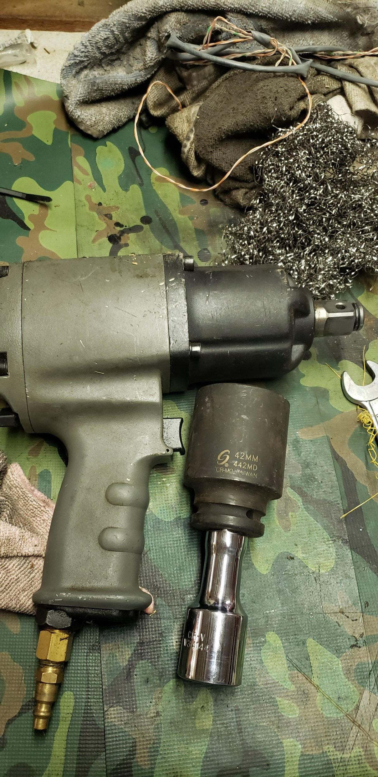

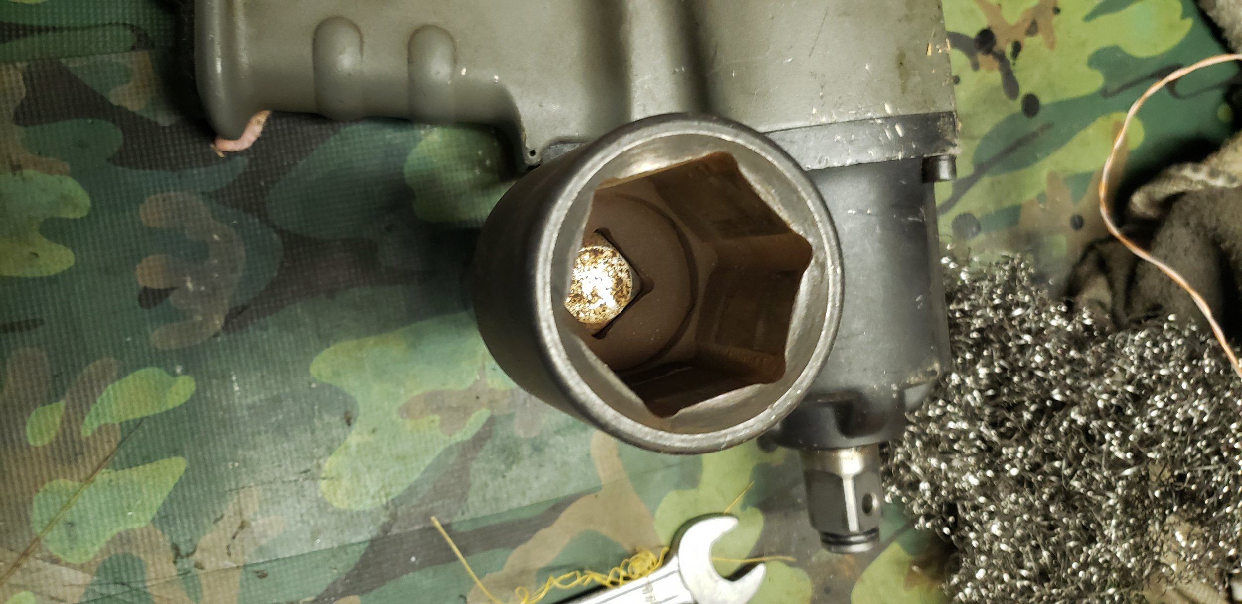

This is what I use to remove the bolts. Works every time. That's a harbor freight air gun 3/4" Never had to cut anything. I've replaced the blades twice and sharpened them 6 times.
