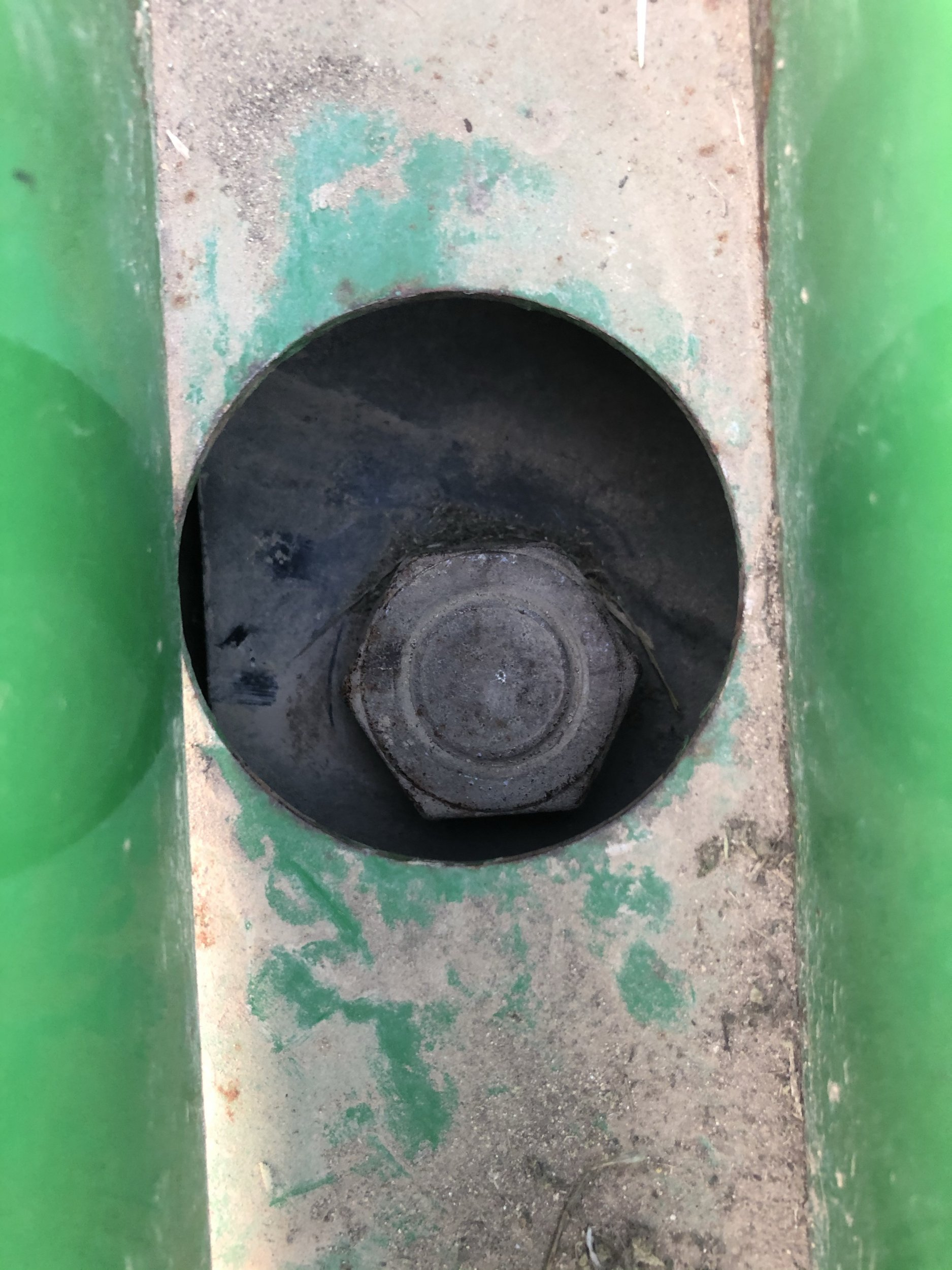

I have a Frontier RC2072 cutter and the blades need to be sharpened badly. Manual says take the tail wheel bar off to expose the access port, turn the blade pan by hand to locate the 1 1/2” bolt to remove the blade.
I’m guessing there is a small dent in the pan because I don’t have enough room to fit my socket over the bolt.
Will I need to replace the pan or can I get a few more seasons out of it? If I don’t have to replace it, what’s the quickest way to get those bolts off so I can sharpen those blades? Also, manual says “I must replace mounting hardware when reattaching the blades”??? Not sure which hardware it’s referring too exactly.
If I have to take the pan off with the blades attached, how heavy is it? (I’m a 120lb woman doing this alone. Upper-body strength isn’t exactly my forte lol)View attachment 691908
Take a cut off grinder and enlarge the hole to get to the bolt. If you cain't break them loose borrow or buy a 3/4 inch $69.99 SAE or metric Search Results For "3/4 In Socket And Rachet Set" Use a pipe for extension handle. Don't try to change the Pan/Flywheel unless it is bent, you have to dismount the mower and stand it up and most likely will require heat, it weighs around 60lb. I sharpen them on the
