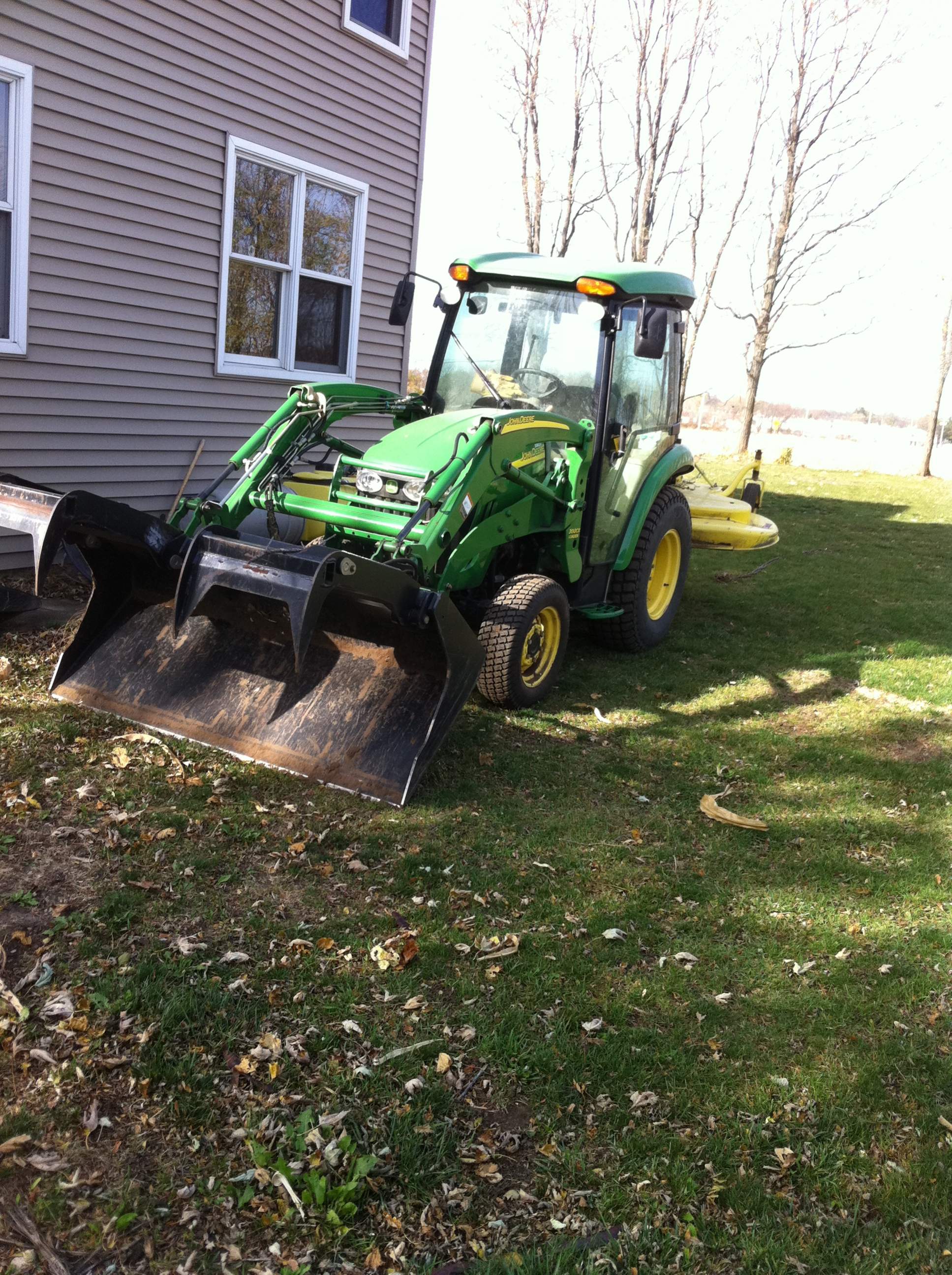

The Deere build your own thing says a Frontier 72" grapple bucket for the 300, 400 series is $3052. You need the 3rd scv kit to use it.
I would be aggravated to order something that doesn't fit the carrier.
There's nothing like knocking over a tree and picking it it with the grapple. Or picking up branches with it. Time and back saver. I even pick up fair sized rocks with it.
Also it is enjoyable to approach vehicles who show up in the drive with people who ask dumb questions. Intimidating.
