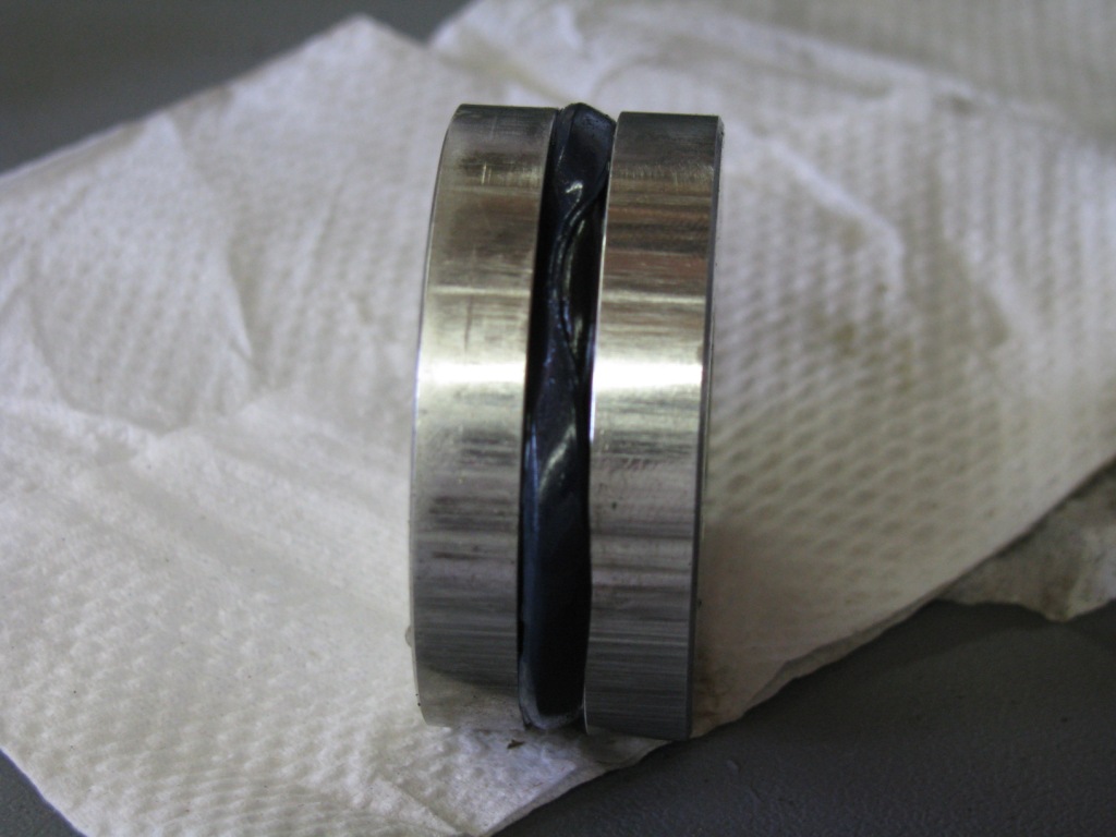

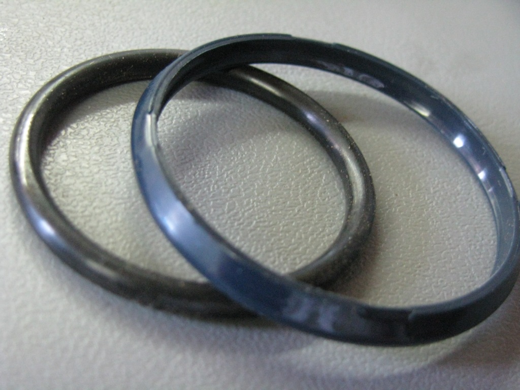

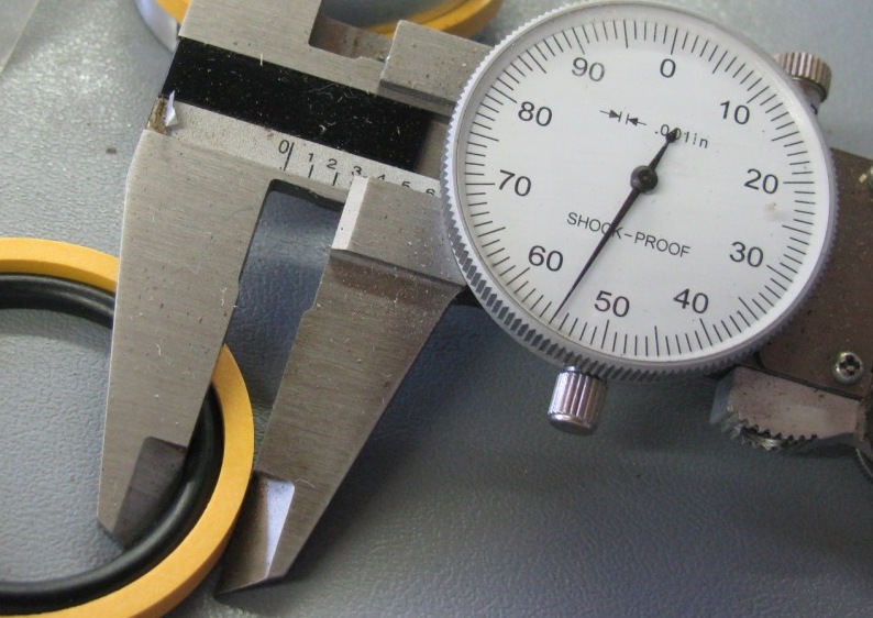

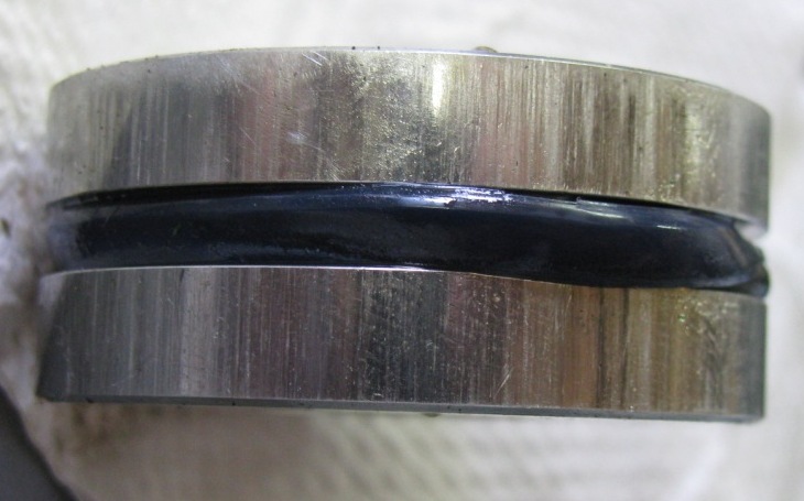

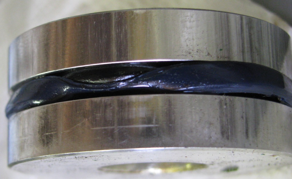

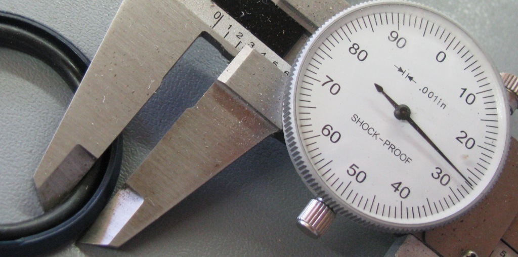

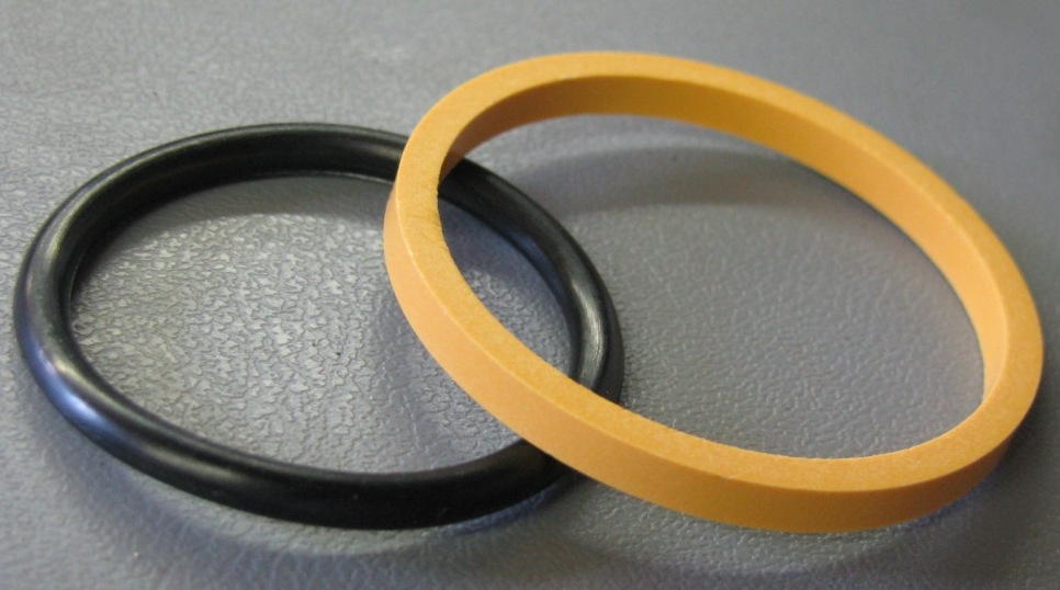

Good evening, Andy --
Exquisite timing! I had just downloaded some pictures that I was going to post to this thread when I saw your response. Thanks for the insight!
Though I have already assembled all of the cylinders and installed, the pictures do reveal several things. Looking at the originalpistonseal picture, you can see the base O-ring and a thinner tapered seal. The newpistonseal has the same O-ring but a much thicker non-tapered seal. Looking at originalpistonsealmiked and newpistonsealmiked, the difference in thicknesses is significant. Pictures failedseal1, failedseal2 and failedseal3 show how the too-thin original tapered seal is insufficient to do the job, with the failed seal allowing the underlying O-ring to protrude beyond the tapered seal. Upon disassembly, the O-ring had actually separated and disintegrated.
These pictures are close-up enough that you should be able to see the grooves in piston area that I had mentioned in the earlier post that led to my questions to you . . .
Richard

   / JD Hydraulic Cylinder Rebuild Help? #14
Richard,
Sorry for the delayed response. I have been extremely busy recently and will be for a while. I have come to dread weekends.
Very good pics. I am very familiar with your piston seal design. It is a very good design but the one I despise working with the most. It is always such a hard time getting the piston seal (yellow ring) over the piston. I guess now you will just have to wait and see how your cylinder behaves. I have seen things put together and thought "No way will that work." But, many times I shake my head in amazement as it turns out just fine. So, I never say never.
I would extend the rod out all the way and check for any bends. Bending usually occurs in the lower third of the rod. The further the rod is out of the cylinder the weaker it is. It's all geometry. Someone like Larry could explain it much better than I. If the rod is bent, you will notice some scuffing in the chrome at the high point of the bend.
The o-ring underneath the piston seal has a different function than you may think. It really doesn't seal anything. It keeps the piston seal "loaded" against the cylinder wall. It just keeps the piston seal in place, keeping the right amount of tension between the piston and cylinder. You obviously have an updated piston seal configuration in your new kit. I've received many new kits with completely different parts and thought that no way that looks right. But, they fit in there and work well. So now I always try the new kit before I panic.
Good job on your cylinders and let us know how it works out.
Andy.
