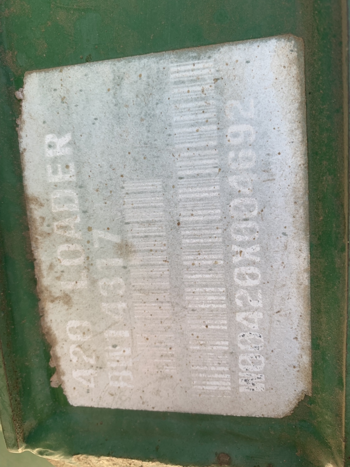

I have a 98 john deere 4300 with a 420 loader. where do I look for the serial numbers to determine which kit to buy?? thanks
There is a tag on your loader frame...or should be.
   / JD Hydraulic Cylinder Rebuild Help? #27
Here is a picture of my tag. Don’t really know where to start as far as rebuild kit for the cylinders on the loader. Any help
   / JD Hydraulic Cylinder Rebuild Help? #28
420 SN appears to be 004692. lift & bucket cylinder kit appear to require the same kit AH176344
