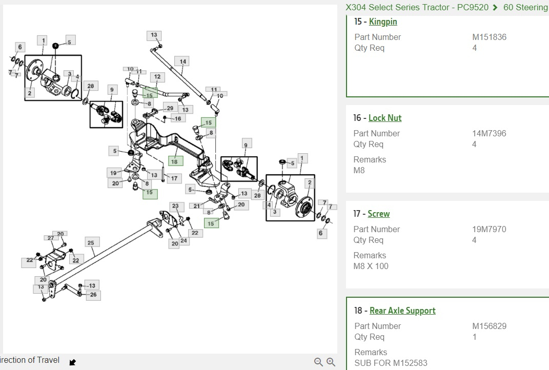

Are the "big" pins key #15 in the parts?
   / JD with AWS need to remove transaxle #12
Yep. They're about an inch and an eighth. Whatever that may be in metric if I recall when I pulled the joint before.

Unhook the steering, buzz the two big pins out , and it should all slide out w/ the U joint assy. Then to the carrier I'd think. Hopefully the splines were lubed. The roller bearing will likely drop out the bottom , so just keep track of it.
I hope they buzz out. That is my biggest concern. None of this has ever been apart. I do not know if they lube use anti seize on any of the spiines at the factory. Probably not?

Here is an update. I got the transaxle out of the machine and separated from the carrier. No need to remove the fenders. Everything was easy enough to get to from underneath. The king pin bolts came out with out much trouble using my impact. TomPlum was right..... I used a 1 1/8 6 pt. impact socket. It fit very tight which is good, so I would bet it is actually a 29mm hex. My problem now is trying to remove the U-joints from the splined shaft on the old transaxle. They are both rusted and frozen. I am soaking over night in penetrating oil. I have it vertical so that gravity will help draw the oil through the spline. It will be tough to get off. There is no good way to hit it with a good blow. the approach is from a steep angle. It's never easy! Is it? I do not want to use my air hammer but may have to. I do not want to damage the u-joints. Not sure if they can easily be separated and then reassembled with out compromising them? If so I could press it through in a 5 ton press. In any event I am going to use some heat tomorrow, if I need to. I need to be careful to not damage the bearing seals in the u-joints. They are rubber.
