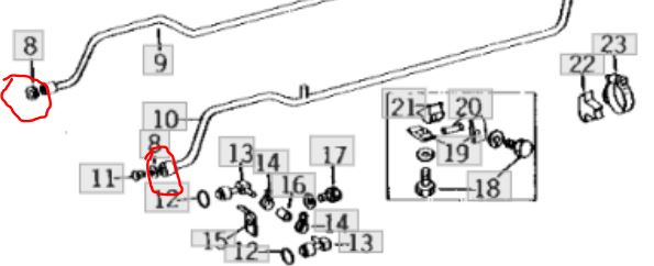

Can you turn the shaft that drives the transmission pump by hand?
Rear seal requires a special tool to install the new seal.
Be sure to use new packings (rubber washers) on the two oil lines to the lower right transmission case.
   / Jd1020 hydraulic problems
#20
Be sure to use new packings (rubber washers) on the two oil lines to the lower right transmission case. View attachment 700653
