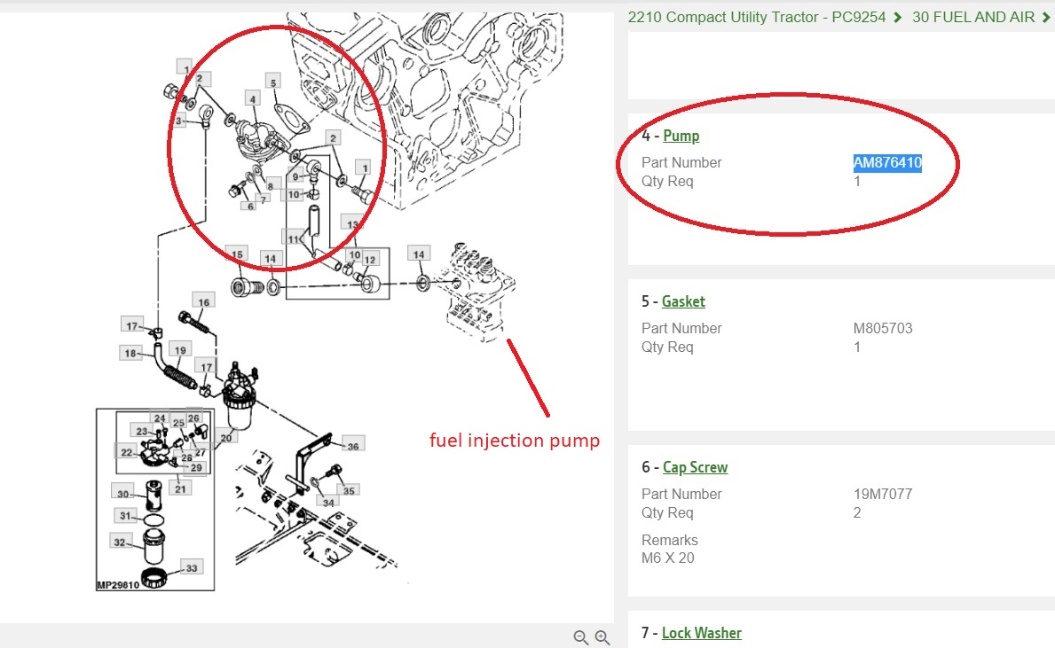

first I connected my marine primer bulb hose kit to the pump and squeezed. As I squeezed the bulb it coughed which is a bit more action than previously. Next I bypassed the FP and connected the bulb hose directly to the fuel manifold. this time it started and ran smoothly as long as I squeezed that bulb. So from this I conclude its the fuel pump. Actually I did not think the pressure of the marine priming bulb would be enough to make it run but I suppose it doesn't take much.
It could be I squeezed the air out the line(s) and now reconnecting the old FP might work again although you have to wonder how air got in the line to begin with.
I hope the defective FP did not leak oil into the crankcase. Probably a good time to change the oil.

   / JD2210 subcompact fuel pump failing? #14
As I see it, the fuel pump that supplies fuel to the injection pump, is part #AM876410.
$150 on Amazon
#15
thank you for that p/n.
I see them listed on ebay for $40.
Now I am thinking that pump is actually a lift pump to get the diesel up to that mechanism above it that is actually the high pressure diesel pump.
