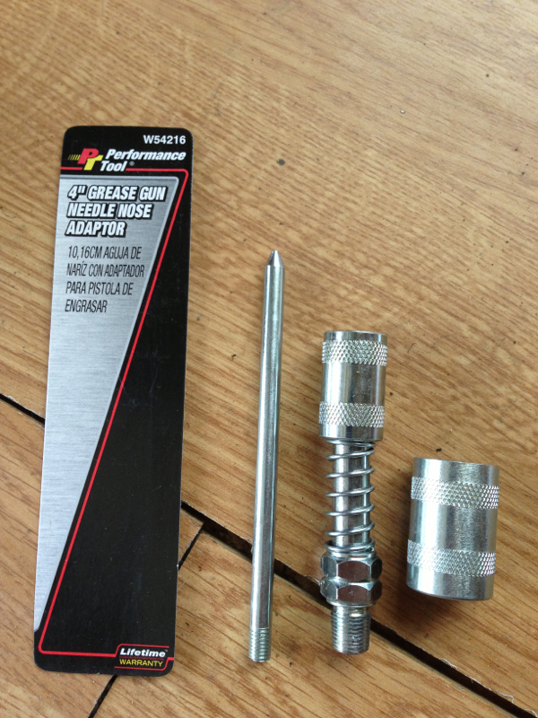

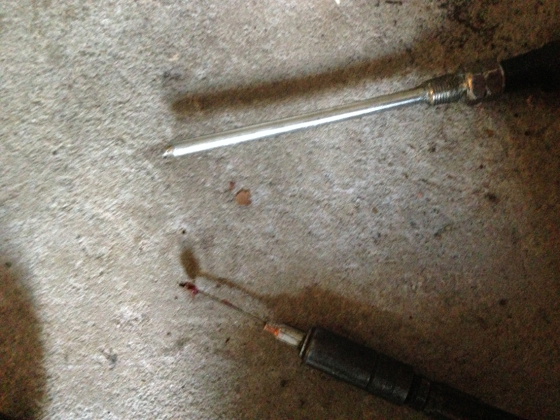

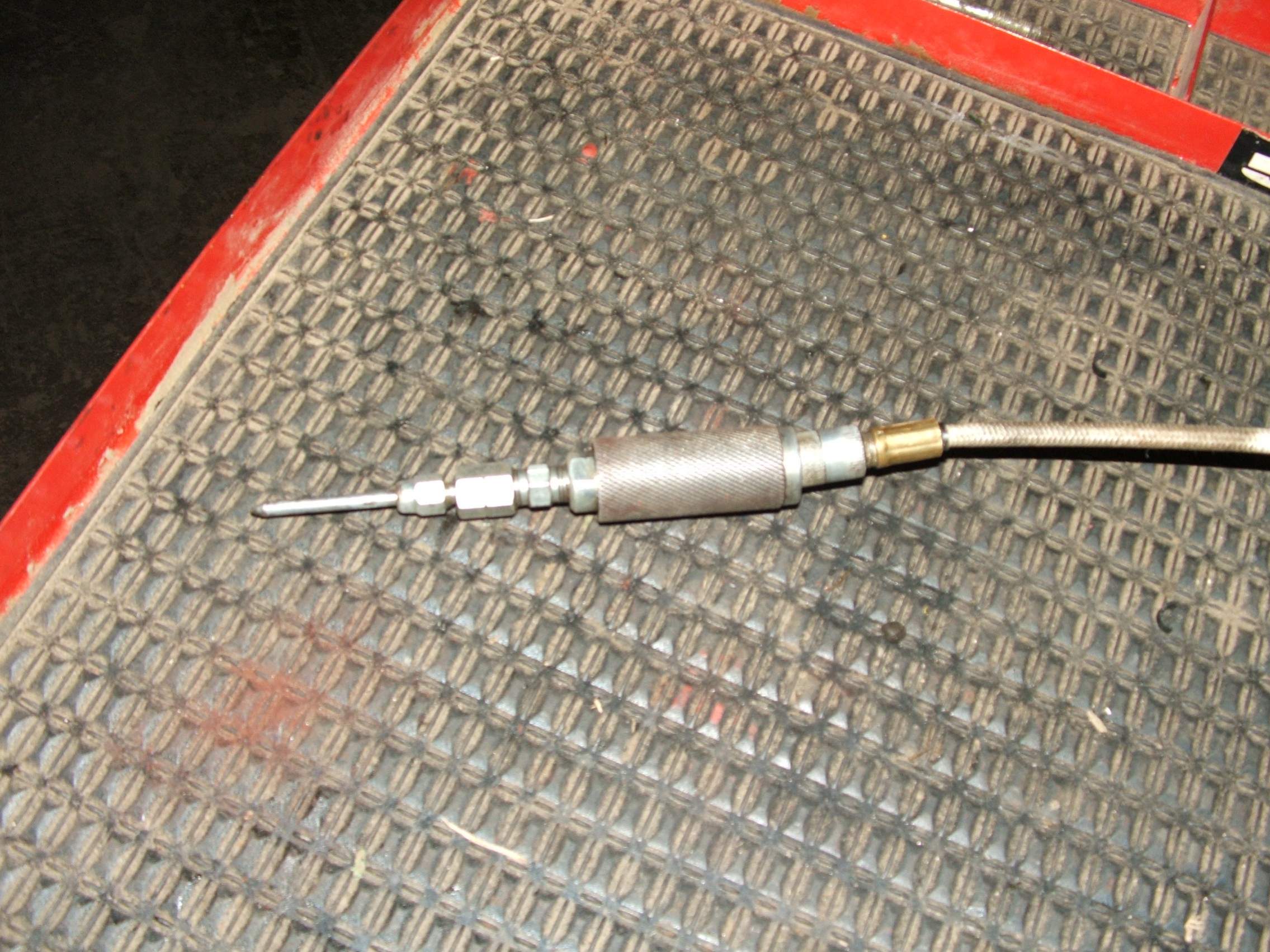

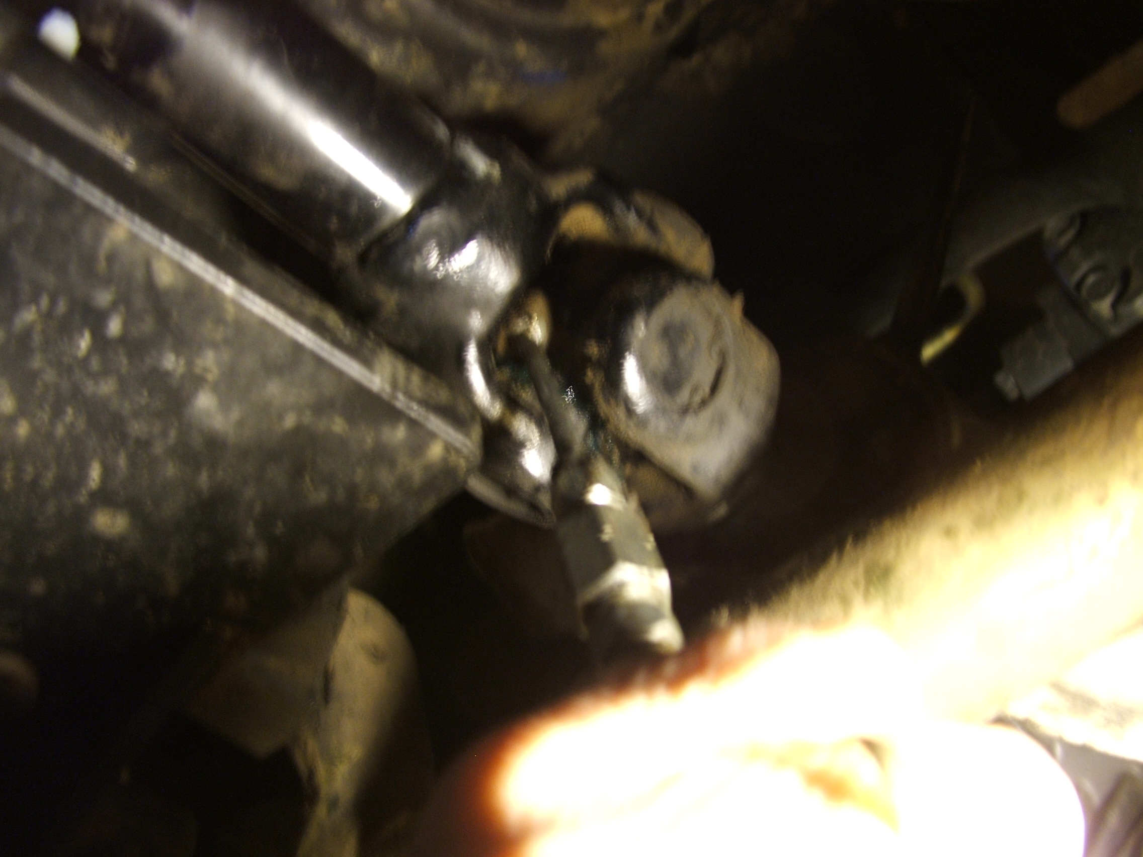

I have two types of "needles" for my grease gun.
One like pictured above. I have used it to pump a booted CV joint full of grease and a couple times to slip past the rubber seal on each cap of a u-joint.
The one I use most replaces the nipple on the grease gun tube. Unscrew the normal type and screw on the needle. It isn't sharp, only slightly pointed. You press it against the sealed ball of the zerk and it seals against the ball seat and pushes grease around the ball. Poor explanation, I know. I'll try to get a picture of it. I use it on some driveline zerks that are difficult to get a regular nipple on. It is what I used on this project.

Great if you can post a pic. I'm running to the auto store in the morning. Ill post a pic one if I'm able to find one. Bill
   / JD2210 upper driveshaft service/grease #25
Part number W54216. At Advance auto $7.99
Be next week before I give it a try.

Yep, that's very similar to what I use.

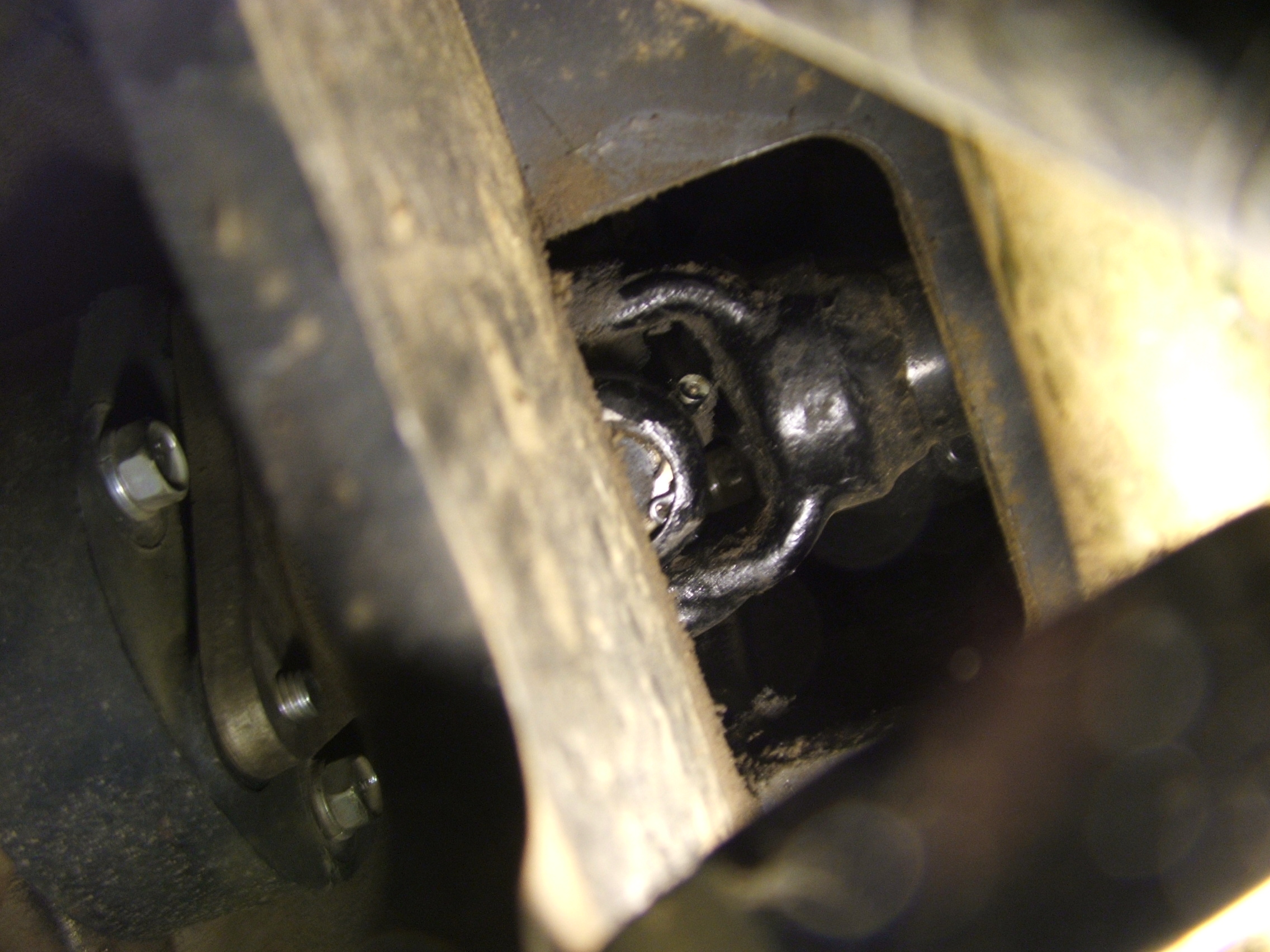

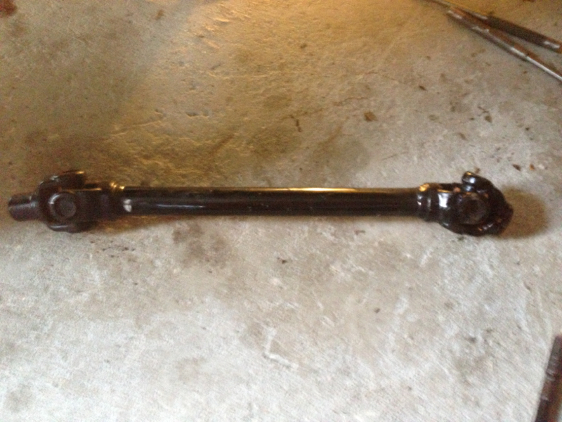

Okay. 3 hours spent trying to get the zerks to accept grease with the needle adapter and nozzle adapter.
Took whole shaft off in ten mins, greased and installed in 15 mins.
Who ever designed this blankety blank system, needs to go back to engineering design school.
Argh. Bill V.

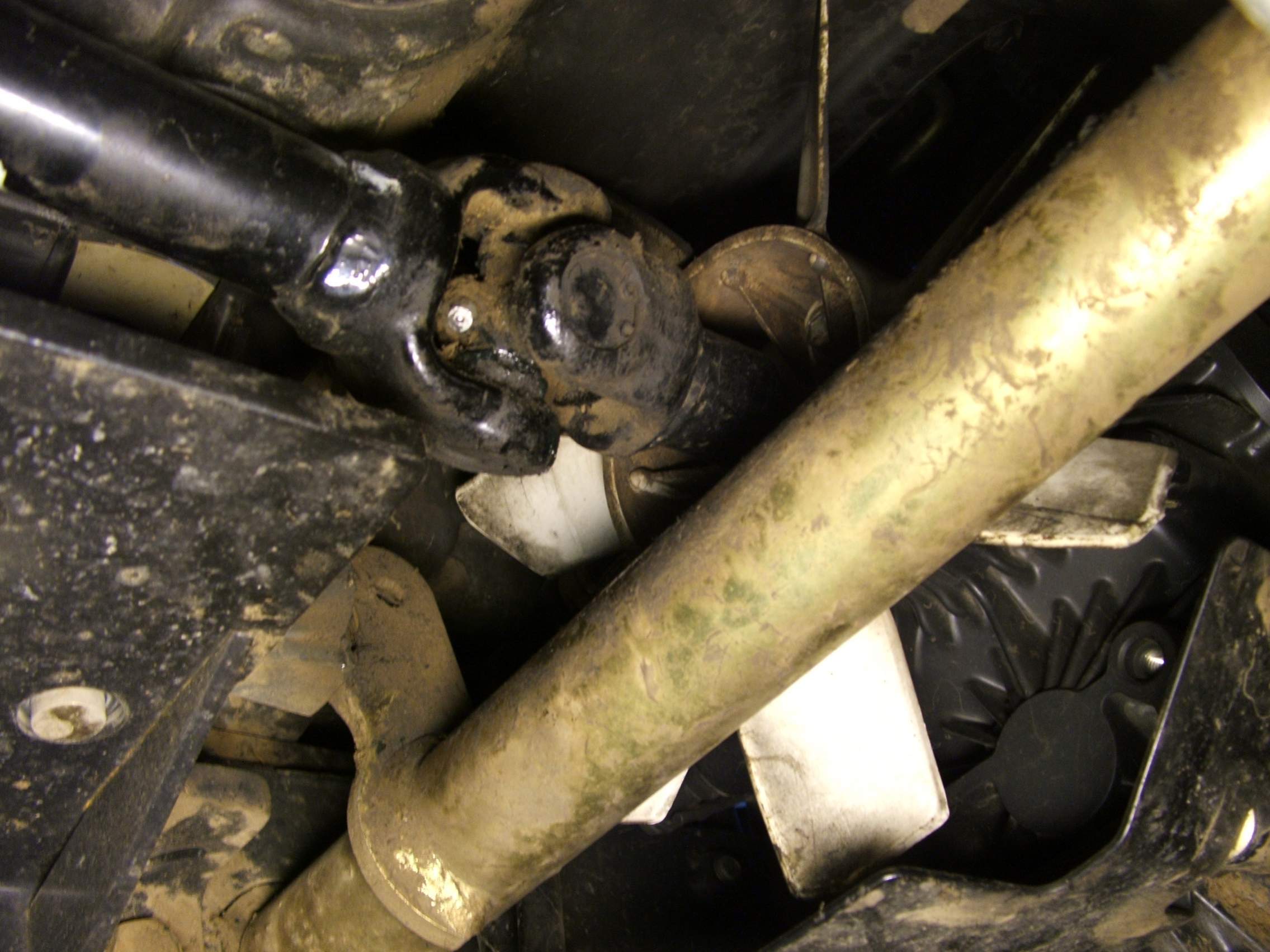

Ovrszd. Thanks for bringing this to all or our attention. Probably just saved my u joints. And I'm sure others even if they don't post .... On my JD 2305 (2010) It has 195 gentle hours on it and is very much babied. After taking the driveshaft off, greasing both joints and installing. I decided to try and find a place to cut a hole to access easier. I removed the floorboard and honestly can't find a good spot. For me, every 50 hours I will commit to dropping this shaft and put some grease in. It's a lot of work but I don't see an alternative since I had zero luck with the needle or nozzle approach. ( ground down an old grease gun and couldn't get it to fit ) If there is a better way - I'm all ears. Best wishes to all who tackle this and keep it from damaging the joints. Bill V. Vanatti767@yahoo.com

If you manage to take the whole shaft of in 10 min. and back on in 15, tap yourself on the back. I haven't done it myself, but from what I read it is not and easy task. Still no reason why you couldn't grease it with the needle. I know it can be a pita, but still easier than taking the whole thing apart. Maybe because it had never been grease before and needed more pressure than usual? Have you notice if there was more resistance on the first shot of the pump? Have you tried it with the needle once you had the whole thing on the floor? Sorry for all the question, but I hate to see you taking the whole thing apart every time you want to give it a few shot of grease. I grease mine and it only takes me a couple of minutes. What exactly was the problem, grease spitting out beside the zerk or just wouldn't go in?
