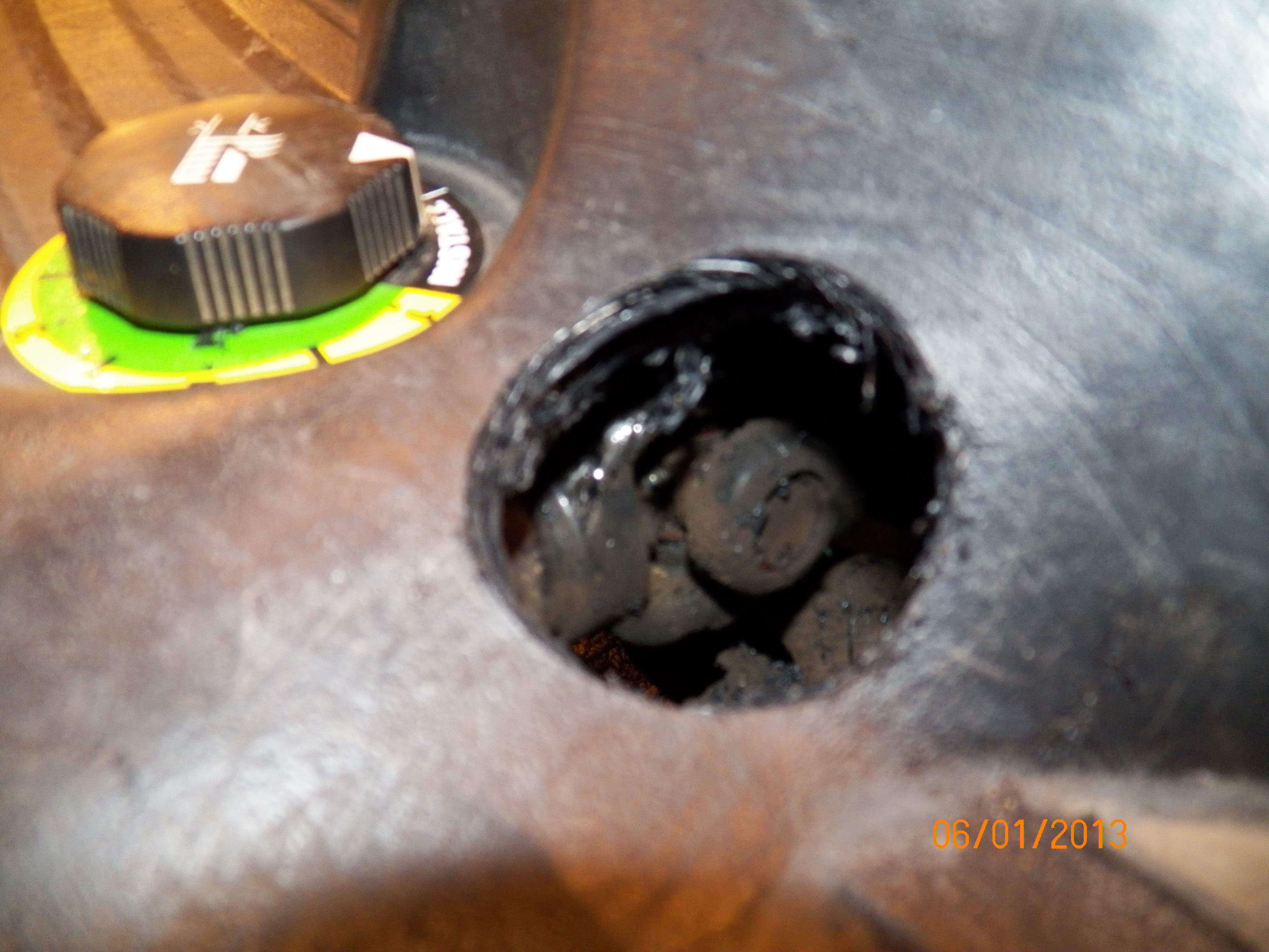

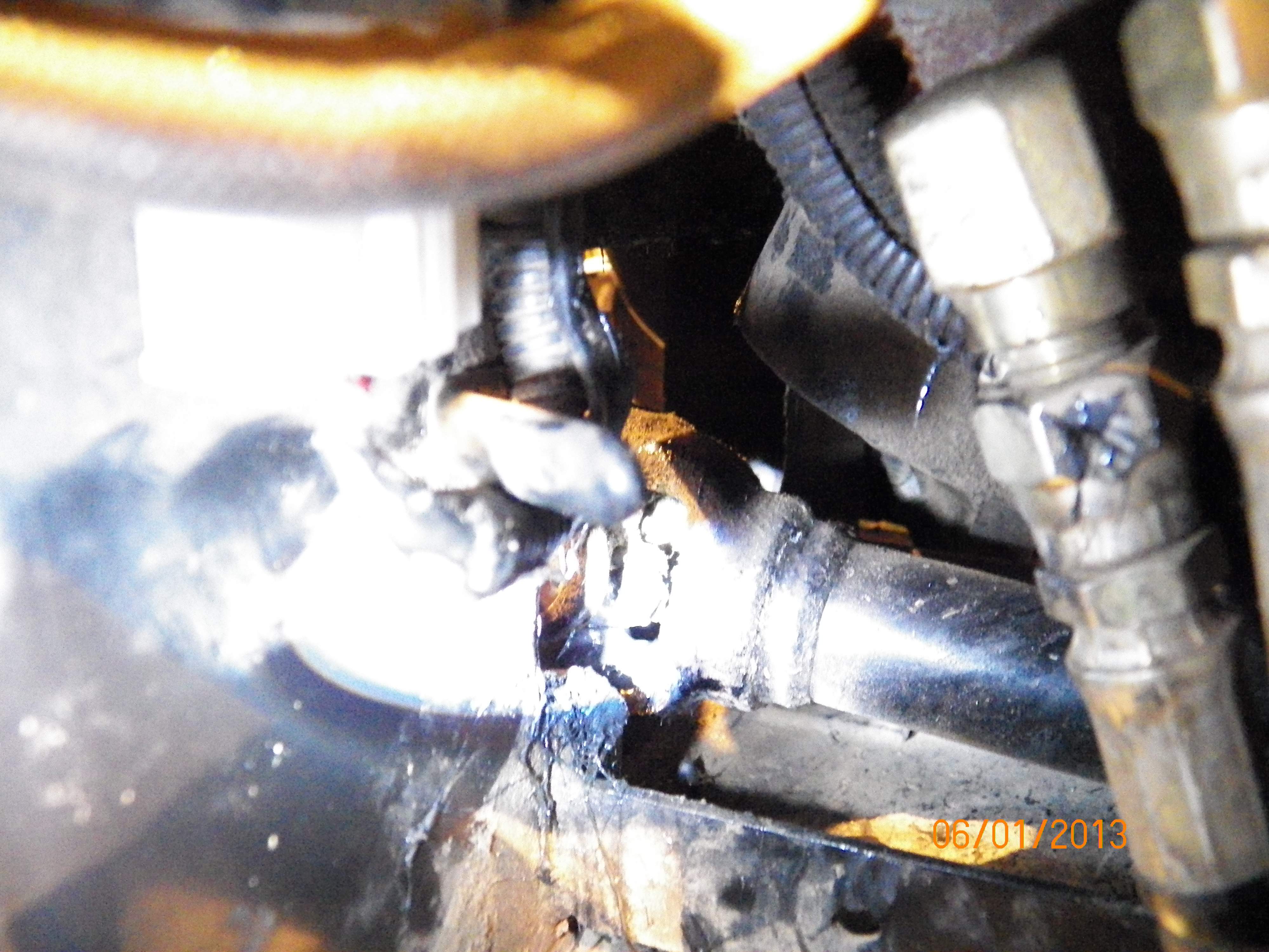

UPDATE; Now have 50 hours on my new spider bearings and spent some time this morning trying to access the zerks, here's the story. Cannot see/access front spider at all. Left side access plug only shows some cables right in the way of getting at the spider. Solution; disassembled console/kick panel. Now I was able to tweek the zerk and lube it. Also while there on the left side I moved some of the cables blocking access. Future access; possible! via access plug. Bad/sad part; I pumped a lot of grease in and it all came out ONE of the spider bearings!!! so the rest? of them?? who knows?
Rear spider access; impossible! Found a small slot underneath the tractor to access the back of the spider... but the zerk is on the front!!! :scratchchin:
Solution; drilled with a 21/8" hole saw an access hole on the floor. Access now possible but will require modification to grease gun. Note to self; in the future when I overhaul this shaft, place the damned spider so that the zerk is more accessible!!! :pullinghair: I should be able to find some sort of plug to cover the hole in the floor.
That's why I cut a rectangular hole to match the front one. Bought a plug from JD to cover it.
