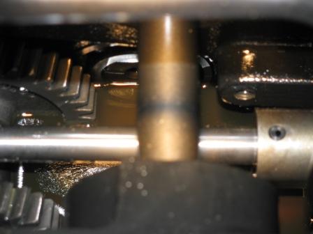

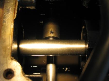

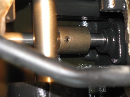

shiftrodverticalasviewed fromleftsideoftractor.jpgR&R FOLLOW-UP
Early this morning, I took the shift lever with broken shift shaft to my machinist friend. He concurred with me that the O-ring groove, in conjunction with its location, the leverage exerted on it, and the weight of the shift lever all contributed to the breakage of the shaft. He quickly concluded that attempting to weld it would be futile, so I did not bother doing anything but R&R after that.
He is going to take the factory shaft that I should get in tomorrow and make a duplicate out of 4140 stainless for me without the problematic O-ring groove. This, along with the greater strength of the 4140 should solve the breakage problem.
After spending about 15 minutes there, I came home and began removal of the rockshaft cover hoping that this would be sufficient to do the job. Start-to-finish on R&R was, surprisingly, only 1.5 hours, and this included removal of the left fender which enables you to sit on a rolling seat right next to the transaxle case.
It was a great result: there is absolutely no need to split the tractor to replace this shaft. Indeed, the only reason that one would split the tractor relative to replacing this shaft is if you installed the updated shift fork kit which must come out the front. This is somewhat surprising since one of the dealers that I called for an estimate (out of town) said that the tractor must be split to replace the shaft. Either he is referring to installing the shift fork kit at the same time, or, I don稚 want to think of the alternative.
Once the rockshaft cover is off, it is wide open to get to the shaft. I've enclosed some pictures of the area as attachments.
About the shift kit: I had to drain the hydraulic fluid in order to inspect that area, because the oil level is above the shift forks. [Note for discussion in a minute that the shift shaft is well above the oil line.]
I could find no problems whatsoever with the shift forks and I looked hard for problems. No bits of anything in the suction filter area and nothing on the magnetic drain plug except for the normal amount of very, very fine, dark friction material from the 3 pt. arm unit.
I was pleasantly surprised regarding how simple this job was; it requires no special tools and accessibility is great.
I'm certain what I will do about oil seepage from this area w/o the O-ring. The use of an O-ring here is very, very poor design because of all that we have discussed. As mentioned previously, I will probably have the shift lever chamfered and put an O-ring in that will engage the side of the case which will serve the triple advantage of 1) keeping oil from seeping to the outside, 2) removing the weakened area of the shaft and, significantly, it will keep the entire bore lubricated (which the original doesn't) and that will prevent rust (and binding) in that area.
Another thing that I plan on doing is making up some type of locking device for the range shift lever so that I can lock it in "B" should I let someone borrow it. Indeed, the machinist has a Kubota which broke its shift forks a number of years ago. He lets a number of people borrow the tractor, so, after the repair, he literally cut the shift range lever off about 1 from the bottom. He feels the same way that I do about them: They have to be so long to reach the operator, that it is easy for anyone no matter how small to exert way too much leverage on those parts.
