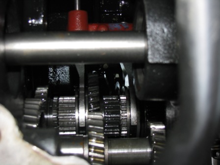

It is important to note that only the shift shaft can be replaced by removing the top plate -- to install the improved forks, the tractor still has to be split (Note the enclosed "shiftforks" picture -- the body of the forks is the red unit). Once I ascertained that my shift shaft could be replaced via the top, my next step was to carefully inspect the shift forks. I could find no evidence of any damage; they weren't bent, and the suction tube filter had no shavings of any kind, nor did the magnetic plug in the bottom of the case. So, at that point, I concluded that I didn't need the fork replacement. The smoothness and ease of shifting after reassembly provided further confirmation that there is no need for the improved forks.

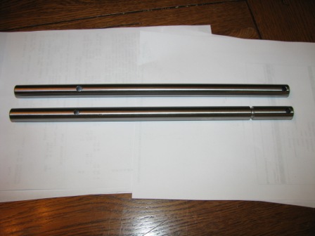

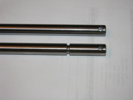

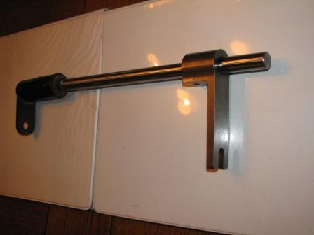

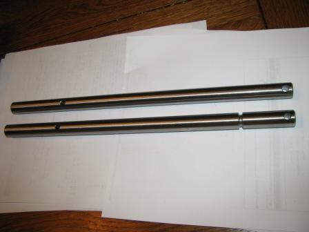

On the dimensions of the JD shaft, I think that the machinist was right: I received a shaft which didn't get the polishing that it needed in the last step in the production process. I have enclosed a series of pictures that illustrate the original shaft's problems very clearly.
The first shows the newly-made shaft (no O-ring groove) versus the factory shaft (O-ring groove). The one that is called "originalfactoryshaft," in conjunction with "closeupofbreakpoint" clearly shows how easily the lever exerts tremendous force on the O-ring groove -- that is the problem with the transaxle as designed.

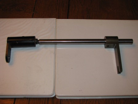

Good afternoon, Kyle --
Gotta love this wonderful Texas heat today, right?
I'll answer your questions in order from above:

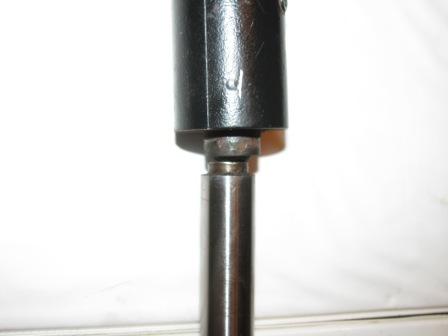

1. I'm trying to remember what I did on the external O-ring setup. Note the enclosed picture and the external lever on the left side. I either put a small thickness O-ring between that lever and the transmission case or I coated the area with a liberal coat of heavy grease or both -- I can't remember. However, I am thinking that I simply put the grease there as a heavy barrier to oil egress.
2. On the shaft, it was clearly "unfinished." And - it was the correct part for the tractor -- JD is very specific with respect to part changes through their lines, so I don't think that this was the problem -- I think that the shaft simply didn't get finished, and I hope that was the only one!!!
3. I must be confused about what materials they used, that's what I thought they said, maybe they didn't. I do remember them talking about the hardness of the shaft that they were installing and they were confident that the new shaft, in addition to being better designed, was also harder than the original one.
Addendum: I still can't believe that the shaft had an O-ring groove at that location -- in the center of the machined part-of-the-case bearing. In addition to this location being the exact point where levarging forces are their greatest (and the shaft is weakest), the area is also a moisture trap and collected moisture which gravitated to the O-ring groove and hastened the shaft's demise.
Having said that, I have been on the tractor off-and-on today and it is an incredible little tractor. One of my boarders was talking to me just the other day about how much utility we get out of the fork lift that we made for it. I am well on my way to "palletizing" my entire property, from firewood, to basically all materials. I have a friend that bought a tractor several years ago and didn't get a front end loader/forklift and I truly believe that one is missing at least 60-70% of the utility of a tractor without one.
Richard Easley
China Spring, Texas
   / JD4300 -- Catastrophic Failure of the Shift Shaft #40
I might have been tempted to use 17-4PH SST and hardened it H900 which would have been about 42 Rockwell. I agree fully that the Oring is the weakest link.
I bought the OEM replacement shaft....it is quite hard, and not SS. JD
has used the O-ring slot seal strategy for both of their brake control shafts,
too, but not the diff lock shafts, and not the MFWD shaft. Go figure. The
latter shafts use conventional seals.
If you want to seal up a solid shaft like Richard has, I think the best way is
to slightly chamfer the hole, then use an O-ring around the outside of the
shaft, and a O-ring retainer that is bolted to the outside of the block. Not
an easy job unless the gearbox is out.
