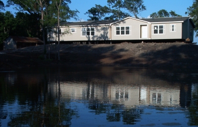

I've got loads of pictures, but I don't want to bog down this site with them. Our new home was finally delivered this past Wed (see attached image named "home_on_pond_apart01cr_sm.jpg"). It is still in 2 pieces. They should have it put together, skirted, and finished out some time next week. The pond is looking nice, but the rest is still kind of rough. It will look much better after the dirt is smoothed out and grows grass on it.
The building on the left side in the background of the picture is 2 story antique cypress wood barn. You can only see the 2nd story in the picture. Several people have told us that the antique cypress wood planks on it are valuable. Apparently there are craftsmen who make things out them.
We have a long way to go toward getting the entire 41+ acres fenced. We hope to have about 1/3 of it enclosed within the next couple of weeks. So by then we ought to be able to move our animals out there and perhaps even ourselves.

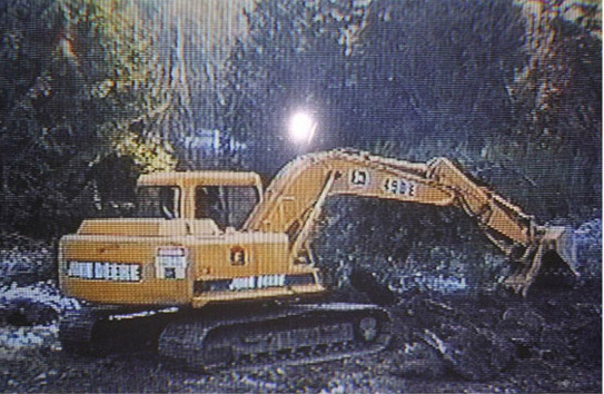

Very cool, don't worry about the site, it can handle the pictures you want to upload. My parents did the same thing yrs ago. We had land cleared and we put a manufactured home on a 5 acre lot. Here's the John Deere 490E that I drove (I was 10is or younger) when he was working on our lot.
Blake
WA
