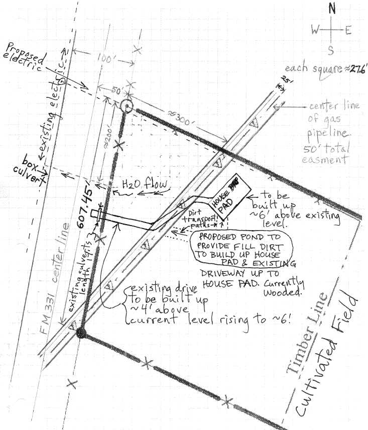

Well I am glad that the property is not in Austin if it is so bad there. The property is in Austin County whereas the city of Austin is in Travis County. The property is closer to the city of Houston than it is to Austin.
I have attached a low res reduced image of the latest version of the plans to be submitted to the US Army Corp of Engineers. I will let you all know how it goes.
Thanks,

The COE (Army Corp of Engineers) did a site visit today and gave the OK for our plans. They said that where I want to build up the dirt is not in a wetland and therefore outside of their jursidiction. They also said that we can dig fill from the adjacent wetlands with an excavator.

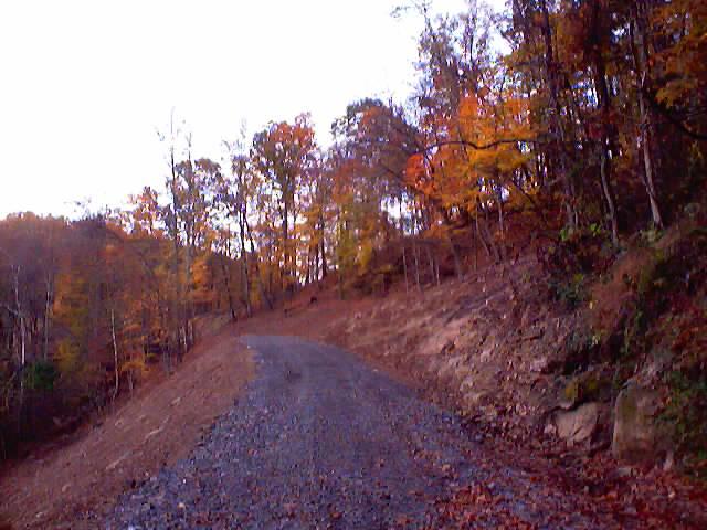

My 3,500 foot driveway to my new house seat wound up going through the roof due to an unusually wet season last year and some very destructive mudslides this last November.
I'll post a couple of "before and after" shots of one spot where the road base collapsed (it's since been fixed, but no "new" pics yet. can't seem to locate my digital camera /forums/images/graemlins/confused.gif)
   / JD450 to make driveway & house pad? #18
Pre-mudslide
