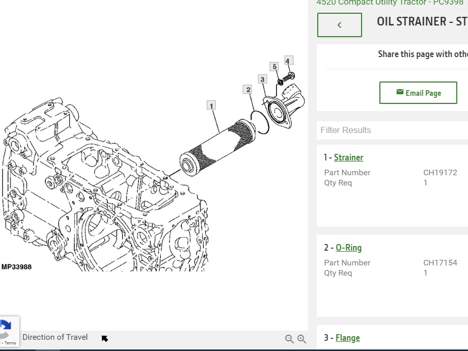

This is the compact utility 4520, and has this filter strainer..
Think given the right vs left difference, I'd want to know what the oil pressure is at that steering cylinder. Not overly expensive to check that out, but time consuming.

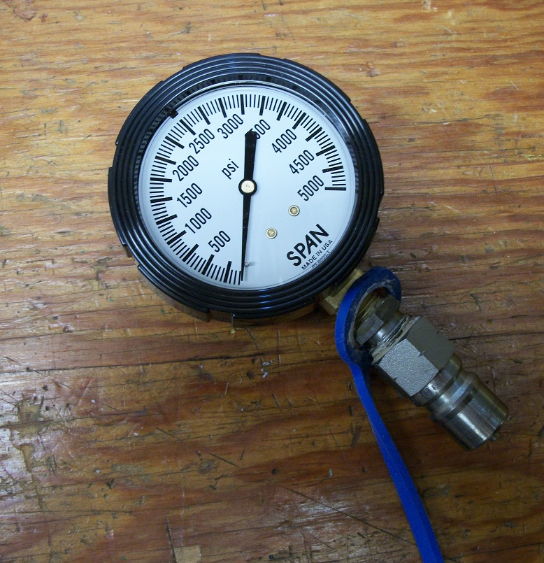

It would be great to put a gauge on both lines to the steering cyl lines too. I wonder what amount of pressure ga I would have to buy?

Thanks, I was pretty sure that would do it, just ordered one. It is a good idea to check that steering cylinder and the pressure to it before making the big decision to have a JD dealer replace the Steering Control Unit. That $1800 cost is a big dent in my wallet....

I got my gauge today. I hope to test those lines to the steering cyl soon. Might be a week or so though. Ill post the results here after testing.
