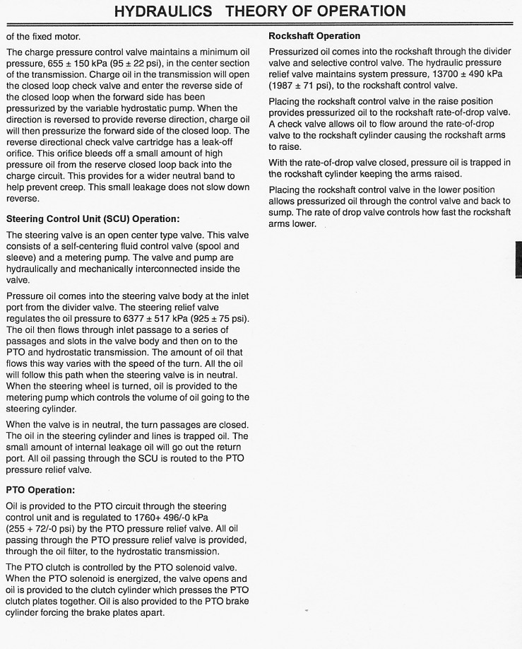

jd110 Im not sure if they have a Dyno or not but I will certainly ask him that on my next trip.
Davkir, would a problem with the PTO brake make the shaft slip like it is also? The Tiller does shut off pretty quick after I disengage the PTO switch but It does seem to spin a little more than it used to with my mowing deck attached.
Also could there be a problem with my Tranny fan thats causing the heat to build and cause the slipping? Ive read that the fans can be a problem on the 2305.
The brake and clutch discs are all part of the same assembly and controlled by the same valve.
The fan could be a problem also. It's easy to check and make sure it is attached to the driveshaft and all of the blades are intact. The transmission housing should be relatively clean also to help cooling.

Thanks for the info Davkir, Im trying to educate myself as much as possible before I get to the dealer for the 3rd time.
Make sure you try to turn the tranny fan by hand. We've seen some case where the fan look fine but the spline were strip and the fan was slipping on the shaft.
