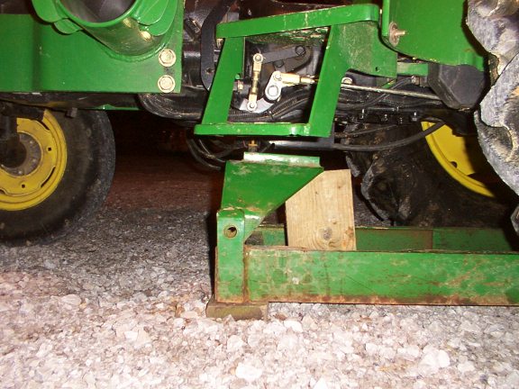

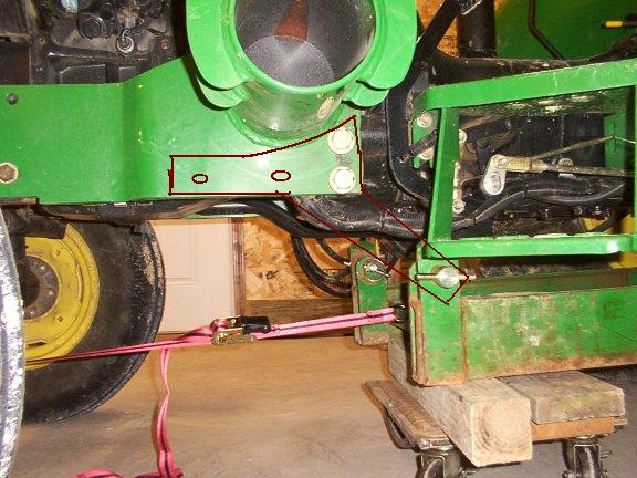

-----QUESTION____I am in the middle of mounting this subframe. Have laid out a outline to put a bracket on each side and add bolts to the loader frame. And with the brackets at an angle i will be able to lay in a piece of flat iron to create a guard protecting the hyd lines , electrical ect that is getting a beating now. This will allow me to get the subframe closer to the tractor. And not have that huge mount hanging there to catch on everything when i remove the hoe. My question is . by doing this I will not comprimise the loader frame ??? will I? Will it be taking the load properly? (2100 series is mounted this way, with the same sub frame). Plus the current bracket which is for the 5000series, makes comes down way to far, causing the subframe to set at an angle, about 5 in lower in the front than what it would be in the back. Currently I am within one inch, front-to-back. in being parallel with the tractor frame.

Thanks for all the input thus far. I am installing all the Hyd upgrades as stated. I will post pics if anyone is interested in the final outcome. I currently have a Hyd question, JD made error on drawings, posted a thread in the Hyd section. Moving Forward......
