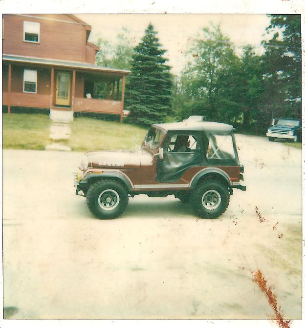

Back in highschool, my first vehicle was a 77 CJ5 w/304 3sp. Ahhhhhh....... the memories ! Mine was actually a salvage vehicle.... hit hard in the rear. I was working at a small body shop, and my boss helped me straighten it out at night and on weekends. The best part of having a 304 in a CJ5 is..... its way too much motor for that vehicle. Fun, fun, fun !! On the local cruising strip, i spanked more than a couple unsuspecting drivers. The only problem i ever recall.... was the distributor. My pop figured out we could replace it with a GM hei distributor by swapping the drive gear on the bottom.... seems they turned in reverse. I suggest you buy it if its in decent shape. They are a boatload of fun.... IF you can keep the front wheels on the ground !
Couple old polaroids is all i have left of her.
P.S. Chicks dig Jeeps !
