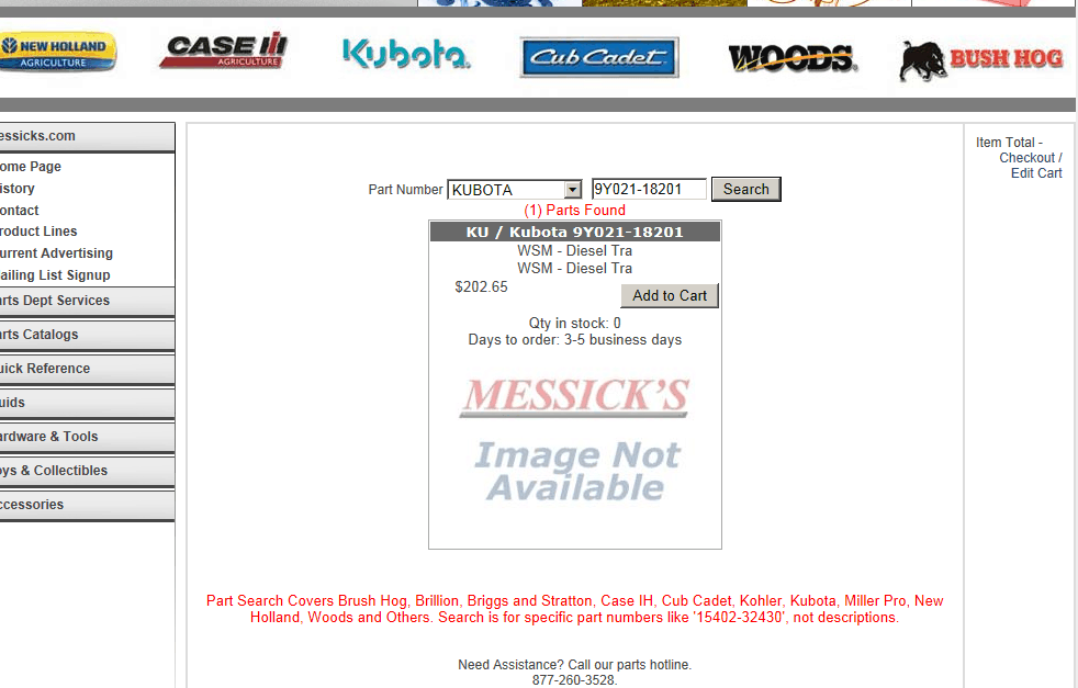

I just went to Kubota Parts and entered 9Y021-18201 in the "Kubota Part Search" field, not the "Commonly used..." field. That one didn't work
Kubota Parts
Here's a screen capture of messicks parts order page for the WSM 9Y021-18201

   / Jerky LSeries 3pt Hitch Fixed #170
Yes. As noted earlier I expect it to ship by Friday! We only need one if it has the info we need.
