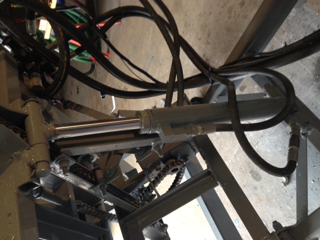

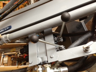

I installed a needle valve at the large diameter end of the ram and a low pressure cartridge in the spool valve.
Result:
Adjusted for 1400 psi and a very slow fill the mast is easily controlled and at low mid rpm the engine/ pump system works hard but does not stall.
A propotional valve would have worked but at a higher cost and more mounting and hoses.
It is ready for a trial run?...??? Still 10 degrees and two feet of snow so it will be a couple of months.

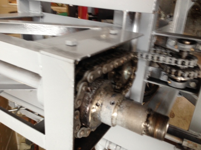

I made my own water swivel and tested it with 100 psi air with no problems. The real test will be pumping well mud through it for hours on end.

As you probably already know grease fittings and lotsa grease!! Did you use packing or o-rings?

Never looked at O-rings but did think of HP srping loaded ceramic seals until I looked at the price:(
I ended up using an HP graphite marine packing material two layers deep with a 1/16" clearance on a 1.5 inch shaft with double bearings and grease fittings to all.
I have it in a flow through not a T shape so the open end of the drill pipe shaft can recieve full flow.
I hope this works????
Gray

Be happy you did not use ceramic, it does not hold up to anything but clean fluids. The rope packing is the way to go. We also have teflon packing here if you want to try that if the graphite does not hold up but it should as long as it is not overtightened. CJ

I may but I think my graphite is on Teflon fiber? Good to know that the ceramic woukd have been a losser! Those seals are super expensive, high speed and would have changed my design.
How tight is tight?

The correct way to adjust packing is to leave it loose the start the unit up and slowly tighten until it just dripps. If you tighten it up too tight till it is dry you will burn it and have to repack the swivel. The slow drip will lubricate and cool the packing. If you grease it frequently it can be reduced to a very slow drip but you have to keep it greased. CJ

I meant that I have a swivel in line above the drill rod power head. It is small for this need--about 1.2 inches in section ID. I am using a 5 HP trash pump for this R&D unit but intend ot use maybe a Flow tec sieries 8 pump with pressurinzed grease seals for mud pumping, up to 45 PSI and 100GPM but likely far less through this system. Also the swivel is home made. I am looking at about 300ft max depth?
