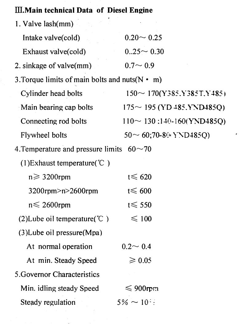

Thanks for the info, Just to let you know I did check the valve lash. Two of the exhaust valves where tight (less than .005) and two of the intakes where loose (.025)
I set them all at .015 (cold)
Is .015 the right amount of lash?

Hey Dan,
After checking the valve lash on my Y380T engine prior, to removing the Rocker Arm Assembly. Mine seemed to be in the 35mm range for the Intakes and 40mm range for the exhaust. So to tell you the truth Dan, I just tried to make the best educated guess, that I could and went with 35mm overnight cold on the intakes, and 40mm overnight cold on the Exhausts.
The valve lash discussion that we had was a pretty long one and involved a lot of learning for me during the discussion.
The discussion was 7 pages long, and I pasted a link to the 6th page, where I finally got around to doing my own engine. Please remember that I am referencing in increments of a Millimeter and others are referenceing valve lash in Increments of the inch
http://nortrac.proboards26.com/index.cgi?board=TY380&action=display&thread=1107491554&page=6
I don't know where the 95 ft/lbs of torque, is coming from for the Headbolts.. But my Engine Operational Manual. Clearly states that on the Y380t engine, the Specified Torque is 150 to 170 N.M. Which is 110 to 125 ft lbs. But my book doesn't list a Y385T, for setting and/or adjusting the valve lash. though

Hi Dan
Sounds like you don't have the Y385 engine manuals. Lots of folks complain about them, but they're better than nothing. One is the O&M, the other parts. See the attachment for a copy of an applicable tech data page. There are folks that will argue with the valve lash numbers, so just take them for what they're worth to you.
The compression release linkage is considered a tractor part, as opposed to an engine part. It's composed of horizontal piece of 3/8" round stock bracketed to the frame that supports the fuel tank, steering column, and instrument panel. It's bent about 70 degrees on the operator end to form a handle, and drilled on the engine end to accept a vertical linkage. The vertical rod linkage then connects to the compression release bracket that protrudes from the valve cover. This would be somewhat difficult to reproduce through a pickup dash and firewall, so a stout throttle cable would probably be easier to convert into a compression release pull. I emphasize stout though, as I'm sure you know how much downforce you need to compress those valve springs.
//greg//
