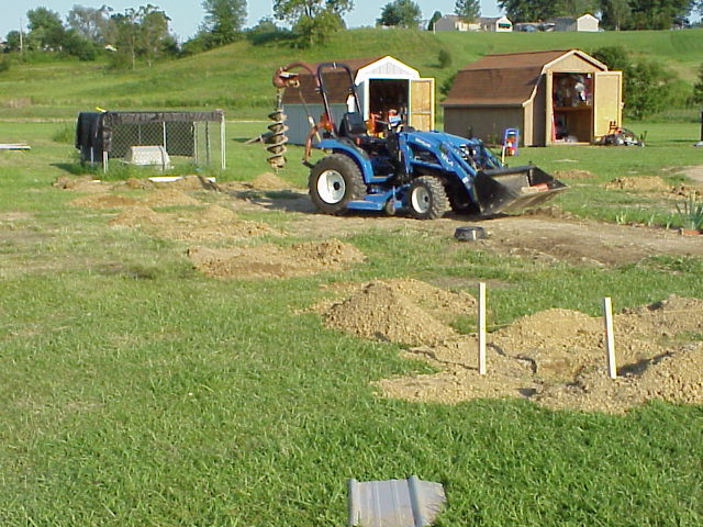

Does this count as an official start? I've got all of the holes dug and gravel put in the bottom of them. The only thing I've done since these pictures was I put some concrete in the bottom of 16 of 24. Will try to get the other 8 done one day this week. I ordered the poles, girders and the trusses on Saturday. Poles should be here this afternoon and the trusses ????. They will come straight from the factory. The salesman was going to try to talk the manager into giving me a Bostich coil roofing nailer. We'll see on that one.

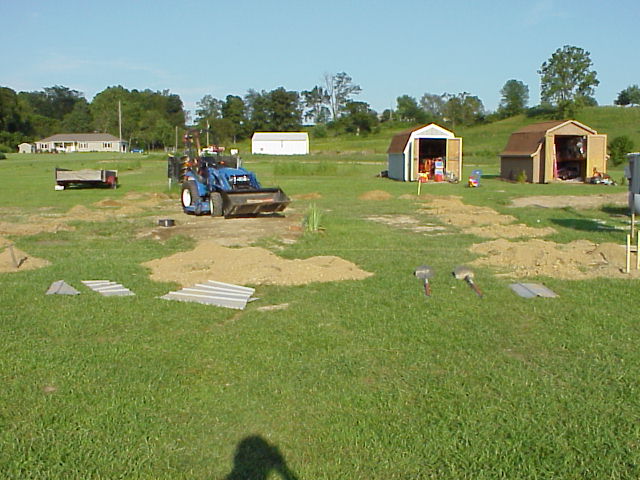

Another shot. A little bit better shot of the tractor and post hole digger. I'd thank the guy that loaned me the post hole digger but I don't know his name. My neighbor borrowed from him for me to use. Neighbor also told me I could use his electronic water level when I start to put up the top girder. I think I've got a pretty good neighbor. /forums/images/graemlins/smile.gif

</font><font color="blue" class="small">( Does this count as an official start? )</font>
Jim, I would say that does count as an official start but I am not sure that it is the best place to start. If at some point you want a cement floor in the pole barn you will have to remove all of that grass and topsoil. Even if you don't plan on having a cement floor right away it would be easiest to remove the grass and topsoil before the poles go up. This is just my opinion so maybe others will jump in here with theirs. I sure do enjoy the pic's so keep them coming.
