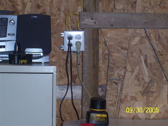

Here you can see the other duplex outlet. Currently that is the radio, battery charger, and the work light plugged into it. I haven't started running the wiring for the lights yet. Most of the lights I've looked at come with a plug. I think I'll just wire outlets into the light switch and plug the lights in. That'll allow some flexibility with moving lights around as needed (hopefully not too much of that, but you never know) and also easier/faster replacement.

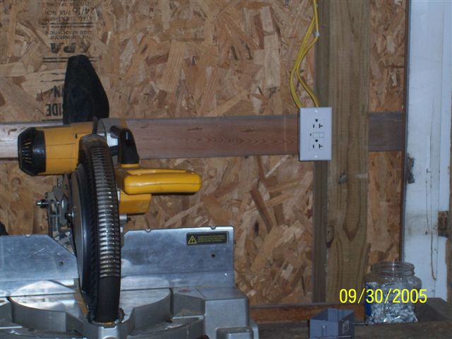

Re: Jim\'s Pole Barn Project - hopefully
Last one for now. The picture of the GFCI outlet that protects the other duplex outlets at the work bench. This is one circuit. A total of 10 outlets, the GFCI, the 2 duplex, and an outlet on the back side of the garage for the dogs (they are really spoiled /forums/images/graemlins/laugh.gif). I've left a little slack in my wires in case (hopefully) I come back and build "walls." This will allow me to unattach the outlets from the pole, put a 2x4 in and then reattach to the 2x4 w/o having to redo the wiring. I did make sure as I was attaching the wire to the pole to keep it back away from where the 2x4s will go.
Just on the right of this pic you can see the door frame that I had for the door to what was going to be my air compressor room. I decided that I wanted the bigger workbench instead. /forums/images/graemlins/smile.gif Now there really isn't a good place for the compressor room. Guess I'll just have to listen to it. /forums/images/graemlins/frown.gif

</font><font color="blue" class="small">( Most of the lights I've looked at come with a plug. I think I'll just wire outlets into the light switch and plug the lights in. That'll allow some flexibility with moving lights around as needed (hopefully not too much of that, but you never know) and also easier/faster replacement. )</font>
Jim, that's what I did too. Maybe down the road I'll stumble onto a great deal for some nice commercial hardwire fixtures but until then, I need light now and the cheapie plugins do fine. I wired one circuit to feed three ceiling duplex receptacles which in turn powers two rows of (3) 4' strips in the rear shop area. The other circuit feeds two ceiling duplex' and (4) 4' strips over the car bay area. Think I paid less than $6 ea. for the double bulb strips w/ fast start cold weather electronic ballasts. Even caught a sale on a case of T8 bulbs for 1/2 price. Don't think I have $75 bucks invested in everything. /forums/images/graemlins/smile.gif Heck, I just realized ONE outdoor carraige fixture cost more than ALL of my interior lighting combined! /forums/images/graemlins/blush.gif

Jim,
They cost me $48 per fixture but I have all the light I will ever need in my pole barn for most of the things I do. I installed 8 dual tube florescent lights with reflectors, wired to four switches, two fixtures per switch. I bought them from a local electric supply company and found them the most reasonably priced of anyone in my area. The lights probably won't light in real cold weather but I keep my pole barn heated in the cold season so they should be okay. The ballast hum bugs me once in a while.
I do use tungsten lights on my mill, drill presses and metal lathe when I do critical work because the overhead lights aren't quite enough.
Farwell
