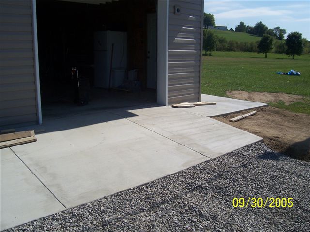

We had just over 14 1/2 ton of limestone brought in. It made for a pretty decent approach. He did a great job of tailgating in. Left me a little pile by the apron that I was able to rake by hand / push with the tractor right up against the cement. I think it then took me maybe 10 minutes with the loader and roller to level and pack. I told him we would drive on it for a month or so and then I would have him bring another load in to fix any spots that settle and redress the entire driveway. One thing that has come up, he was trying to stay relatively close to the existing drive. This ended up causing the new approach to curve a little bit too much. You have to make sure when you are backing out to immediately start cutting the wills to the right or you will "fall" off the edge of gravel. One of the plans is to put landscaping timbers or whatever I come with to keep the gravel and grass apart.

Another shot of the apron and gravel. Along with some of the 2x4s left from various activities. /forums/images/graemlins/grin.gif

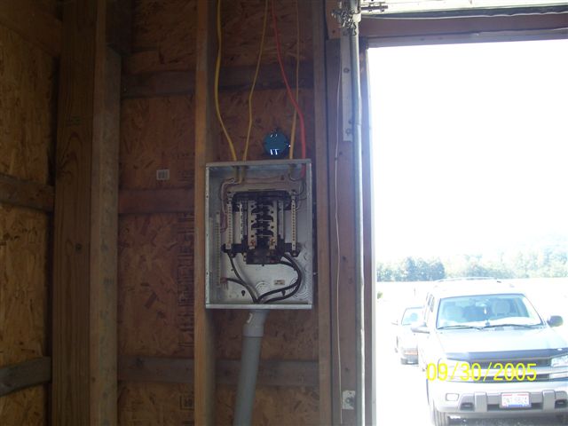

#356
Re: Jim\'s Pole Barn Project - hopefully
Here is a shot of the circuit box. When I put the conduit in, I missed where the box ended up being. /forums/images/graemlins/blush.gif /forums/images/graemlins/frown.gif /forums/images/graemlins/mad.gif I bent the pipe/conduit as much as I could and then I put in a meter offset to get those last couple of inches. I really don't think it'll cause any problems. Guess I'll find out when Jerry (Inspector507) comes down to "Inspect." /forums/images/graemlins/grin.gif

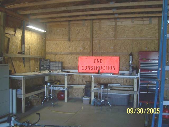

#357
Here is a picture of the work bench that I made last weekend. The side by the light (which by the way is the only working light in the whole place other then that garage door openers) is 8' the other side is 12'. I'll eventually take some of that OSB standing in the corner and make a shelf for the bottom. But for right now I need a place to work and to get the countertop out of the way. I bought the countertop for $5. It is warped a little bit, but I was able to pull most of the warp out. Makes it real easy to clean up vs. plywood or something similar.

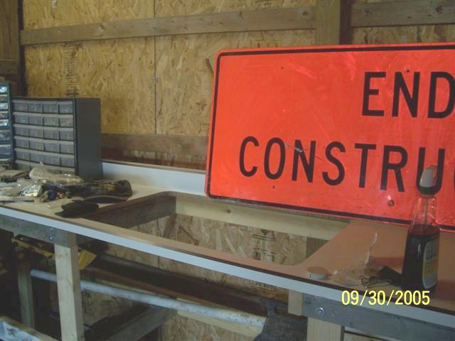

#358
Here is a closer view of the long side. You can see it has a cut out for a sink. I'll eventually add that as well. Glad I thought ahead and put some extra drains in along the other 2 solid walls. You can also see the motto of the garage.

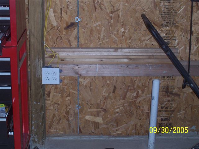

Here is the drain pipe the sink will run to. Also you can see one of my duplex outlets for the work bench. Once I build the interior walls, I'll put more outlets above the work bench. For now though I just added a duplex at each end. The only poles above the work bench are the corner post (I can't reach it) and above the sink - didn't think that would be a good idea even with GFCI.
