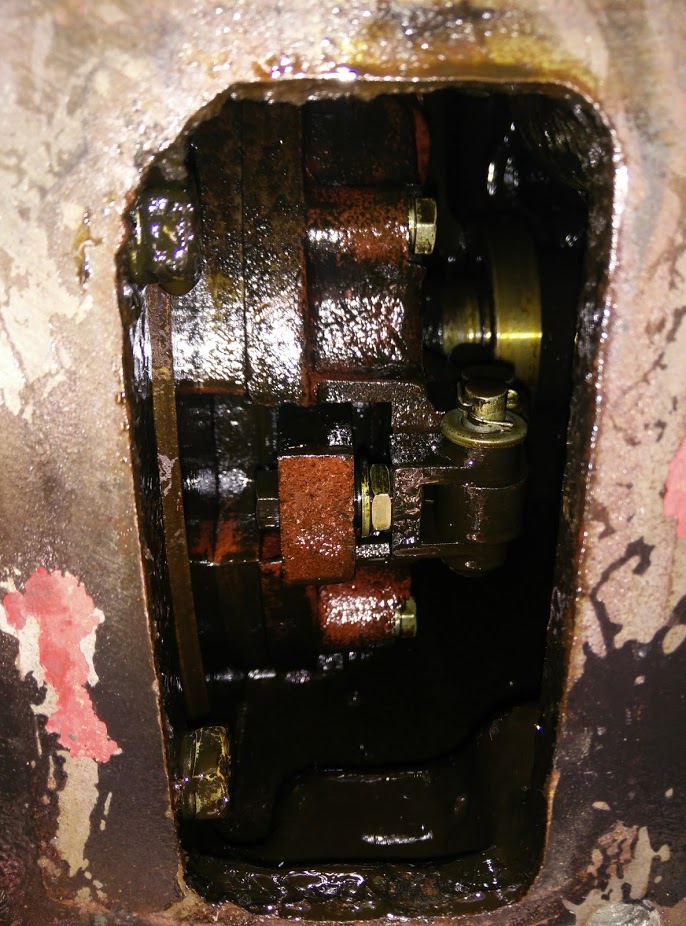

Popped off my loader on the jinma 224 the other day (that was an ordeal... those kickstands dont work for crap) to finally adjust the clutch that had been slipping under load.
Found not only a poorly adjusted clutch... but two quarts of oil sitting in the bottom of the bell housing, nicely splash lubricating the whole clutch pack. Not great, im kind of amazed it moved at all with that much slip and slide oil in the bell housing
So, looks like im splitting the thing. Figure i might as well get some other stuff done if im going to split it.

Well now you get a chance to put it to work!
The bolts that are most likely to cause a leak are the ones that hold the bell housing to the engine block. The bolts tend to stretch and the gasket between the engine block and the bell housing leaks. To get to them you have to take the flywheel off. So I don't think you're going to be able to stop the leak without splitting.
