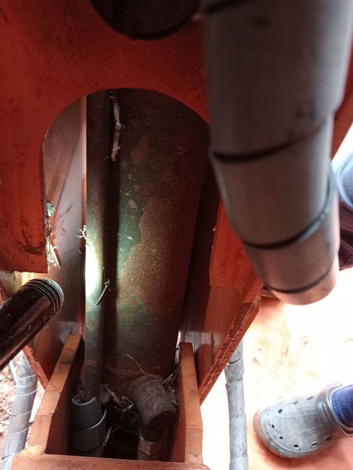

Can anyone who owns a jinma backhoe tell me if there are grease nipples on the pins at the ram ends that move the boom left and right. The photo might help show where they are. I cannot see any grease nipples or threads of missing ones. This is odd because there are no shortage of grease nipples on the backhoe.

Woops. Accidently posted the wrong photo. The 2nd? photo with the torchlight is the one i meant to post.

As far as greasing the swing pins, it has been a long time since I used the backhoe but this triggered a memory that there are no grease points there. The reason I remember is that it is something that should be greased just like the rest of the machine. I think the swing cylinder mounting ears have the same problem. I usually try to give them a squirt of oil or spray some kind of lube in there when I mount the hoe to the tractor. It is about the best you can do without pulling the pins and drill and tap for grease ports. Doing that to the mounting ears would be more difficult.
