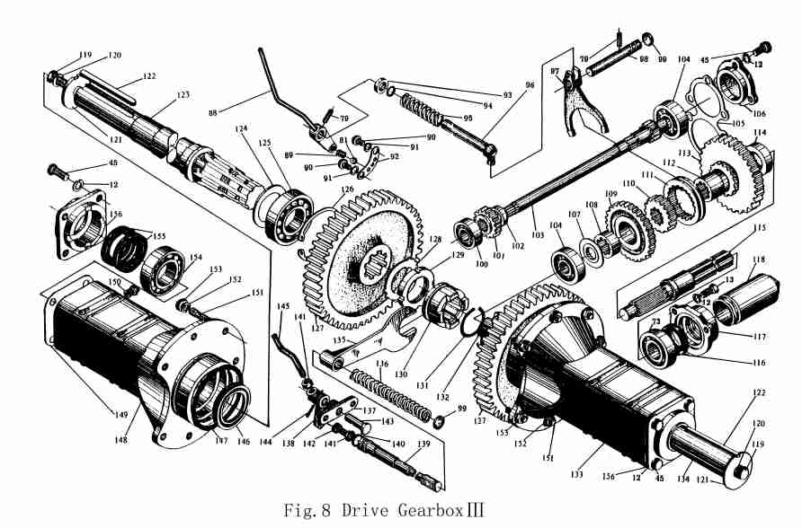

For a reference, I ve attached an exploded view.

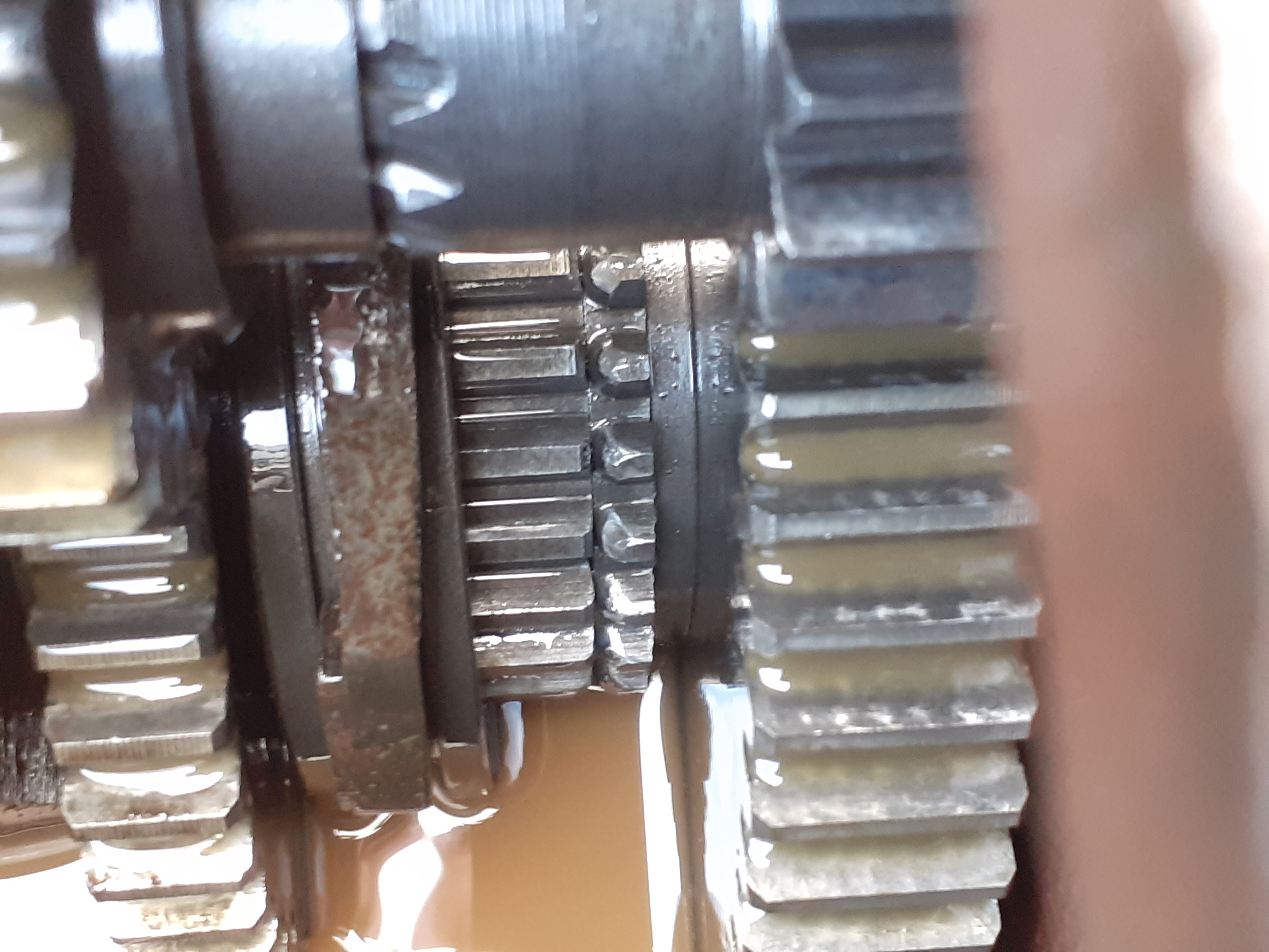

have found out the teeth on the 50T gear are worn, and presume the teeth on the slider are worn as well.20200725_160331.jpg
   / Jinma 254 pto engagement #6
Are they so worn that it's a problem? Doesn't seem to bad on the picture.
   / Jinma 254 pto engagement #8
When you engage the 540, does the slider engage fully with the narrow teeth? It almost looks that the slider is not moving the full travel and its barely engaging the narrow teeth.
Right now it's on 1000 RPM for the picture, right? So we can the see the shape on the teeth for the 540. The 1000 does seem to engage fully.
   / Jinma 254 pto engagement #9
The teeth look about normal for a synchronizer used in a manual transmission. Tapered on the slider side to aid during engagement. Your gear looks about the same of the picture of a new one I found online. 184.37.457 (5 T Gear for Rear Axle) | Jinma Tractor Parts, Farm Pro Tractor Parts | Circle G Tractor Parts
See if you can get a good look at the inside of the slider with a mirror or something. Also, check for full travel and engagement with the 50 tooth gear. Something doesn't seem quite right here....
   / Jinma 254 pto engagement #10
One other thing, it may just be the lighting but the oil seems kind of milky looking, which might indicate moisture in the oil.
