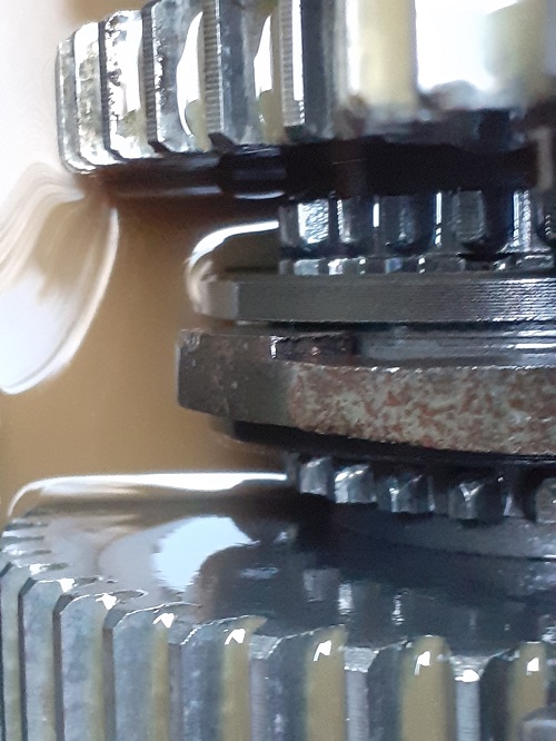

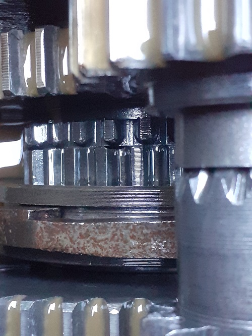

The other pto gear for comparison. The slider moves to the full range, but when selecting 540, the shaft can still be moved whilst the slider is part way along the gears. on the 1000 gear as soon as the slider moves over the gap between the gears, the gears mesh.
Yep, the oil has had a bit of moisture in.

Well there is definitely more wear on the 540 side. It will be interesting to see what the inside of the slider looks like. If you decide to replace the 540 gear it might be a good idea to at least order the slider so you have a new one for comparison. Associated thought, I wonder if you could "flip" the slider so the other side engages?
Let us know how it goes it is good information for future users.

Have orders both. Will see how far the excess wear on the slider is.

From what I gather from the pictures, my best guess is that the slider wasn't engaging fully on the 540 side and started wearing out the tip of the teeth on both the gear and the slider. Now it just pops out of gear.

Yep, ptsg, think that's what was happening.
