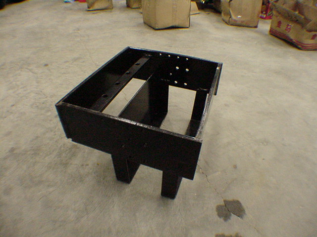

That is the battery box I have on my 2003 Jinma 254.

The LE style battery box mounts low below the radiator, you may want to take a look at it,it will bolt on you will still have to make a few modifications depending on your hood,here is a pic. I'm currently out but have more due in about 2-3 weeks

Thanks for the pic. I think I could cut and weld in some pieces on my current weight bracket to resemble that...which is what I had in mind to start with. I like to fabricate and am often accused of being "frugal" so I will probably modify mine instead of buying a new one. I did throw you some business yesterday though. My tach had quit working and I did a search here on the site and got an idea of what I was dealing with. Upon investigation, I found that the censor had a wire that broke inside the resin that holds the magnet and wires. I talked to Jerry ( I think) and ordered a new one from you guys at what I felt was a very reasonable price.

After seeing what Tommy posted, no need for my pix. Just like that. I have a loader so no weights and bracket to deal with. Bolted right to the frame. Upgraded the battery to a 925 cca at the same time. Last winter she never started so easy.

I tested the thermostat and it popped right around 180F so it was OK. Took the radiator out for a thorough washing again and put it back in. Still ran hot. It was about 90 degrees outside again today and as long as I kept the revs about 1500/or not much of a continuous load it would stay around 80+C but more revs or load would take the temp up towards 100C pretty quick, same as before but worth trying.
I started the tractor then took the huge battery that was in it out and hooked up a small 12V battery from an ATV to operate the gauges and found I could mow very heavy stuff at near full throttle and not get over approximately 85C. So I decided to relocate the battery by modifying the front weight bracket, that way there will be no obstruction whatsoever in front of the radiator. I took the new battery out of my Mitsubishi and it was a perfect fit without having to widen the front bracket. Some 2" angle iron and a couple pieces of 1/8" sheet metal, a little cutting,welding and paint and voila, battery relocation completed. Turned out pretty good if I do say so myself. It has currently left me w/o front weights but I am going to take care of that part of the fabrication tomorrow. I feel the problem is solved and can now sell the tractor in good conscience. I really do hate to get rid of this machine but can't justify two tractors. I think I can pay for a new 16" trailer with the profit, and that's something I've needed desperately for a long time.
