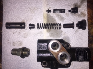

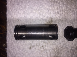

My day job and the rain kept me from this project. I took the diverter valve apart today. The pictures show what is inside. There were chunks of rubber seal in the inlet side on the end of the piston. The piston pushed out with little effort although it is a very tight fit. The piston has signs of wear but it is immeasurable with my calipers.View attachment 515515
The piston is 20mm diameter with 3 Oring grooves. They are 1mm wide with a bottom diameter of 18.9mm. There were no O rings present. I assume there should be rings and that the chunky bits of pump seals went through the system and tore them out of there to be relocated somewhere further downstream (in the steering box, the steering cylinder, the 3pt cylinder or the sump). The only thing I could get locally were 18mm X 16mm X 1mm O rings. They are actually 0.75mm thick and 0.95 mm wide. So, they fit in the grooves but 18.9mm + 0.75mm + 0.75mm = 20.4mm. There is no way I could get the piston back in the bore. I suppose I need 20mmX19mmX1mm rings?
I had to cut them to get back off. The piston will not go back in the bore without them! WTF? I'm stumped. I took it out with little effort but there is no way that will push back in.

You don't use O-rings on hydraulic spool valves. The grooves you see on the spool are to soften the inrush of oil when the port opens. It provides for a feathering effect and also lubricates the valve body. And btw, the spools are a lap fit to the body - no seals needed except for dust and dirt, and those are wipers.

I'm losing confidence in the hydraulic shop that treats me like an idiot when I ask them questions and try to spend my money there. I had taken it to my local hydraulic shop and placed the piston and body on the counter and it was their 'expert' that sold me O rings. After two hours of searching the net for O rings sized so that they could possibly work, I concluded there was never any rings on that part. I came back here and you had already told me that.
I bought a set of snap ring pliers and removed the C-clip from the inlet end of the block. The piston went in no problem. Put it back together and problem solved. Lots of power in the power steering. Just debris in the valve I guess.
So, for future researchers, there are no rubber seals or Orings anywhere inside there. Even the pressure relief is a metal on metal seal.
