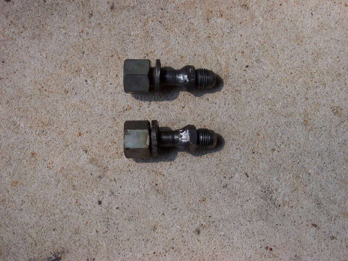

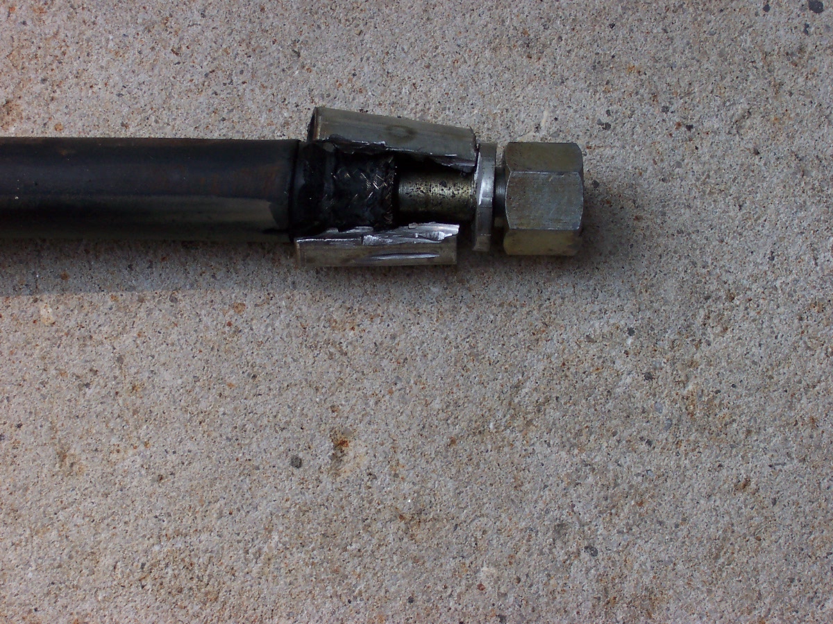

I made my own adapters a couple years ago to JIC. If you look at the hose pic you can see why they come apart. The hose was only inserted half way.
