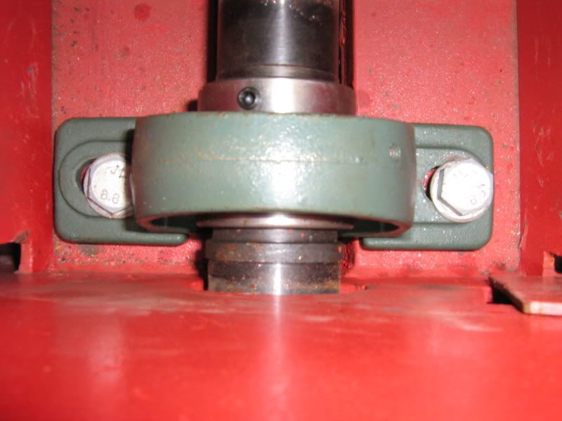

I just got my Jinma and have been going over it.....
I had read about the poor grease nipples. Of the 6 pillow blocks there were only 2 in place. they fell out in my fingers before I figured out what size of wrench might be needed. Oh well 6 6mm zerks @ .65. Not bad.
Mine was missing lock washers for the 3Pt pins. good thing I had some spares.
Now for the real question about the flywheel and shaft postion in the bearing.
It looks like the shaft needs to go further towards the tractor. Can anyone confirm that this is in a bad position or good?

/ Jinma chipper problem/question #23
Yes, that raised portion of the shaft, needs to sit against the pillow block bearing.
I'll 2nd that the shaft needs to go further towards the tractor. Mine looked just like yours and caused clearance problems between the blades and the housing.

The best I can tell from the pic is that the shaft placement in not correct.
If that is true ??........ the drive belts could be out of alignment or they will be when you correct the shaft placement. Which then means to will have to loosen and adjust the drive pulley or pulley's.

Thanks for all the help. It turns out that most of the 'slack' was in the pillow block mounting. One of the bolts on the pillow block by the flywheel was not tight and the block was such that you couldn't get any kind of wrench on it. I loosened all the shaft set screws then positioned the pillow blocks and the flywheel so the blades were parallel to the anvil and the shoulder was against the bearing. When all was tightened up (with locktite on the setscrews) I had about 0.040 clearance on the blades.
Now to take it up to the tractor this weekend and hope the PTO shaft fits....
