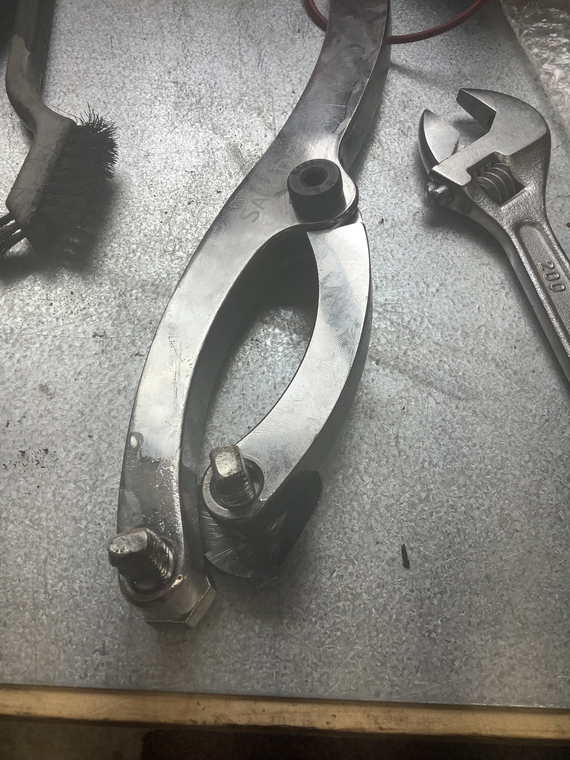

OK, finally got them turning and one completely off. Used my original setup of a pin type gland wrench modified into two slotted bolts also held in by my welding vice grips and a 4’ pipe. The stick one was the most difficult. Now I have to I’d all the parts I’ll need for the rebuild.

Glad it worked, when I looked at your set up, thought you had your spanner set up for tightening. In the mills we always put the swing arm under tension, not compression. That type of nut would take a spanner with a swing arm that would look similar to a puller arm. It would grip tighter with more force. Not easy as easy to find as a drift. So I removed many that way when a machine was down.

I find that loosening the gland before removing the cylinder is good if possible. Tapping on the barrel where the threads are with brass hammer can help too. Sometimes I have resorted to heat on older machines. I have rebuilt dozens on the machine, most of the time the barrel doesn’t need work.

Once you’re confident there’s no locking screw then a longer cheater pipe is probably the answer. You could try having an assistant hammer against that notch with a chisel while you turn the wrench.

I’ve been trying to remove the gland nut off my 2005 Jinma 354 backhoe which is a LW8. Haven’t had much success yet so I’m hoping someone can point me in the right direction. I did buy a gland nut wrench but the inserts are for a pin type and I wasn’t able to find a Jinma style one. I did modify two bolts to fit the Jinma openings and also used a large welding vice grip to keep the modified nuts in place. Added a 4’ bar to increase the force but no joy.
I have a number of similar nuts to remove for the seal replacements on the backhoe so need to get this done.
Thanks for any help. Kind of a newby on hydraulics.
Don B
