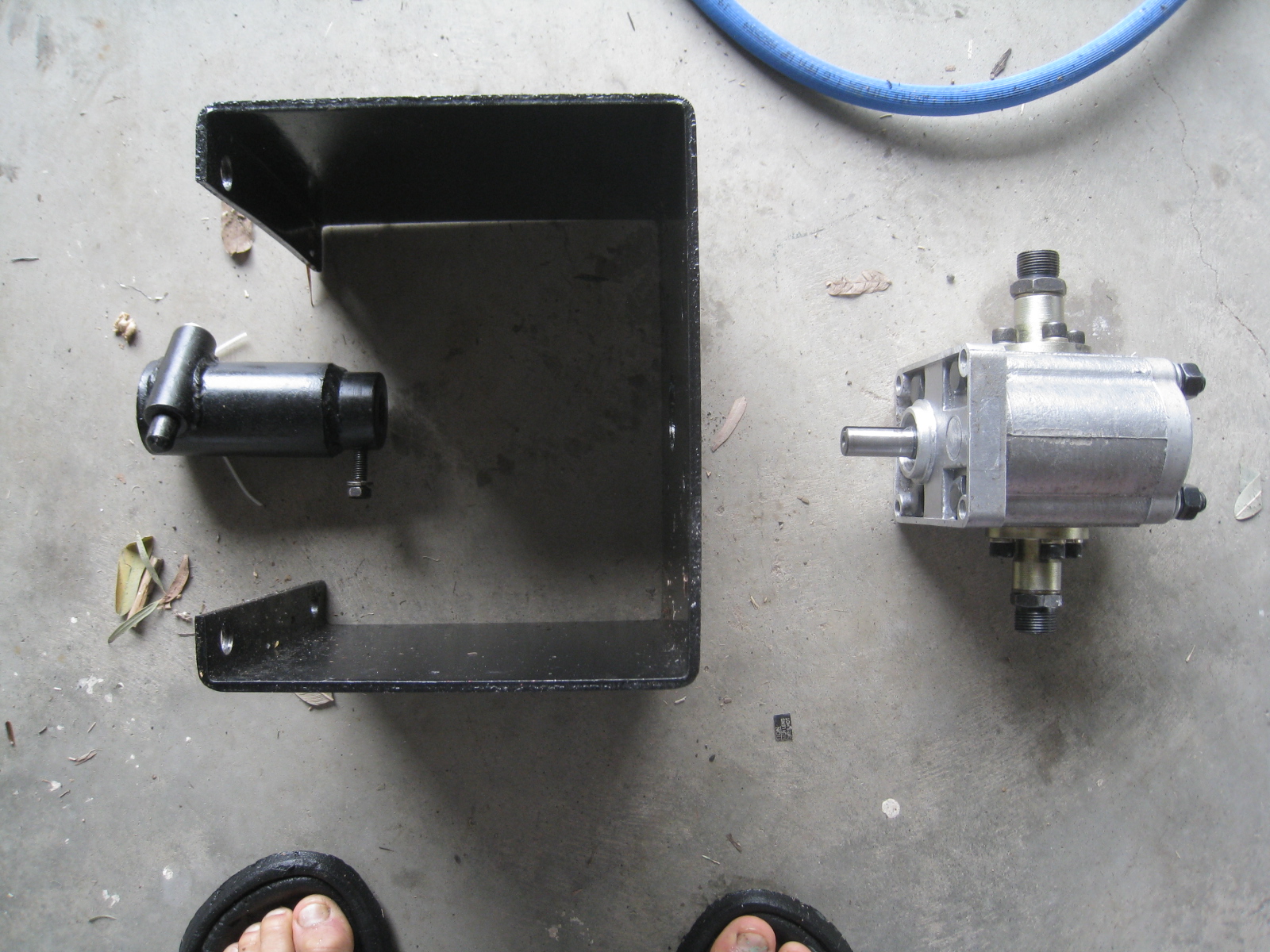

Thanks Ron for the reply but I must admit that I'm getting confused, the pump that was supplied with the backhoe simply fits onto the PTO shaft at the back of the tractor, The four bolts and that bracket is simply to stop it from moving and twsiting with the PTO shaft. This shaft that I connect the backhoe's pump to is not ahead of the gear box becasue I can disengage it and change its speed from 540/750. It's the same shaft that I connect every thing to - flail mower slasher etc. There isn't two shafts , just the single one at the back of the tractor. Am I missing something?
I was under the understanding that the PTO shaft will acheive the speeds of 540 or 750 at a given RPM, I just checked my manual and it's 2200rpm on the JM354.
So that means that the pump from the backhoe that fits on the PTO shaft is supposed to be spinning at 2000rpm to acheive 16mpa, which means that currently It's jsut not spinning fast enough becasue at most I am giving it 750+rpm.

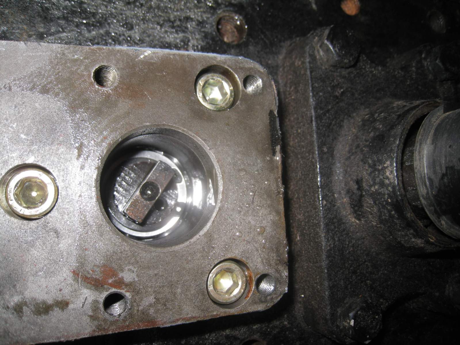

I think you guys have solved it for me. I took off the four bolts of the cover above the pto shaft and saw a splined female shaft with many splines. I then rand the PTO and noticed that it spun faster than the lower PTO shaft. This must be what you guys are talking about, that the pump should have been connected to this all along. However i've been trying to get it going with the lower PTo shaft because when it was sent from the factory the pump was mounted onto a bracket that slotted over the bottom shaft. I jsut assumed that that was the correct match. The company I got the backhoe off was not Jinma but another mob that makes loaders, the also modify backhoes etc. So really, it was the factory's mistake to even make that bracket that fitted over the lower PTO shaft and matching it with an incorrect pump.
I'll now be fabricating something to fit over that tang on that upper shaft and modifying the pump shaft to fit.

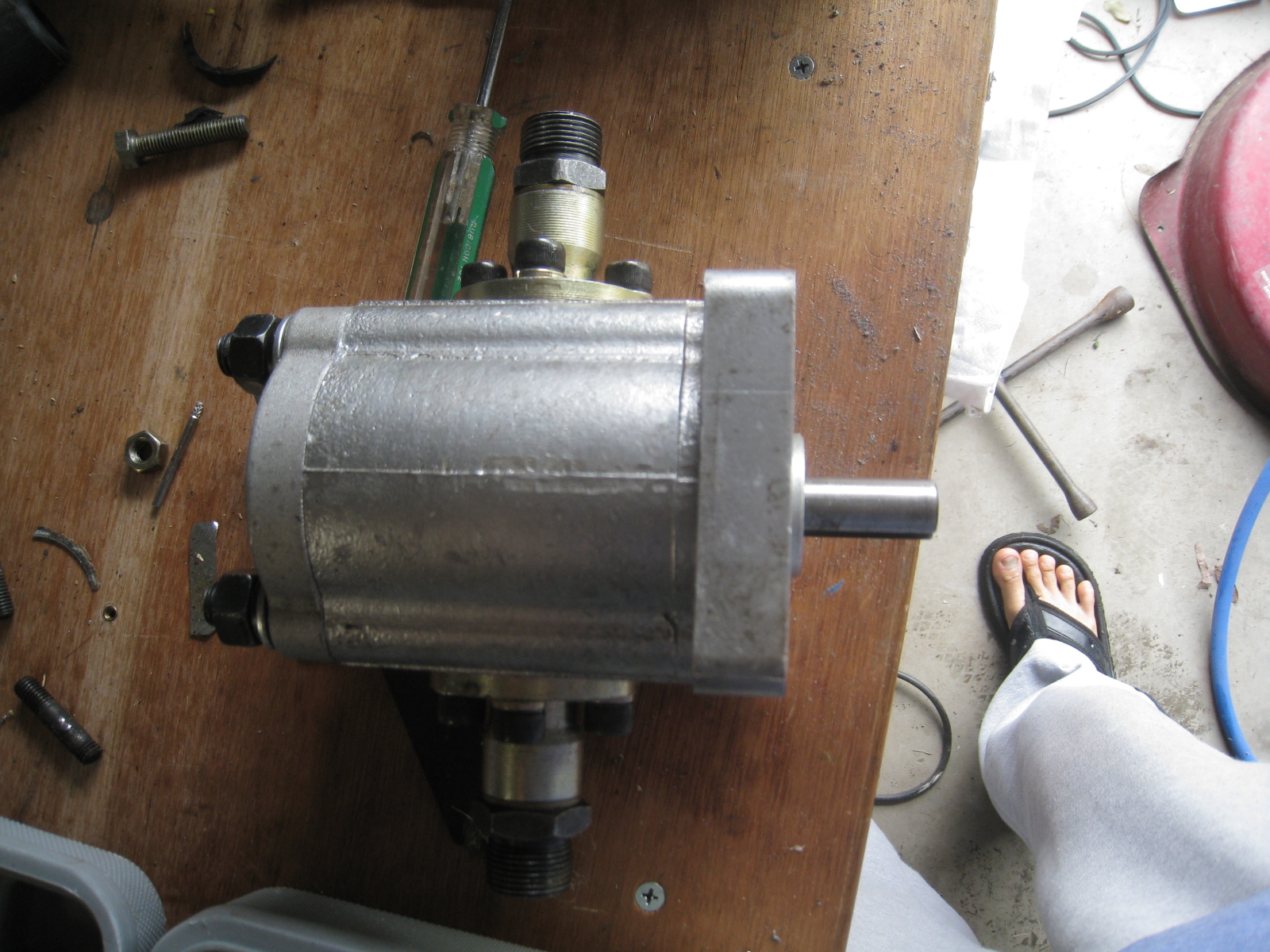

If i understand it right, you have a Pump without Gearbox and with a Shaft that doesn't fit to the Shaft behind the Plate above the 6 splined PTO Shaft.
maybe it will help if you show some pictures of the Pump Shaft and the Shaft inside the Transmission Box.
My BH have an PTO Pump like this one
with an heavy weight cast iron Gearbox.
The Pump have an tang style drive shaft so that i can remove it from the Gearbox and install it to the Backside of the Tractor when i remove the plate above the PTO Shaft.
Your Pump Shaft must look like the right one in the following picture
if not, than i am sure they have send you the wrong Pump but if yes, they must fit without any modifications.
i am not sure but i think, the LW Series have an PTO Pump with Gearbox and the Pump without Gearbox that must be mounted fix to the Tractor is only for the Framemounted HW-03 Series Bachkoe.

here are some pics of the pump. It's definitely the wrong thype of pump to fit on the 6 splined PTO shaft.
