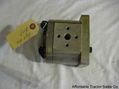

in the first of your pictures, for what is this balck piece for?
it looks like an adapter for the PTO 6Spline PTO shaft.
if you can slip the Pump Shaft into this piece and on the other side you have the the Female for the PTO Shaft?
if it is so, i am sure that this Metal Brace is for the Pump and you must run the Pump with the higher 1000rpm PTO Gear because there is no Gearbox to increase the 540 rpm.
   / Jinma LW-6 #52
Doing that is still going to result in low flow and pressure as that pump is designed to operate at about twice that RPM to develop full pressure and volume. You'd need either a gearbox to up the PTO rpm to around 2000 for the pump or you need to get the proper pump, I'm afraid. I don't see any other alternatives.
Rich
   / Jinma LW-6 #53
if i am not wrong, the Standart setup from factory for the LW-6 is a CBN-E310 Pump that have a lot less Flowrate running with Gearbox on 540 rpm at the PTO than the CBN-E 325 driven direct by the 1000 PTO.
it don't hurts to try this setup if all the parts will fit together like i am thinking and by The way, the Pump don't need 2000 rpm to develop the full pressure but yes the full capacity of volume and this may be with a 25ccm Pump more than enough at 2000rpm and at half speed more than the 10ccm Pump will develop at full speed.
   / Jinma LW-6
#54
Ok I'll try to explain. Basically the setup you see has come from the factory that makes the loaders and backhoe. It's all set up to go on to the 6 splined pto shaft. However, becasue of the type of the pump, it's more suited to the faster spinning shaft above the 6 splined PT) shaft, This other shaft is the
3rd picture in my last post.
Spinning this pump on the 6 splined pto shaft can only get me 750rpm at 2200engine rpms, this is not enough to get the pressure. My options are 540/750 for my pto.
SO, what I'm going to do is to modify the pump shaft to fit over the tang on that upper pto shaft which seems to be spinning at engine RPMS, thus I can run the engine at 1500rpm + and get a decent pressure out of the pump, given that it has a nominal 2000rpm, I think 1500 engine rpms should be ok.
so In essence, the factory should have put a gearbox on that black brackt to step up the speed, or givien me somer kinf of adapter to hook up to the shaft above the 6 splined PTO. Or a pump that could generate such pressures with 540/750 PTO rpms.
are you sure? the pressure is not a question of enough rev.
the Pump develop 160 Bar in any RPM range provided that your Tractor have enough Power on the PTO to handle the 25ccm Pump. the only that may vary is the L/min or let me say the Gpm at different rev.
like i say before, the Pressure that the Pump develope will be the same, it does't matter if you run the Pump at 2000, 1500 or at 540/720 rpm
what you need is Flow and this will be with the 25ccm Pump at 2000rpm round about 50 L/min, at 1500 rpm 37,5 L/min, at 720 rpm 18 L/min and at 540 rpm 13,5 L/min.
it means, that the 325 Pump have nearly the same Flowrate directly driven by the PTO at 720rpm like the Standart Factory Setup with 310 Pump and 3,8:1 Gear Ratio Gearbox at the 540 rpm PTO.
it means also that you need to run the engine at the same (in your case 2200 rpm) speed to get the same or nearly the same output with booth Setups.
If you try to run the Pump directly driven by the inner PTO (in your third Picture) that seems to spin at the same speed as the Engine don't forget that you need about 14,8 Kw or it will be 19,68 HP of your Engine Power to drive the Pump with the nominal specification and at 1500 rpm about 11,11 KW or 14,9 HP.
Don't know if your Tractor can handle this without Gear reduction.
i will not smash down your ideas, these are only the things that come to my mind and advices i will give you.

Thanks Nuno but I don't quite understand how you got those calculations. It seems to me that that innershaft above the 6 splined PTO is meant for hydraulic pumps as shown in Tommy's picture with that coupling. That's what I am going to try to make.
If you read the earlier posts, you'll see that I dead headed the pump running it off the 6 splined PTO and the most pressure I could get out of it was 1500psi. The pump didn't break the engine did not struggle and when I lowered revs the pressure dropped accordingly, there's enough space in the pump gears to relieve pressure once it stops turning, and even when it is turning there is some loss of pressure within the tolerances of the bore and gears. Dead heading it at 750 PTO rpm could only get 1500psi, but i'm sure that If I could increase the rpm the pressure would reach in the vicinity of 2200psi which is what I need. This is why i 'll be attempting to fabricate that coupling to atach to the pump.

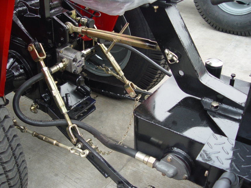

Just found this picture, this is the setup I am going for, though now I'm realising that the pump that came with most LW6s are E10, rather that the CBN-E3 pump I have with a really long shaft. If all else fails, them I'm going to plumb the backhoe into the tractors hydraulics, what do you all reckon about that? good or bad idea?

Does this mean that the pump that you showed back in post 20 does not simply bolt onto the spot where you removed the plate?
RonJ
Correct Ron, it's a bigger bracket that also uses 4 bolts to with the 6 splined lower PTO shaft as centre.
