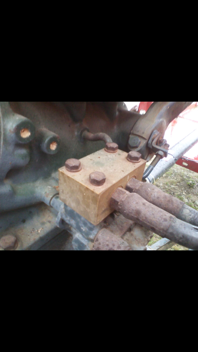

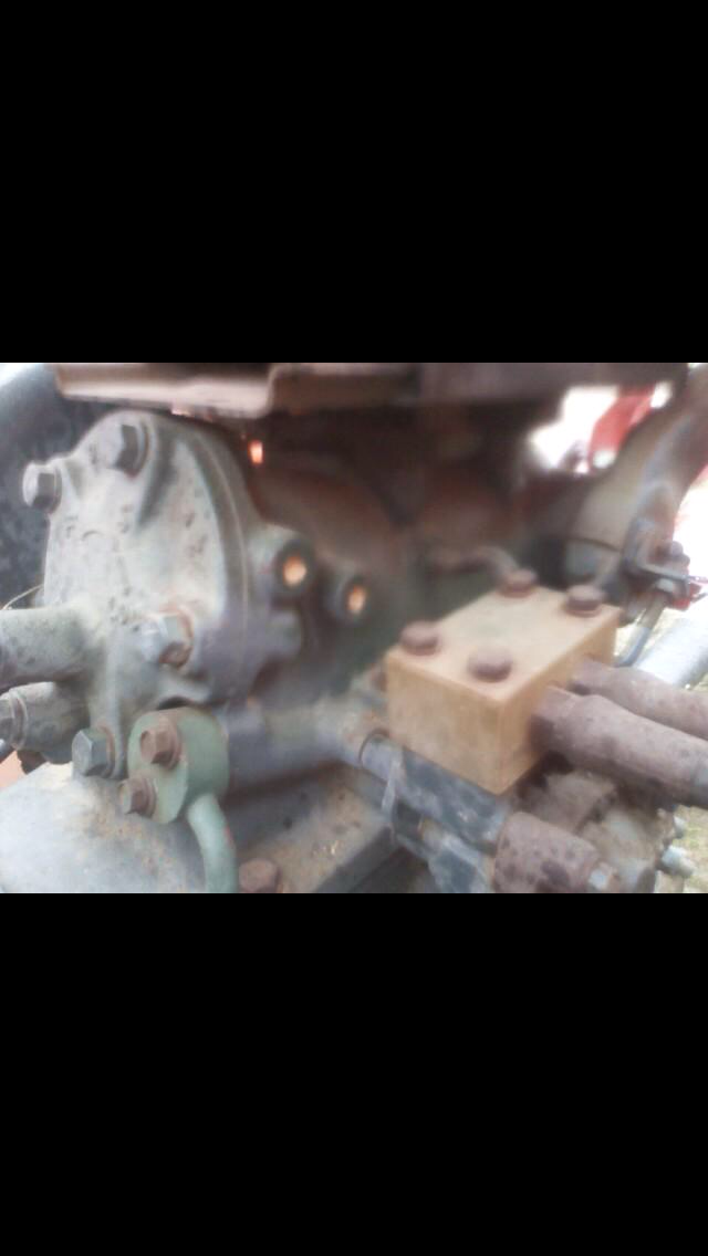

JJ:
Kubota L345DT
The former owner had a log splitter hooked up to the tractor.
The two ports in pic is what he used, to splitter & back.
Now the two are connected together with a hose & QC for a continuous flow.
I want a rear remote, If I'm right I should be able to run 1 hose to the In port
of a valve, & run from out port back to this block, am I right ?
If not please enlighten me.
Thanks
/ JJ where R U #3
If that hyd blk is a PB block, you can use a remote valve with PB adapter and connect the supply flow to the IN port of the remote valve.
Connect the PB out with adapter to the other port for series flow path.
Connect tank line to tank.
