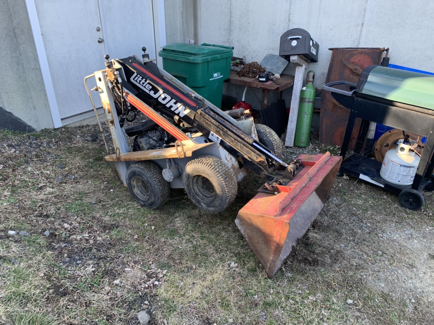

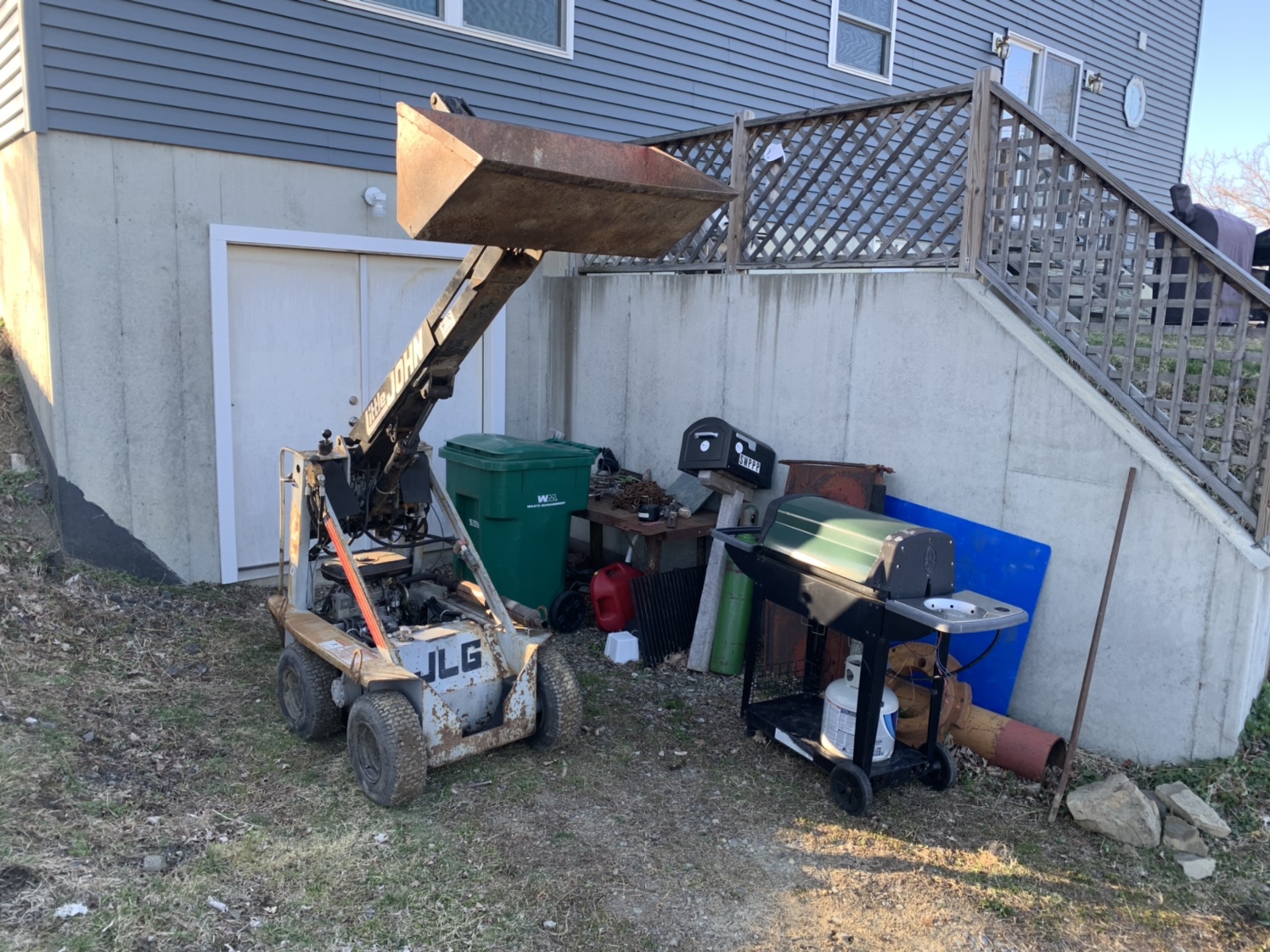

Got it going yesterday. Put the carb back together and bolted it on, put the new (used, but good) gas tank on, put some fuel in it. Took the battery off trickle charge (it was dead), bolted it in and bumped the key. It came puttering to life.
First impressions- I wish it moved a bit quicker. Not zero-turn fast but maybe a bit less than half as fast would be nice. It’s quite slow. The hydraulics are pretty slow too. I’m going to change out the hydraulic oil with the proper stuff (SAE 30wt) and see if that helps. I’d imagine it should help the loader move a bit faster.
Otherwise, it runs very well. If I can’t speed it up I will probably not use it as much as originally anticipated. I’ve got 4.5 acres and it takes forever to get around. Maybe a bigger pump would help, not sure.
Anyway, pics:

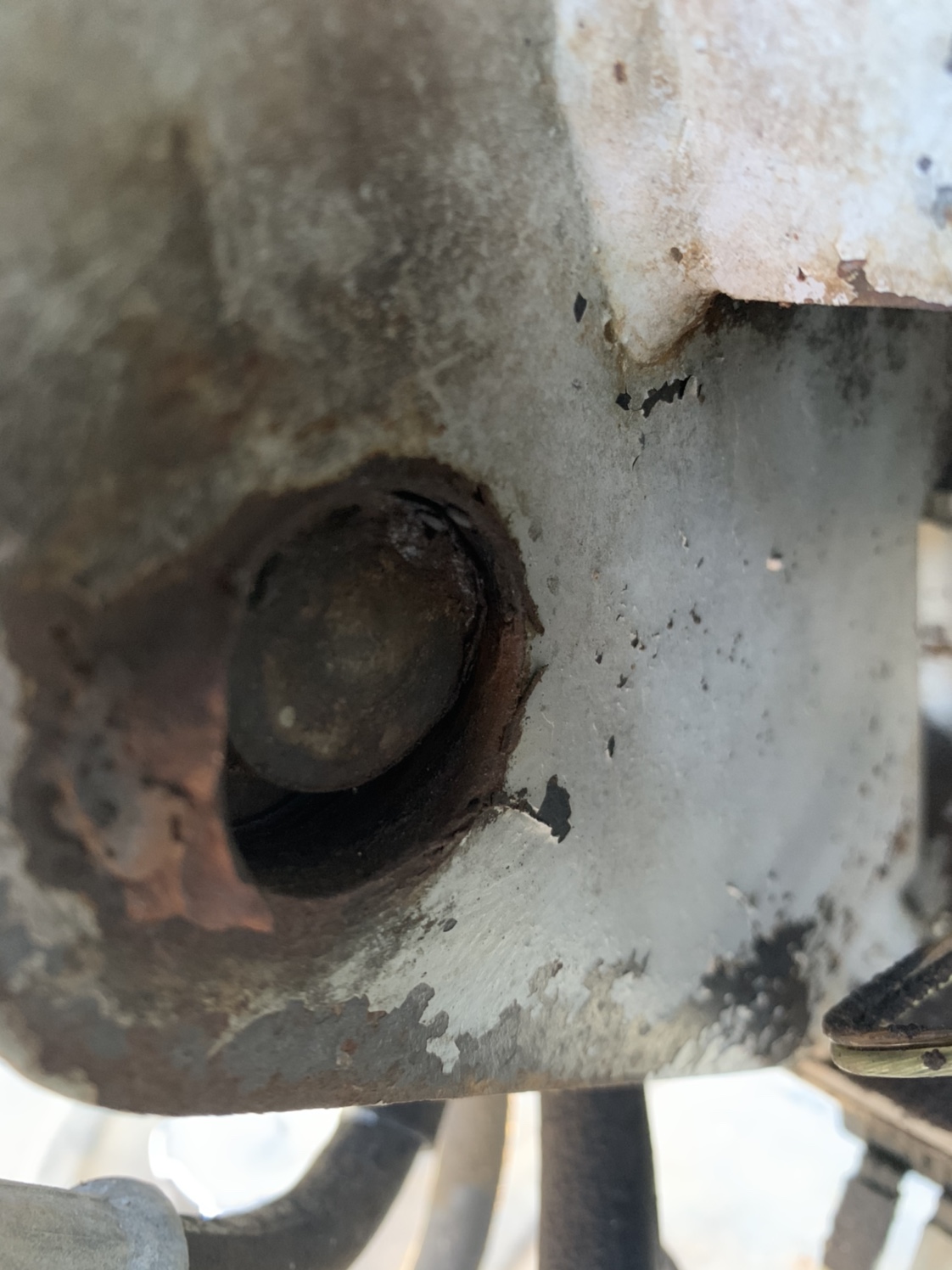

Also found this loader pin is in need of repair. Yikes!

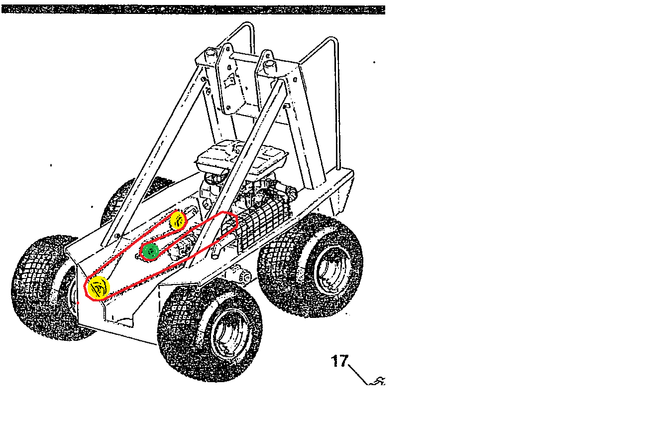

Ok, It's been a bit. Slight update, kinda. I've used the LJ500 a bit. I definitely need to flush the hydraulics. I used it yesterday and after the machine warmed up a bit, it started moving a little faster. Cheers to Gordon for mentioning the second speed available with the flip of the right hand side lever. That being said, with only 4.5 acres to traverse, this thing is still too slow for me. Maybe I'm impatient, maybe it's not meant to be driving around that much. Maybe (since it moved more quickly once warmed up, both travel speed and the hydraulics for the loader/dump) if I flush it and put the correct weight fluid in it, that might speed it up a bit since the fluid will pump easier. I will test this theory.
If the speed isn't improved as much as I'd like, I will research using gearing changes to speed it up. I know I'll lose a bit of torque to the ground with taller gears, but for REAL loader work, I'll just use my actual loader. ;) This little sucker isn't going to work that hard because there's no need for it. So, to get a jump on the situation, should I decide to go that route with gearing, here's a picture of how the drive setup runs. Green is the drive motor (there's one per side), uses #60 .75 pitch chain. I believe the drive gears are splined but cannot confirm that yet. So, my question to you guys that are smarter than me:
Would it be better to go undersized on the yellow gears, or oversized on the green gear. (assuming I can find something that works) Going undersized on the yellow gears may retain some torque since they'll be easier to spin, and undersized means the'll rotate more for every revolution of the drive gear meaning higher travel speed, right?
or
If I oversize the drive gear (green), I'll definitely lose torque but should gain some drive speed assuming the motor (11hp Wisconsin Robin) has the power to sustain the hydraulic (gear) pump pushing fluid through it.
I am open to all suggestions. This may never happen, but if it doesn't I may end up having to sell it because of it's wildly slow speed. The two speeds are selected by diverting hydraulic flow and they are as follows:
Low speed currently: 1.7mph
High speed currently: 2.25 blazing mph

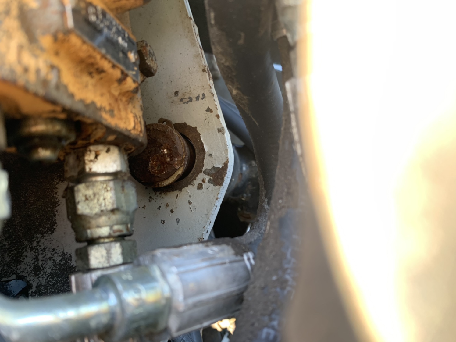

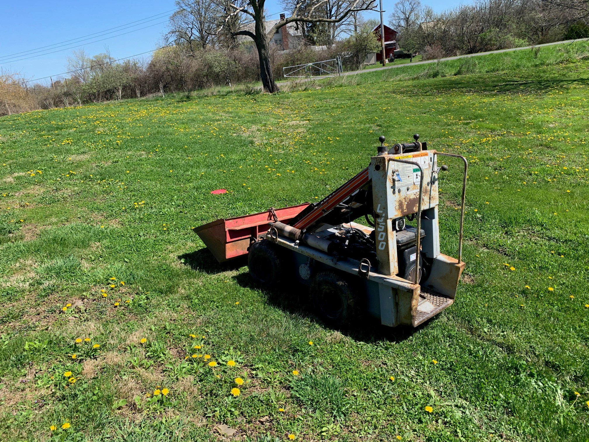

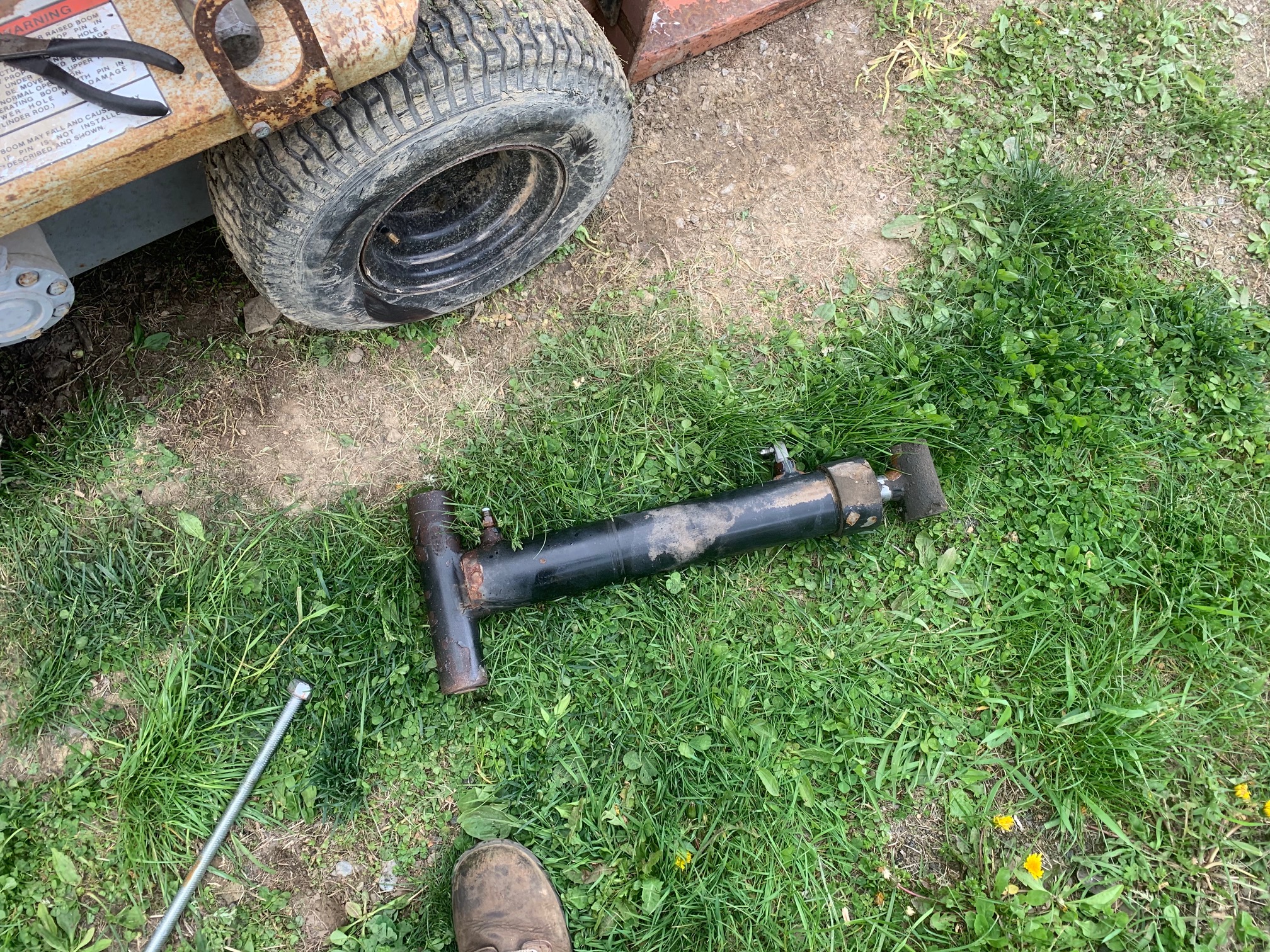

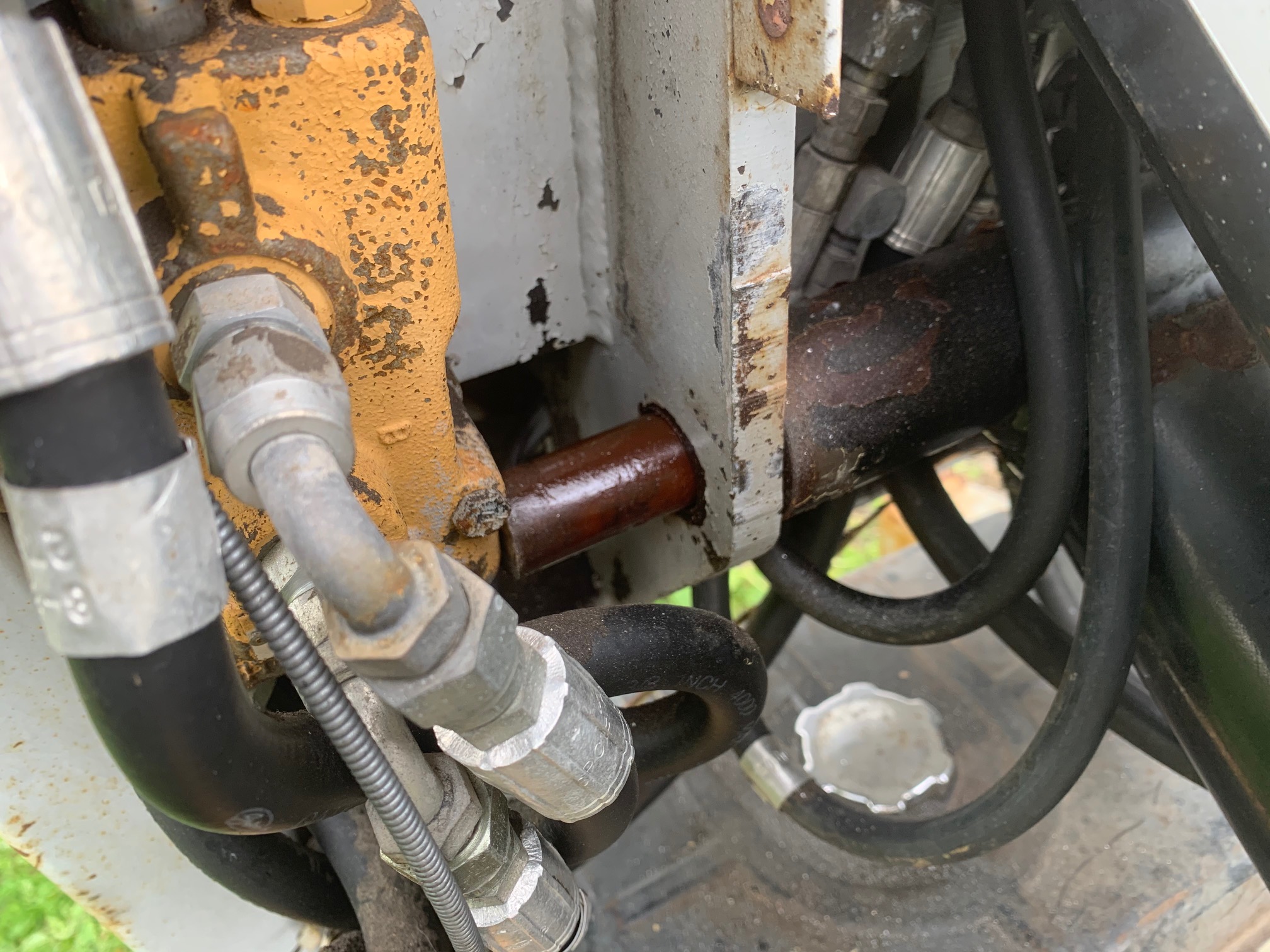

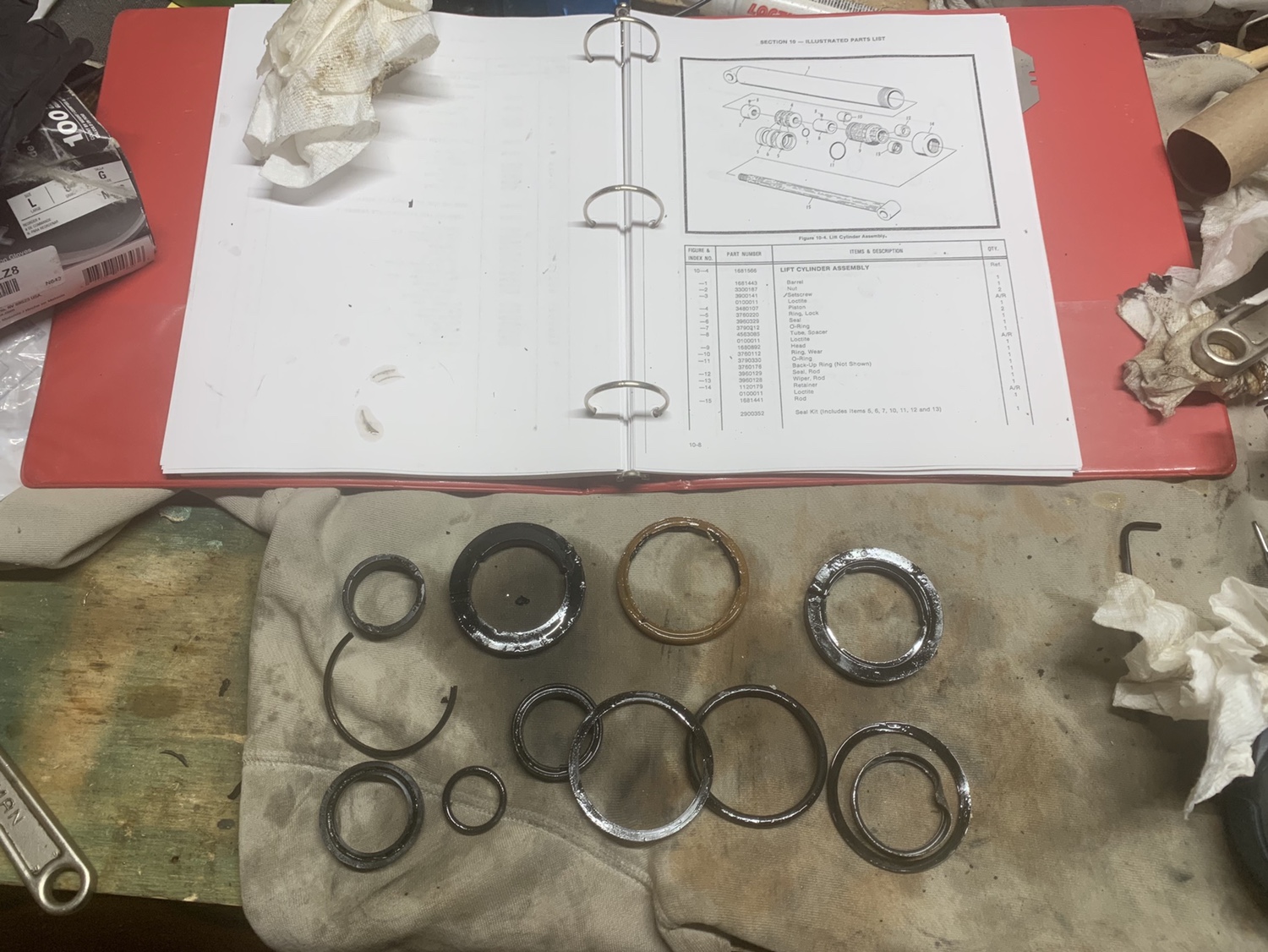

I worked on the LJ500 a bit this weekend. The upper lift cylinder pin (closest to the operator) is seized inside the rod end. As such, when the loader arm/boom is lifted, it rotates against the steel main structure of the unit. It's already caused some significant wear, so until I can get it out I won't be using it at all. I tried using a piece of pipe and a 3lb sledge to knock it loose but to my dismay, it's stuck fast. I've got it soaking in Kroil now, I just keep spraying it every time I walk past. I'll try again this coming weekend. If it doesn't come loose, I'll hit it with the torch. The pin will need to be replaced, and I figure now that I scored a sweet (15?) speed Rigid drill press for $100 I can drill and tap the rod end for a grease zerk. (might as well do both ends, eh?) I did have to use the machine quickly to move the drill press as it was way to heavy for me alone. I put the forks on and drove it straight across my saturated grass to the basement doors and stuffed it right inside, stood it up, done. My Massey 35 would have sunk out of sight where this little thing just left some mud-stained tracks in the grass. No ruts.
So that's where I'm at. Once again, here's a picture of the pin in question. Worst case scenario, I'll have to remove the hydraulic controls off the right side, there's an access hole there. I'll weld a piece of threaded rod to the pin and use a large slide hammer to try and jar it loose. If that doesn't work, I might be able to shift the rod end side to side enough to fit a sawzall blade in there. No clue if that pin is hardened or not. If I can cut it out like that then maybe put the cylinder on my 20T press to pop the seized section out?
I'll figure it out as I go. For now, hopefully Kroil + heat will do the trick.
Also of note: When I ran the machine on Saturday it had been sitting out in the warm sun for a few hours. As such, I'm assuming the hydraulic oil warmed up a good bit, because the machine was MUCH faster than it has been the previous times I've used it. This solidifies the notion that whatever hydraulic oil is in there is too heavy and will 100% need to be replaced with 10w30 as the manual calls for. 9 gallons!
