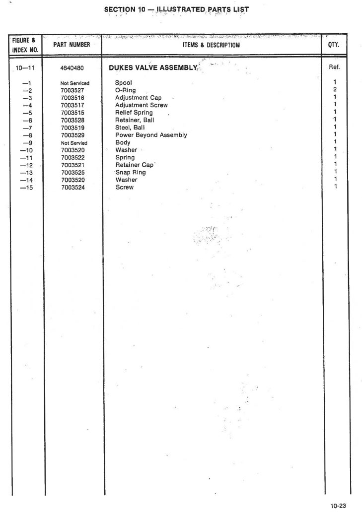

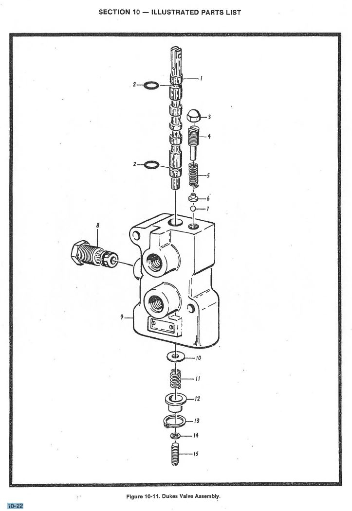

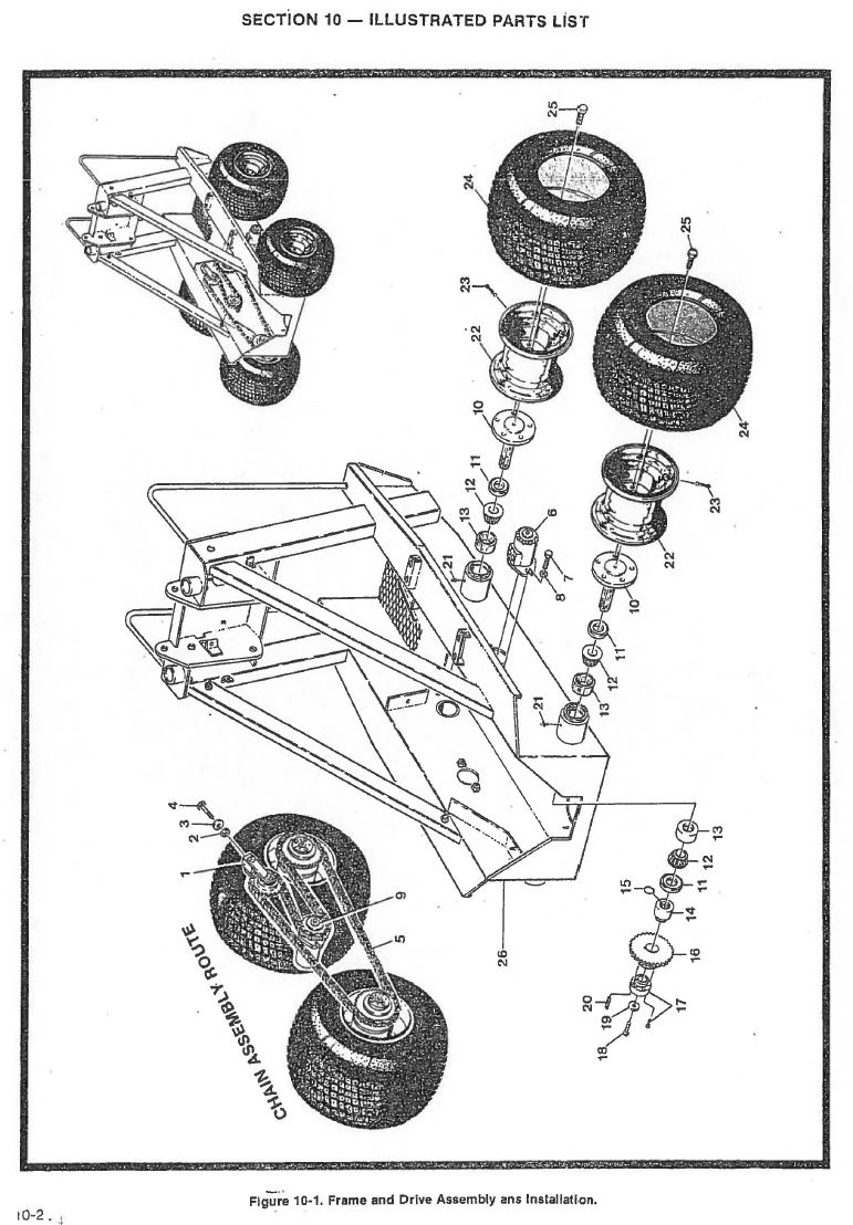

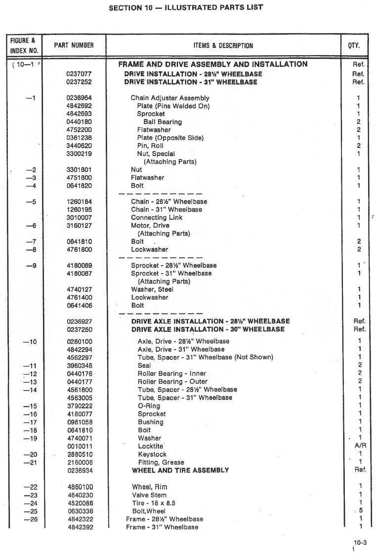

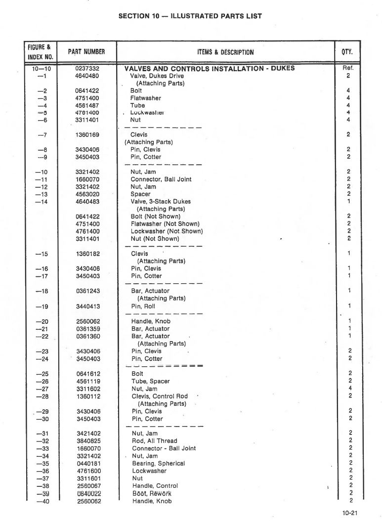

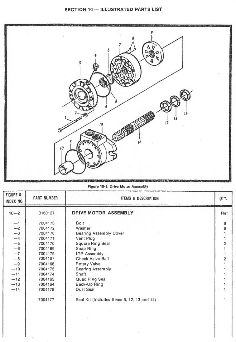

Did I send you the manual and parts manual? I can't remember. In any case, I replied to your PM. I'll post the info here as it's relevant to others who might be having this issue.
The Duke control valves appear to be rebuildable, but there's not much to them. Looks like maybe just a couple of o-rings in them. As long as the internal parts aren't worn or grooved, you should be able to rebuild them pretty easily. I know others have found replacements that work, but finding some that are small enough will likely be a challenge.
Pics I'm posting are for rebuilding the drive motors and spool valves, and last pic is a possible source for a drive motor seal kit, though I haven't verified that it fits and that the part number hasn't been recycled.

Also, from one of the threads I posted a link to in the first post- this valve might work with some fabrication if the Duke's can't be rebuilt:
I think max flow on these machines is 9gpm. If you're worried that it's more than that, this would work but require fabrication as well:
Both of them are huge compared to what the LJ500 came equipped with, however both of them would be much tighter since they don't use linkage for the different spool contained within the valve like the Dukes.

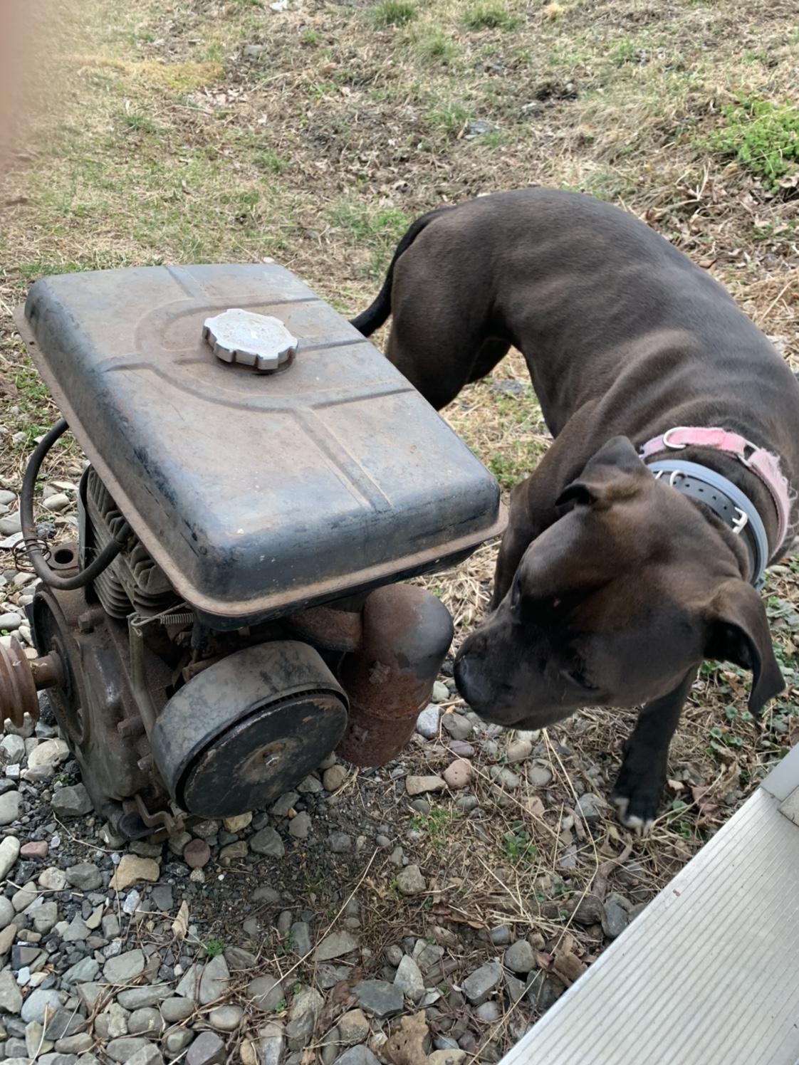

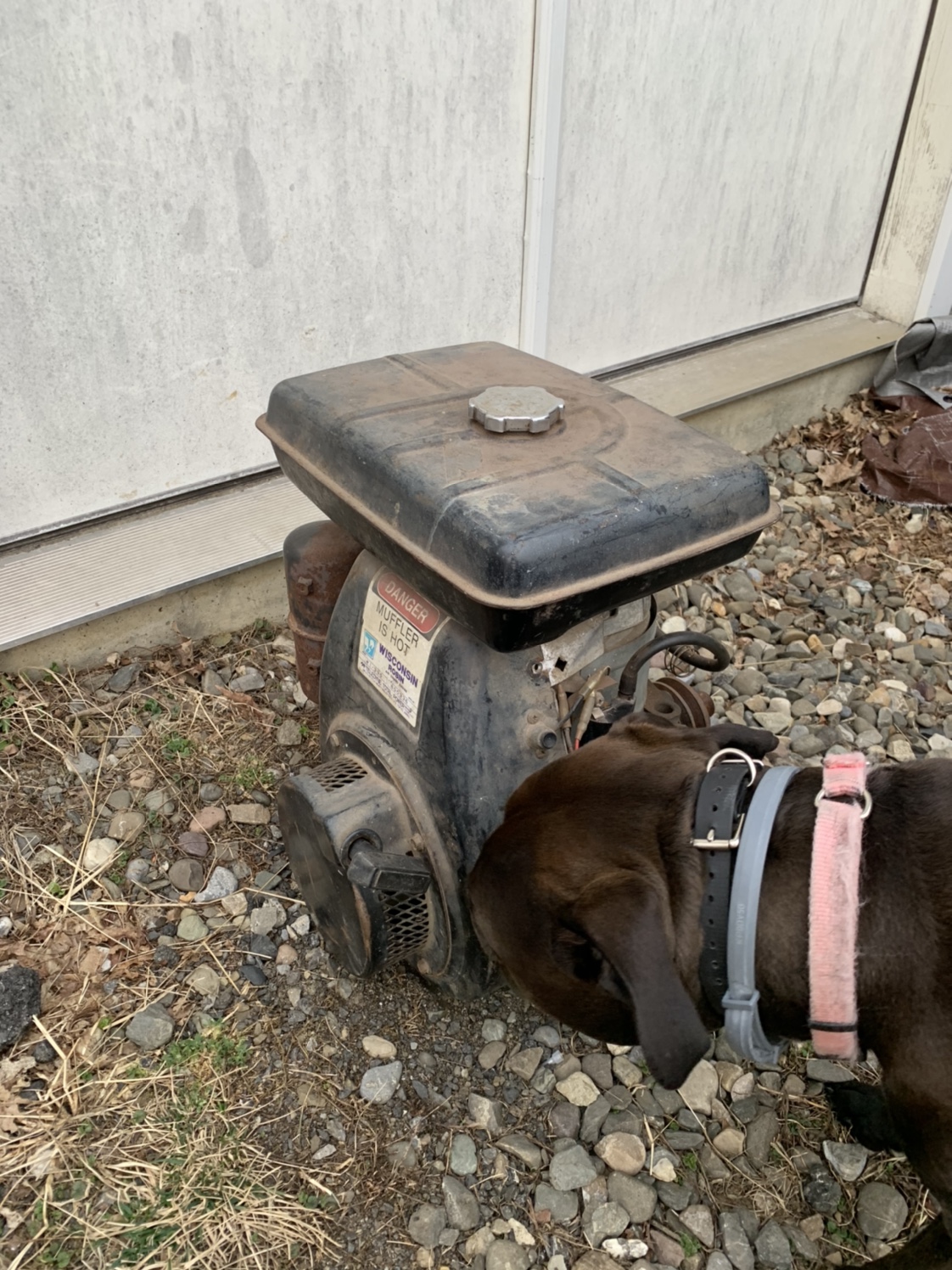

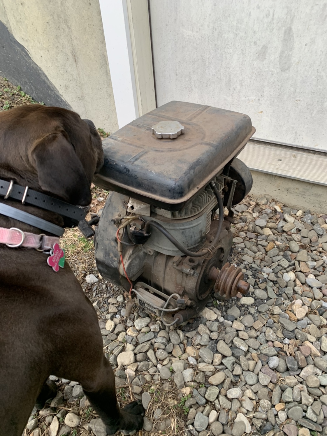

Got a few minutes and snapped more pics of the (potential) donor engine. Carb is in great shape, it’s got the right air cleaner housing on it, the tank is clean, the filter bowl/screen is clean, overall, well worth $20!

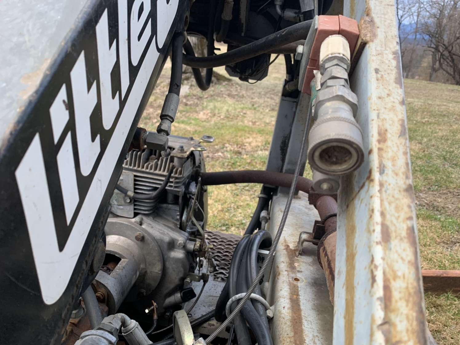

And lastly, I’m apparently blind because my LJ500 DOES indeed have hydraulic remotes, they’re just in a different location than I expected them to be. Either way, it’s difficult to believe I missed them because they’re right in front of my face!
