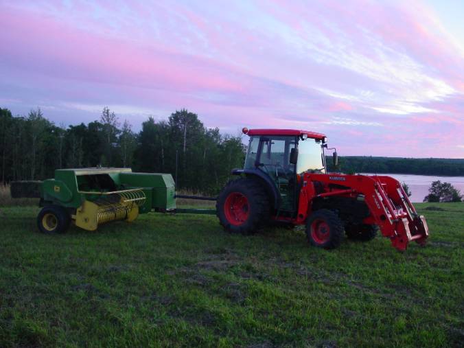

We use a 42 pto hp Kubota on a JD336. The kubota is an L5030 and weighs around 6500 lb or so. I hauled some haywagons without baler down our hills that are steeper than 10% and was really impressed, it didn't notice them at all and the 4wd was available for extra braking vs the 2wd tractor we use too.
Attached is a pic from last night taking second cut off a neighbours field.

I agree that just hauling the wagons with hay won't be a problem. It's when you have the baler throwing the tractor around on a side hill pulling a couple ton of hay that it gets interesting. Even with the 6415 or 4020 it still rocks the tractor with the plunger action.
   / John 348 Square Baler - no go with a 4720? #15
I agree cowboydoc, with a wagon on back of the baler things can get out of hand very quick in hilly terrain.
I was trying to explain to our neighbour who is newish to haying why she shouldn't use her pickup to run loads down the steep part of our property, and if she really wanted too why she should load the bejumpins out of the truck and keep the front of the wagon loaded evenly not all to the rear.
She may have got the idea better when I adjusted the rack on a wagon with the loader while she tried to hold the wagon with the truck. I could effortlessly slide the truck without noticing the resistance.
