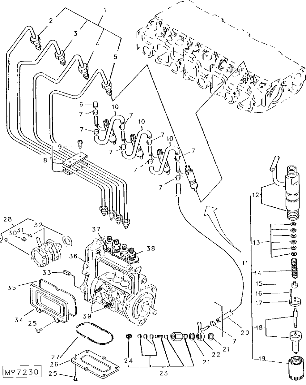

MICHAELL
Check to be sure the valve(parts key #23) & excess fuel return line aren't plugged. As far as I know no diesel engine with an inj pump will run with a plugged fuel return line.
