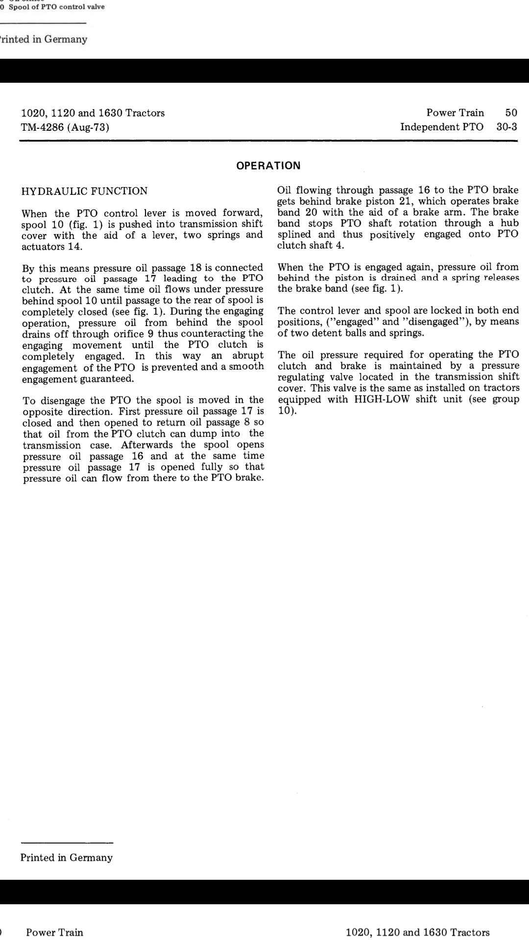

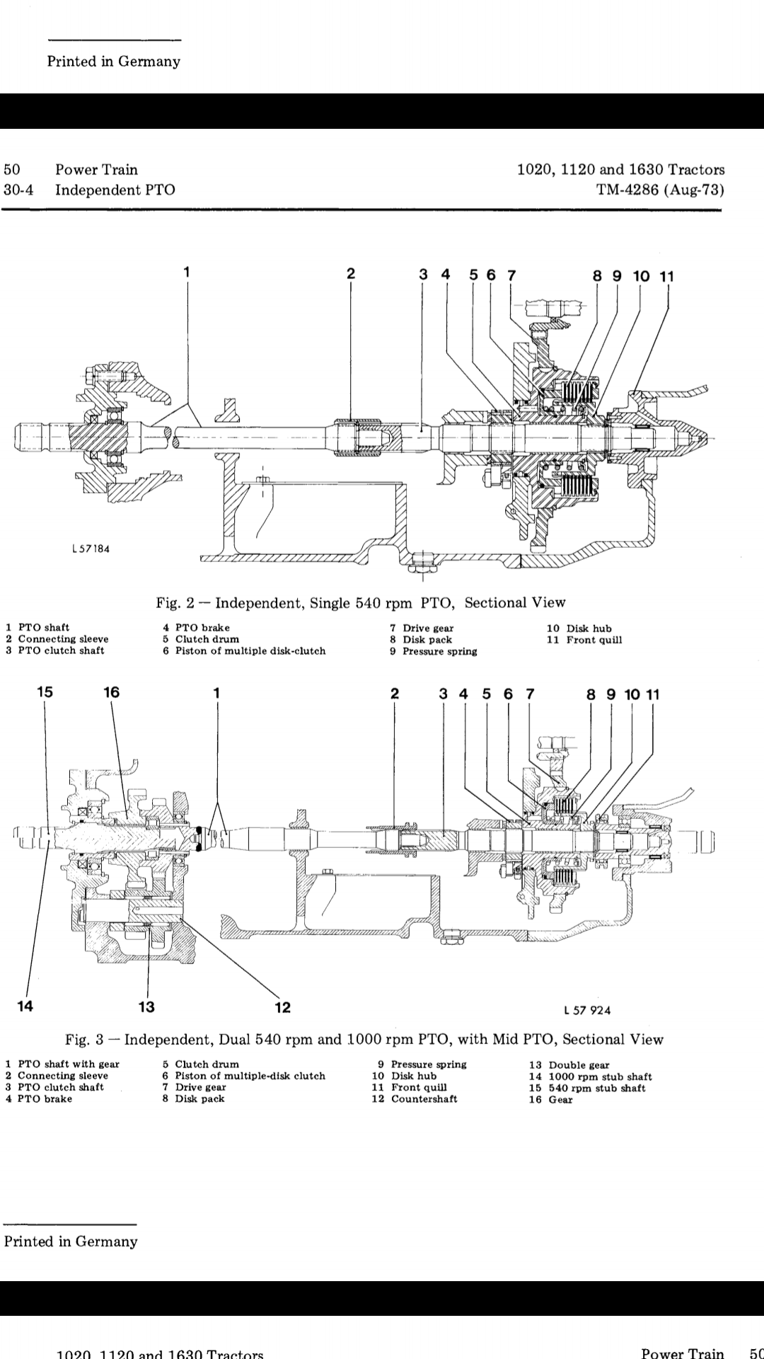

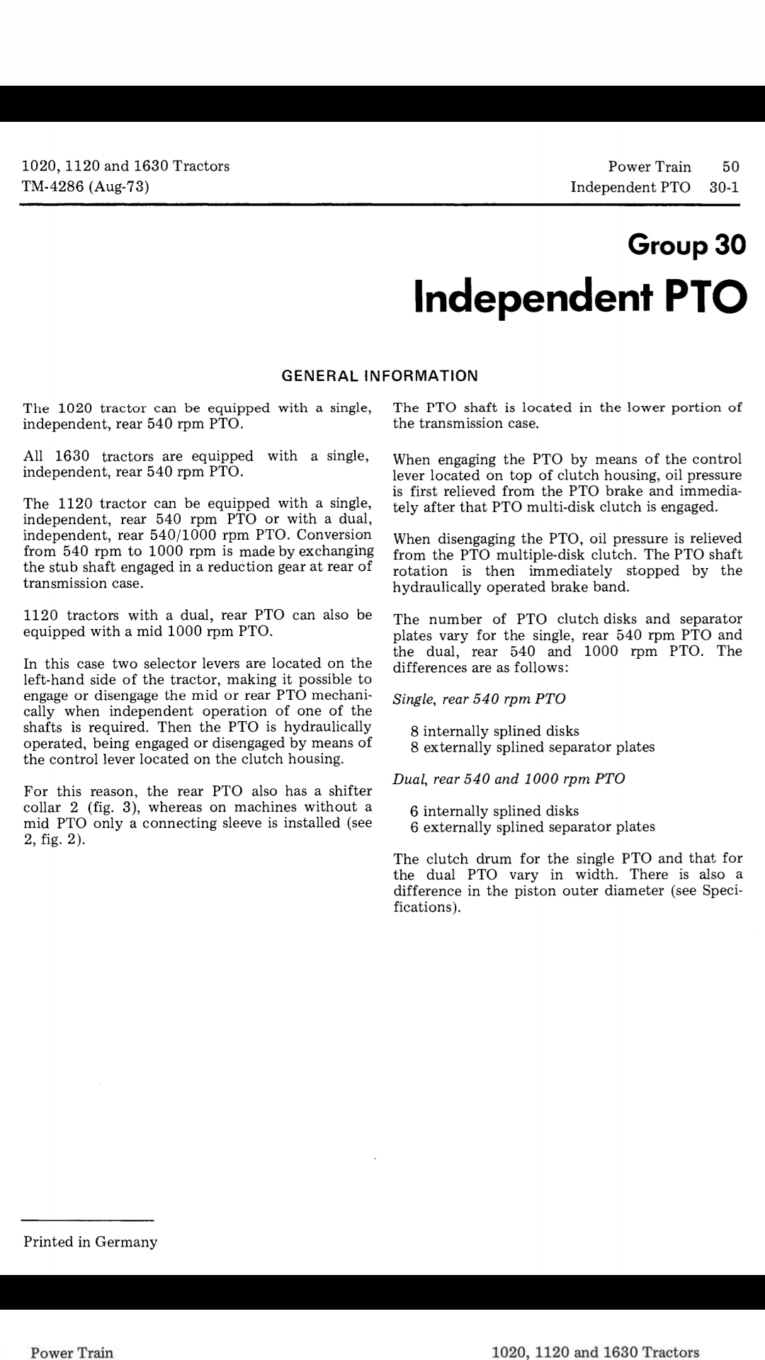

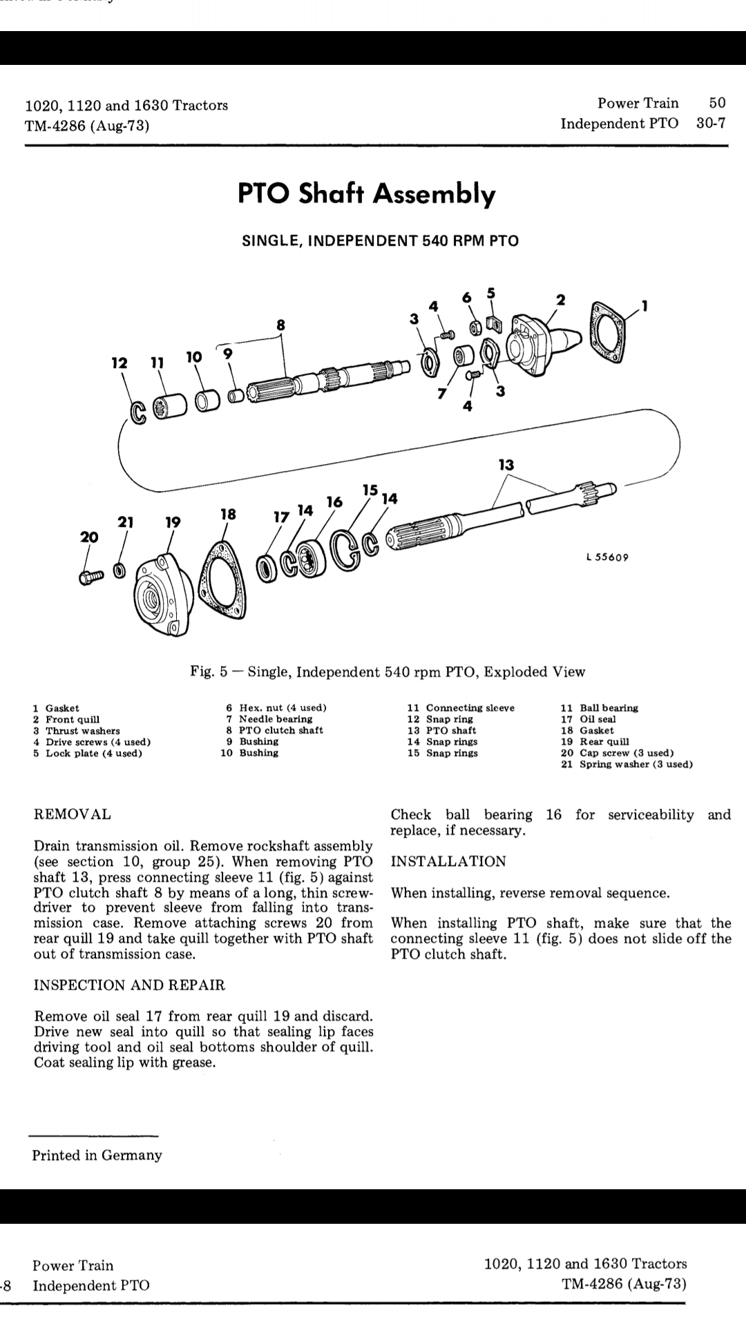

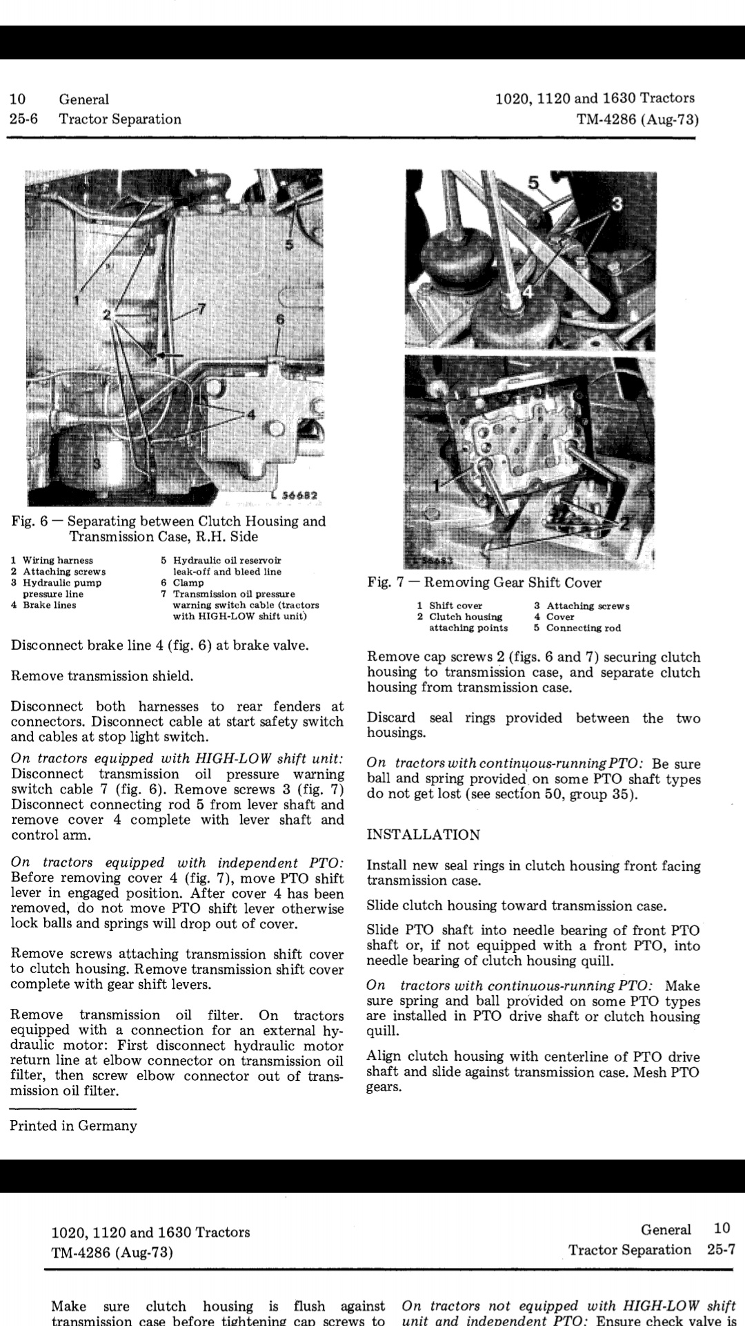

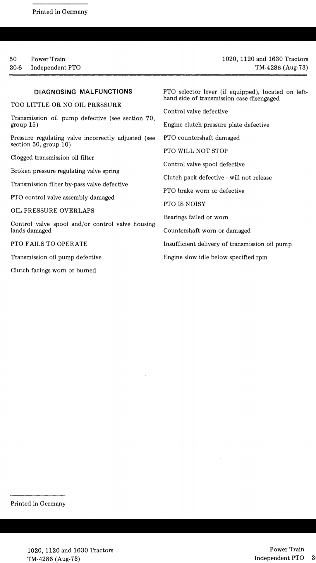

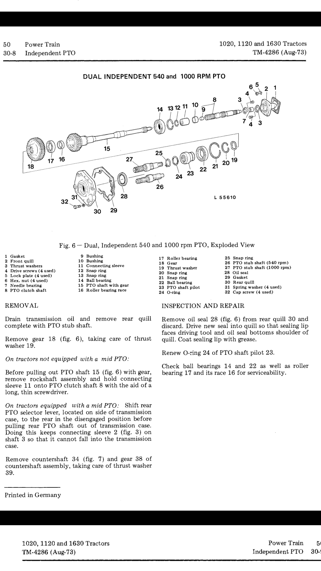

LouNy your reply really got me to thinking about just how the PTO clutch works in this old Deere. So much that I purchased the technical manual online.
After hauling 28 round bales through the Texas rain. I finally got a chance to look at the book.
For a few days now I have been looking at the parts list online and notice a "PTO Clutch" section which seemed to be internal to the transmission. Being the novice that I am I prayed that my tractor didn't work this way.
After reading the book I have come to the conclusion that yes the JD 1120 is an Independent PTO with an internal transmission power shaft clutch. I now believe I have to split the middle section of the tractor as well to replace the 6 to 8 pairs of disks and plates inside the PTO clutch. I have uploaded some material for you guys.
Yay more fun... I'm thinking should i change thread title.

   / John Deere 1120 splitting problems #13
After reviewing your photo's in post #7 I agree with you that your tractor has hyd ind pto.

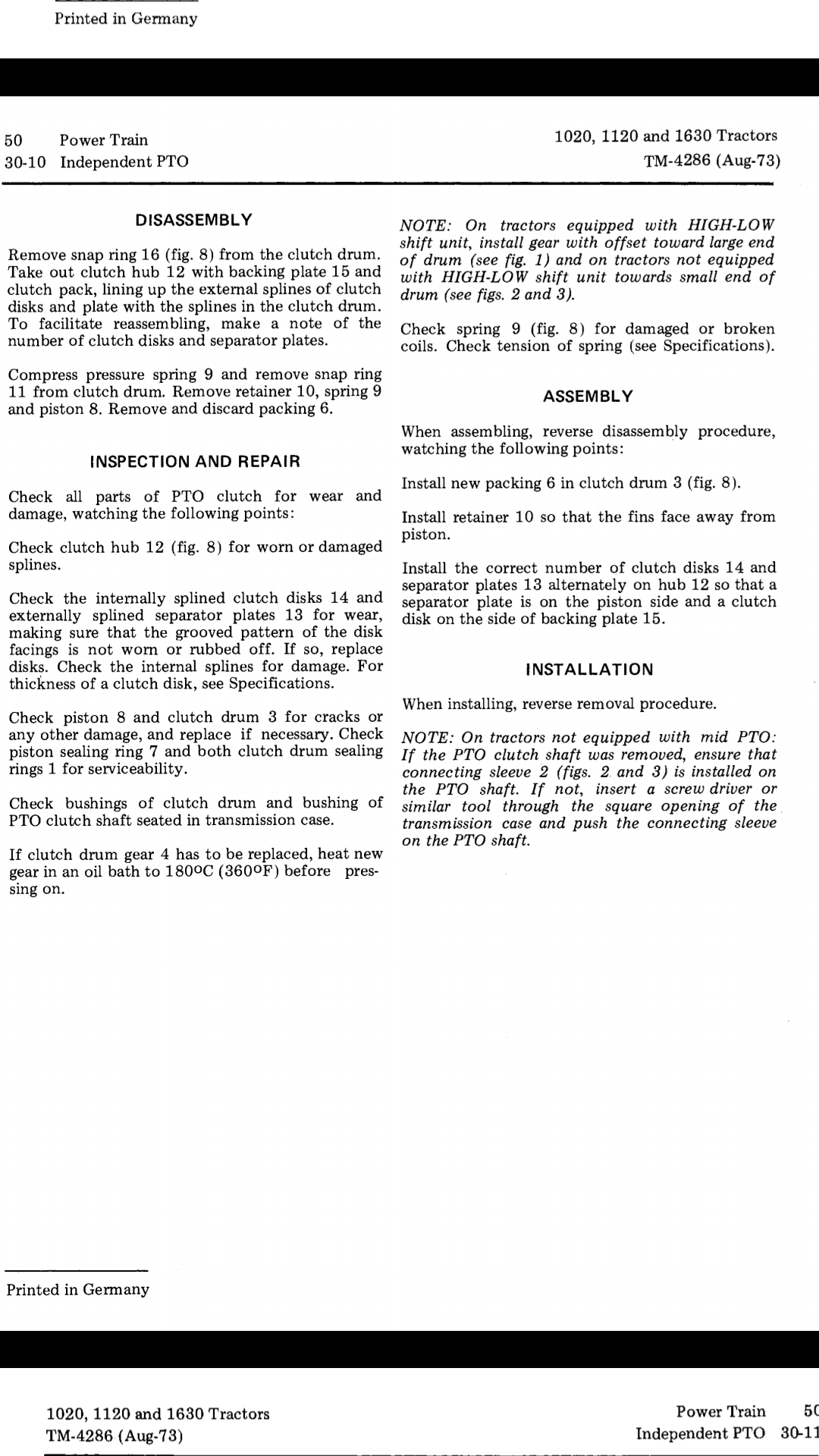

   / John Deere 1120 splitting problems #14
A manual can be a good help for sure.
Does your manual give any directions for splitting and rejoining the splits.
Most independent PTO's that I worked on didn't require a split unless the drive hub had failed.
Good luck with your repairs

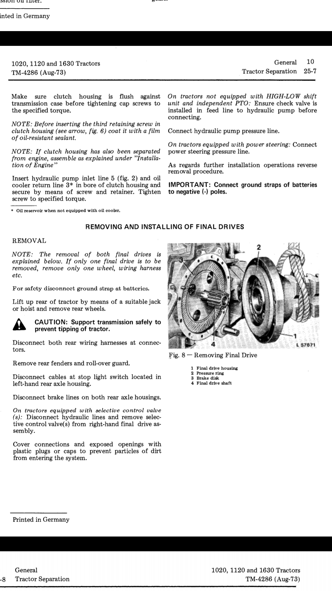

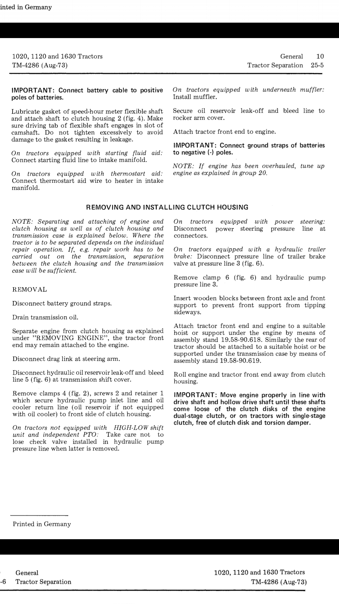

#15

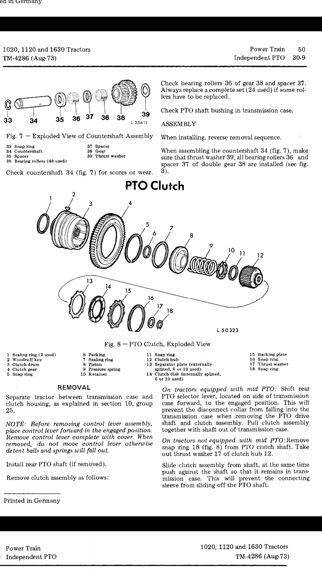

I believe that I have to remove the clutch or Bell housing from the transmission. The clutch should be just behind and below the on/off lever located between the two gear shifts.

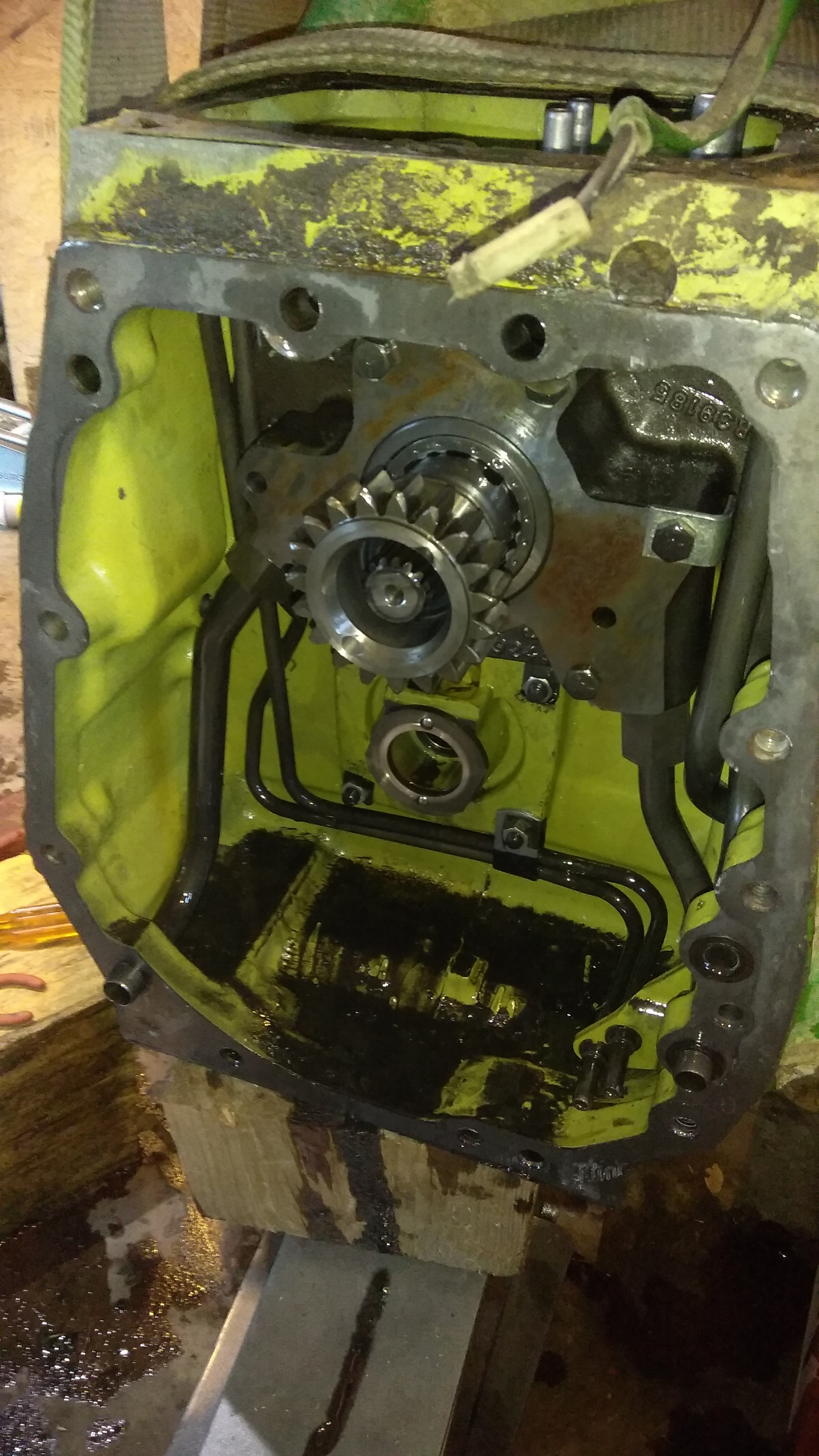

#16

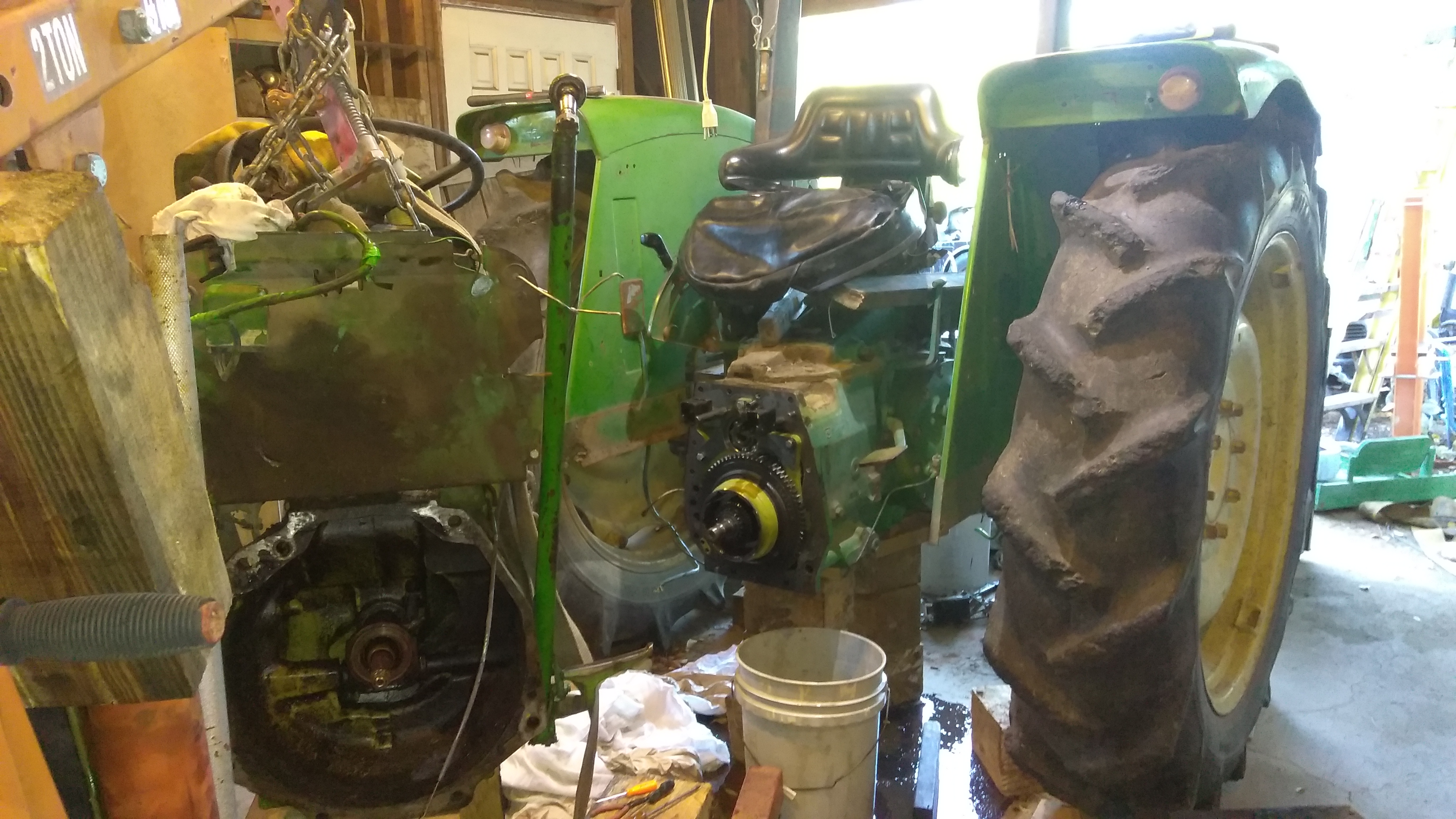

Well today I got to put in some more time into the JD 1120. The clutch housing separation from the transmission went off without a hitch. Except for the mess of course, thank you family Dollar kitty litter.
I was able to split and remove the PTO clutch disks and pressure plates all 8 of them. Of course I posted some photos and am always happy to get any input you can provide.
   / John Deere 1120 splitting problems #17
Assuming you have the tractor manual, make sure you follow step by step when you put it back together!
I see so many things that need to go back together in the proper order.
No fun having to go back in.
