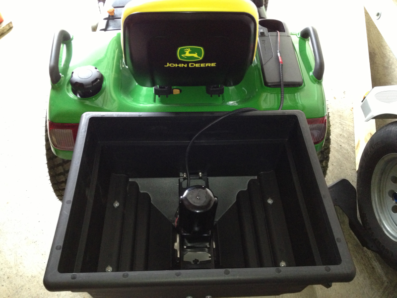

Back again!
After explaining the wiring installation to you, it occurred to me to remove the existing switch and length of wire from the spreader since I am not using it and install the shorter wire shown in the picture draped over the seat! Now I have a very clean installation with just the right length of wire!

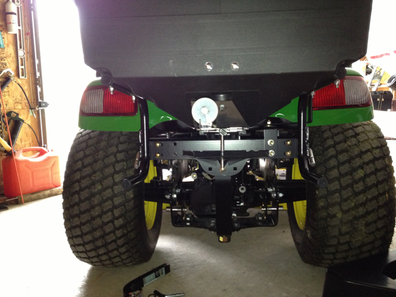

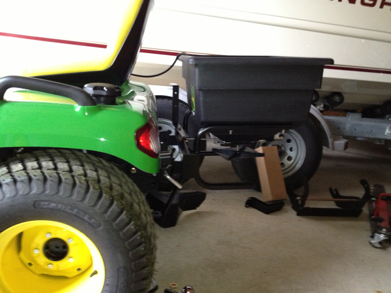

Hi Guys,
Here are some pics of the Spreader Installed. The "Extra" wiring on the seat came with the spreader to run back to the battery with the purple wire connecting to the ignition ( that must shut the unit off with the ignition switch is positioned off)
I went to Tractor Supply today and picked up the accessory plug you see next to the Tractor's accessory outlet. Accept for the extra wire tied to the tractor fender handle I think this install is cleaner. If all works well I will cut the wire shorter and install an accessory plug directly to the spreader wiring.

I'm not sure if I'm seeing this right, but is the spreader connected to the click-n-go brackets?
   / John Deere 125 lb Electric Spreader
#16
Yup, I needed to remove the click-n-go suitcase weight bracket and the spreader took its place. There is also a bracket at the center point that attaches down to the existing hitch bracket.

Hi rboss75

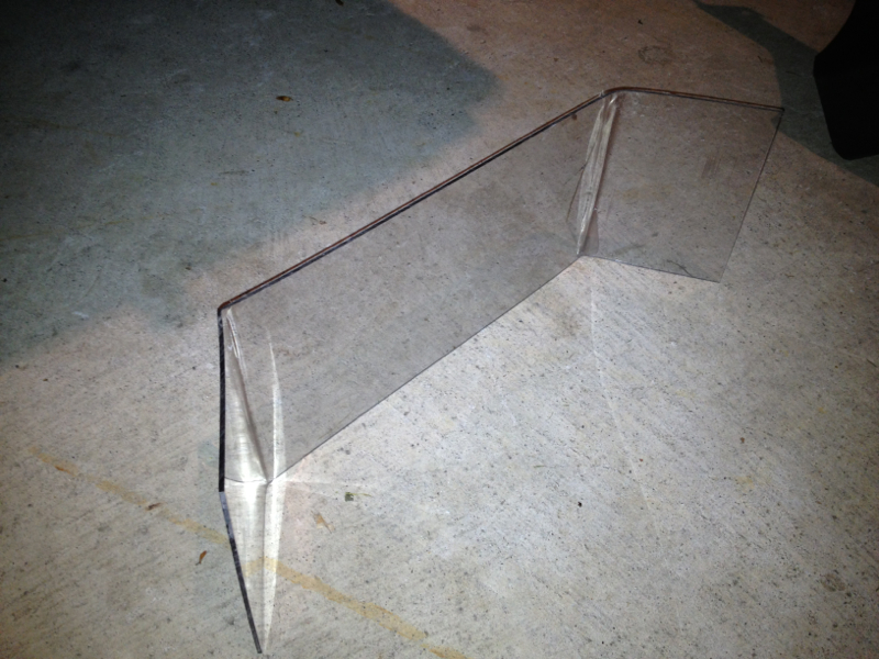

The installation instructions don't mention having to remove the lower draft arms nor do they mention having to remove the upper link arm. If you look at the pics I sent it looks like the link arm maybe the only thing in the way. You will need the click-n-go brackets to mount the spreader to the tractor. Also I purchase the barrier shield to keep the material from hitting the back of the tractor and unbeknown to me it installs behind the spreader I guess to keep material from shooting too far behind the tractor?
So tonight I went to Lowes and purchased a piece of polycarbonate and fabricated my own shield to protect the back of the tractor!
All n All I am very happy with the construction of the spreader. I will try it out this weekend and report back!

Ok. Great thanks for the info. When you take off the spreader can you take a photo of the click & go bracket. For some reason I think that the three point set up ( not the lift arms) will not be compatible. Than you
   / John Deere 125 lb Electric Spreader #20
It is my understanding that the click and go bracket is not compatible with the three point hitch. I would be interested in an IMatch compatible model myself. Right now I am using my larger spin spreader on the IMatch with the x749 it works well but I don't overload it either.
