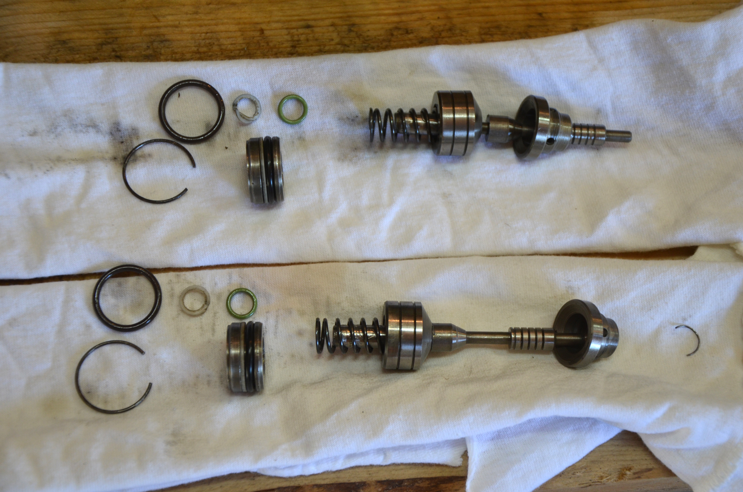

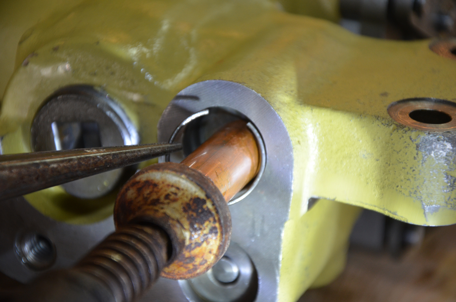

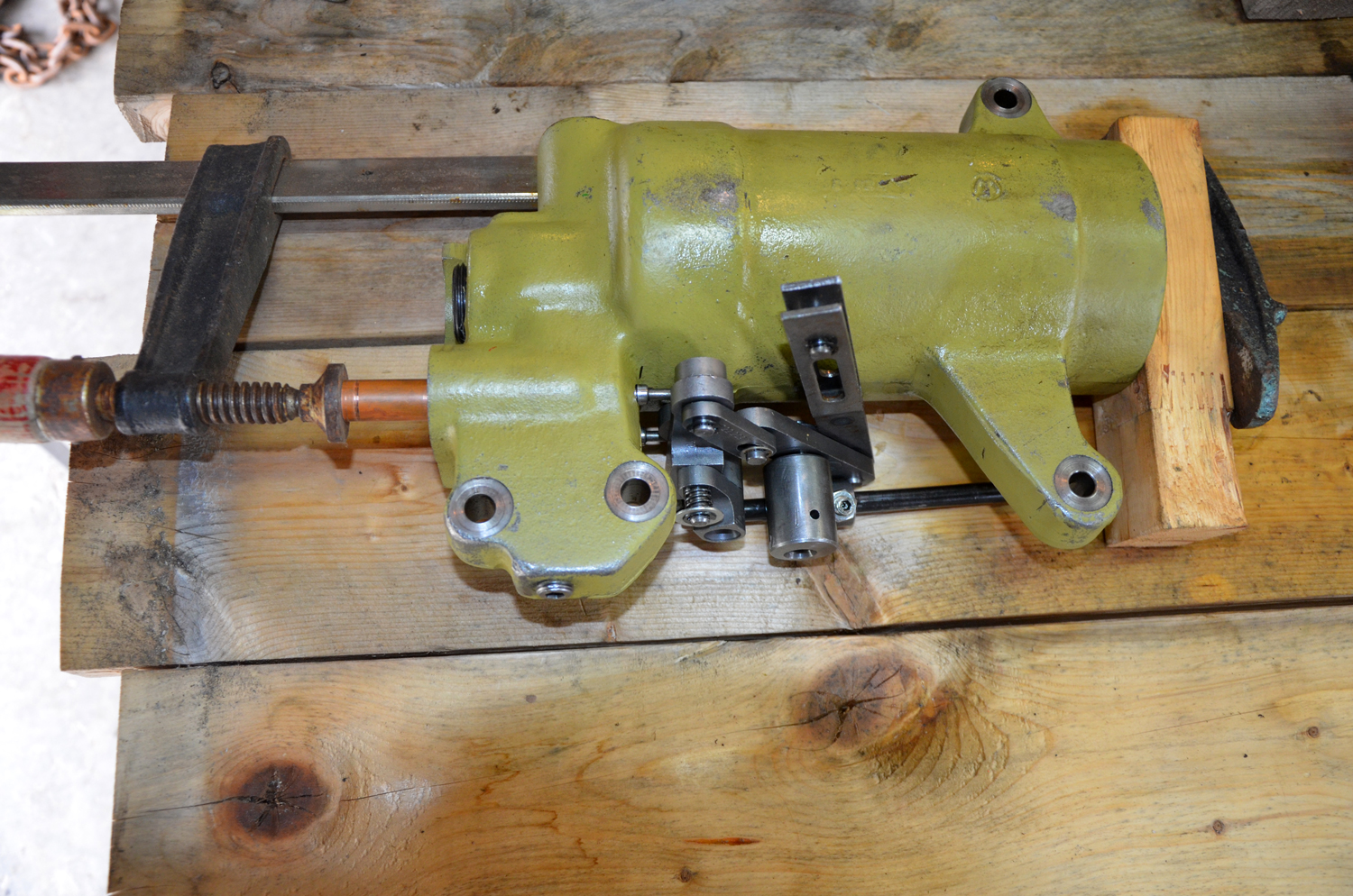

I want to thank everyone for their input on this. Tx Jim--you were right, the top had to come off.
After over a month of dealing with other matters here on the farm, was finally able to get back to it. Ordered a Rockshaft Seal Kit, new piston rings, new gasket for the top, and new washers for the Rate of Drop valve. Took the top off and went at it, changing out all O rings, washers, and piston seal, etc. Learned how to remove the valves and found what I believe was the culprit--a small piece of wire or a shaving from a steel washer that was trapped inside one of the valves. This would make sense considering the weird behavior of the hydraulics and the spraying of oil everywhere inside the Rockshaft when the lever was in the down position--the valve couldn't close! I was pleased that the piston showed very little scoring. Anyway, got it back together and it seems to work just fine so far--very reliable. Wish I done the new seal kit when I had the top off a few years ago.
This 1st image is of my jerry-rigged valve compressor--a short piece of 1/2" copper pipe around the valve stem allowing to gently compress with a c-clamp to access the snap ring.
Accessing the snap ring.
The valves removed, showing the replaced parts beside (the new ones were part of the Rockshaft seal kit). Note a small piece of wire near bottom right--that was up in the valve seat preventing the valve from closing.
Anyway--thanks for your help. Cheers!

Thanks for the pictures, and copper pipe trick. I hope I do not have to go into my 2030 rockshaft cylinder or valve :thumbsup:

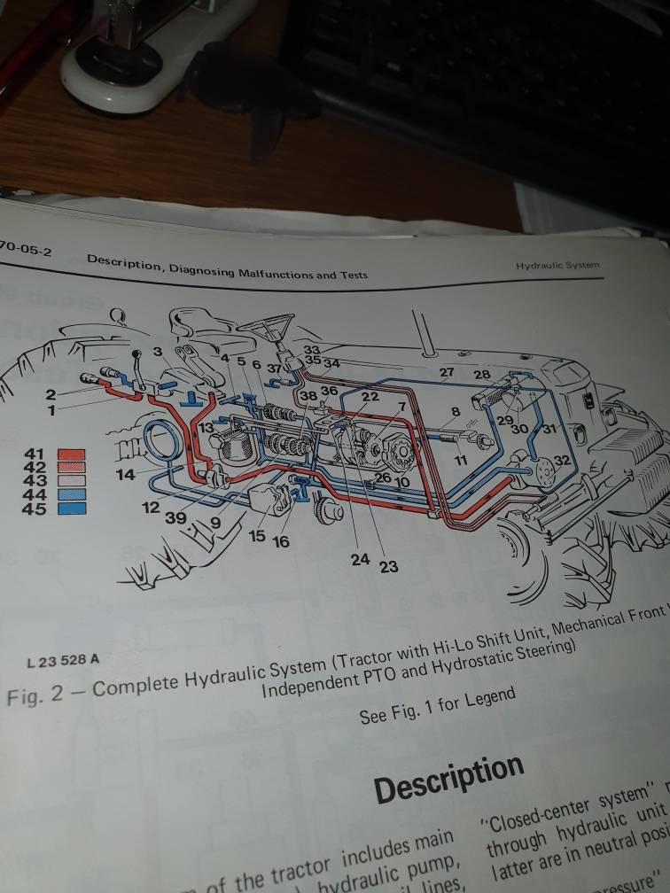

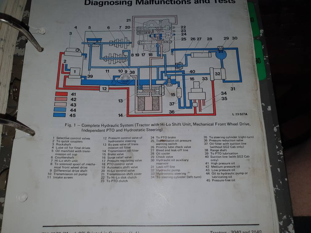

Hi, TxJim... The problem is that - the tractor hydraulic does not lift, in the backside... Soo, it does not have enough oil pressure. This is one of my friends tractor, my own is JD 1020.
He replaced all of the filters, changed the hyd oil with JD HyGuard, changed the little pump in the crankcase... and does still not lift... He measured the oil pressure - it was only arround 100 bars, instead off 170 bar, as it has to be according to the descriptions---- He tried an other, used pump and worked... What other problem could have?
According to your opinion, the AR103033 or AR 103036 pump would be good? It does not wors to be fixed the old one...

I found something new: ex. in morning, in cold, when the engine, the tractor body is cold - the lifting works perfectly... But, when it gets warmer, the lifting is weakens and finally, does not work at all... Ex. he was ploughing and he had to leave the tractor on field until it is not cold again and starts to lift again... AND, it did all these things with the other, used pump... it was ther same problem - in cold OK, when it got warmer, did not work. I mention - the servodirection works also related to the temperature.

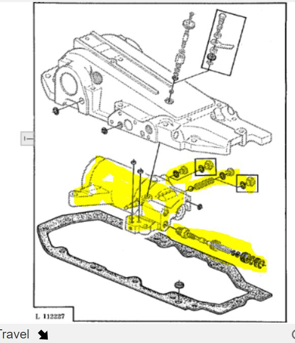

   / John Deere 1640 Strange Hydraulic Problem #31
With hyd oil warm, engine operating 3 pt raised or 3pt control lever to the rear look into open hyd filler hole for moving oil. Moving oil indicates faulty 3 pt control valve seals. Internal hyd leaks causes hyd to heat lowering it's viscosity & lowers amount of oil available for frt pump therefore causes frt pump cavitation.

As I see, we have a multiple type of problems. What should be do?! Where do I find this control valve - to replace seals?
I checked on a few diagrams, but I could not to identify it...
Probably that the oil pump is not guilty for the problems, should we forget for now the pump problems__?!
Before - we replace the control valve seals?!
Thanks, Benedek J.

   / John Deere 1640 Strange Hydraulic Problem #33
Per TxJim: If you see oil spraying, looking in fill cap of the rockshaft housing, you have leaking rockshaft (3pt) valve seals. You have to remove the rockshaft housing to access the rockshaft cylinder/valve assembly.
I would check/repair this before changing the front pump.
   / John Deere 1640 Strange Hydraulic Problem #34
Ditto what Zebrafive stated. Repair internal hyd leak then proceed with more hyd diagnostics. Hyd internal leaks are contributing to poor frt hyd pump performance

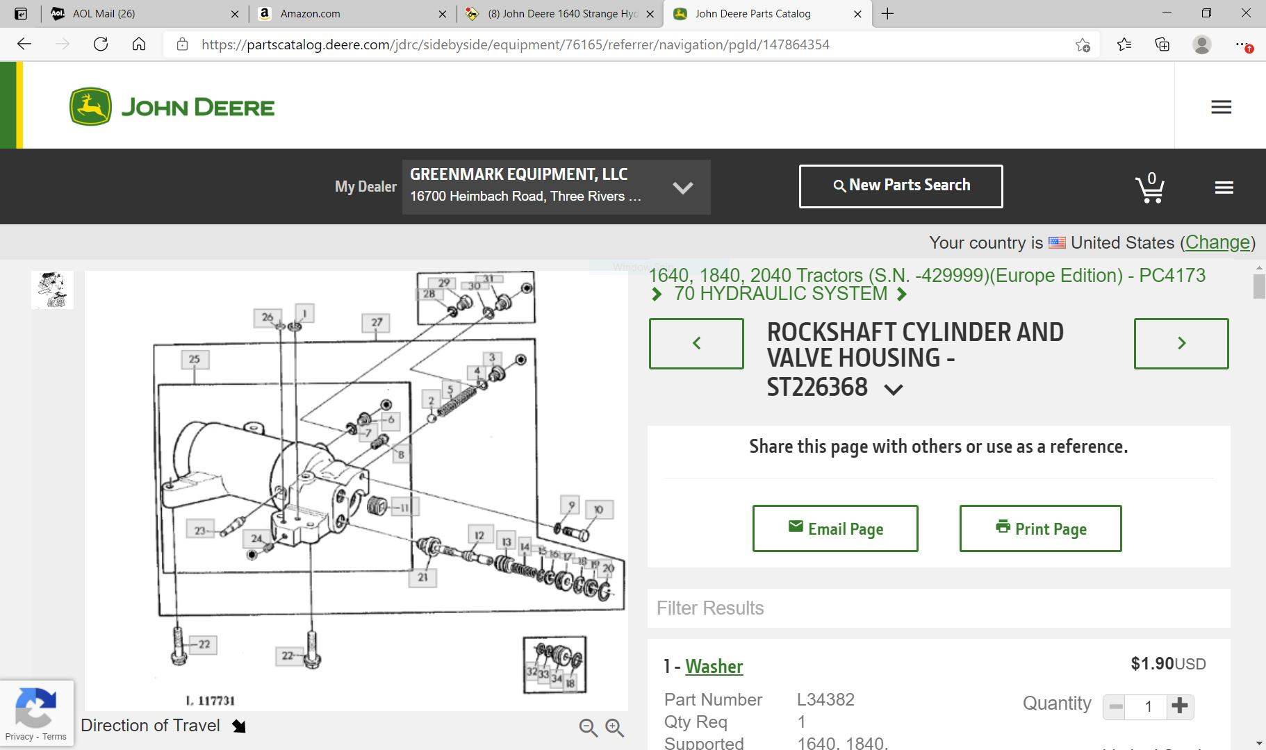

O.K., I understand... Maybe -the big piston sealing are used (AR33105)? Or, we have to replace all seals on the piston and at valves.........?! DOES exist any repair kit for the valves? If not, what should be replaced from those little pieces from the valve diagramm? Only the O-rings_?
   / John Deere 1640 Strange Hydraulic Problem #37
Rockshaft control valve seals/gasket kit part # is AL57974 & piston seals are part # AL33105
