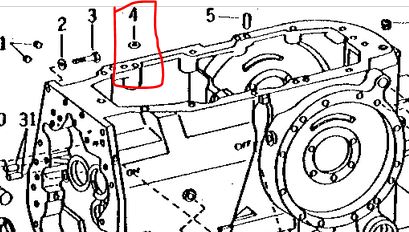

That could be the priority valve trying to keep up with the hydraulic system pressure rising and falling. Sounds like flow from somewhere that should not be occurring in the transmission.
Can you get the top cover off the transmission and have a look inside. Cautiously start the engine and look for leaks.
b&d
How do you propose to seal the hyd hole in the trans case that supplies the rockshaft control valve with oil @ 2250 psi if the RS housing is removed and engine started as you suggest??????????? I promise one won't have to look for that leak if RS housing is removed and engine is started. I've rarely seen the priority valve be the problem on a JD utility tractor. In fact the early 1020/2020 tractors didn't have a priority valve.

   / John Deere 2030 No Hydraulics #16
I suppose the line to the rockshaft could be capped.
THERE"S NO LINE TO CAP. If you'll look at the parts photo I posted you'll see the RS oil supply passage is cast into the trans case IE NO LINE:thumbdown:
   / John Deere 2030 No Hydraulics #17
Yeah, you are correct . The HP line disappears into the transmission casting near the oil filter.
