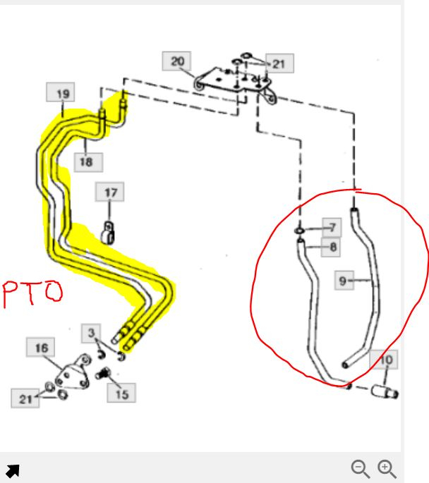

MY GUESS is you have the hydraulic PTO clutch and a broken internal line. My 2030 with a hydraulic PTO (lever between the shifters) had the line (engage) from the valve to the PTO clutch break and all flow from the trans pump was just going back to the trans case (sump) and all my hydraulics quit. I had to split the tractor to repair. The replacement line was heavier than the original. I also should have replaced the other PTO clutch (disengage) line while I had the tractor split. Hindsight is 20/20.
If you have the Hydraulic PTO clutch (lever between the shifters) see if disengaging the PTO effects your other hydraulics.

IIRC when tractor is split between clutch & trans housing the lines that supply oil to hyd IPTO & Hi-lo are accessible to replace ines & line seals. You can check for leaks with air pressure applied into each tube after trans shift cover has ben removed

Jim is correct, clutch housing to transmission case split. I would replace BOTH lines while it is split. JD upgraded the lines. They are the ones in yellow. Red circled lines (in 40 series tractors) JD added a guard to these lines;P/N L57983. I would do that too, while split, add the guard. IIRC it's a spiral loom you put around the tubes.
