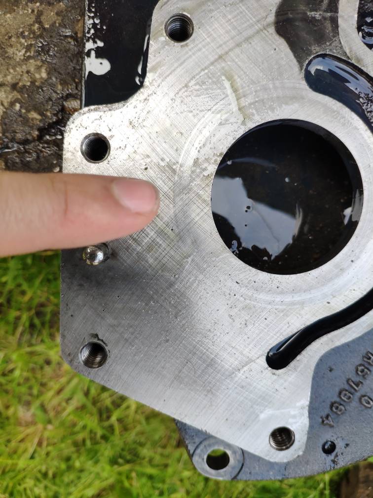

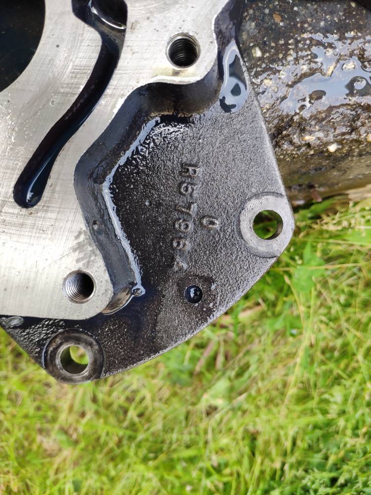

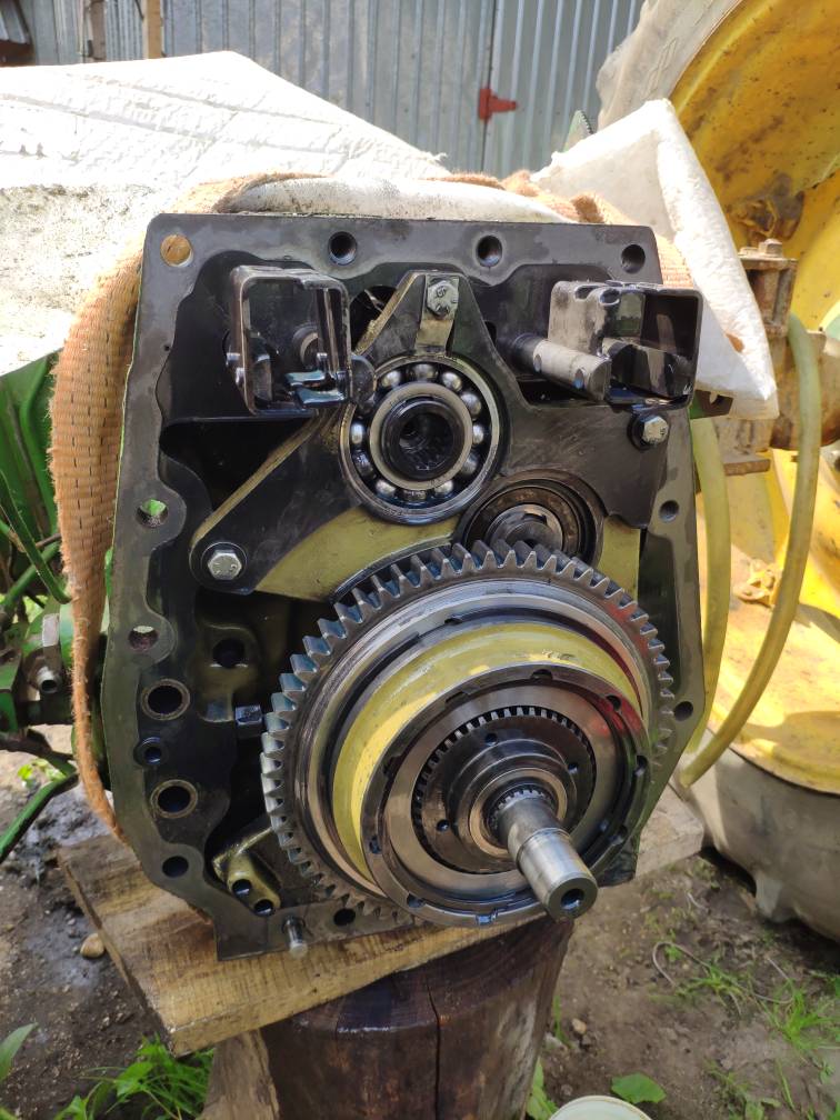

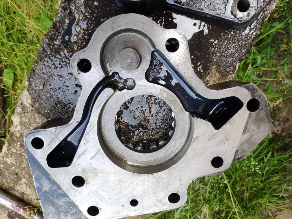

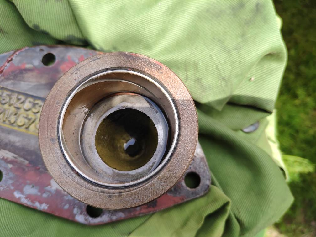

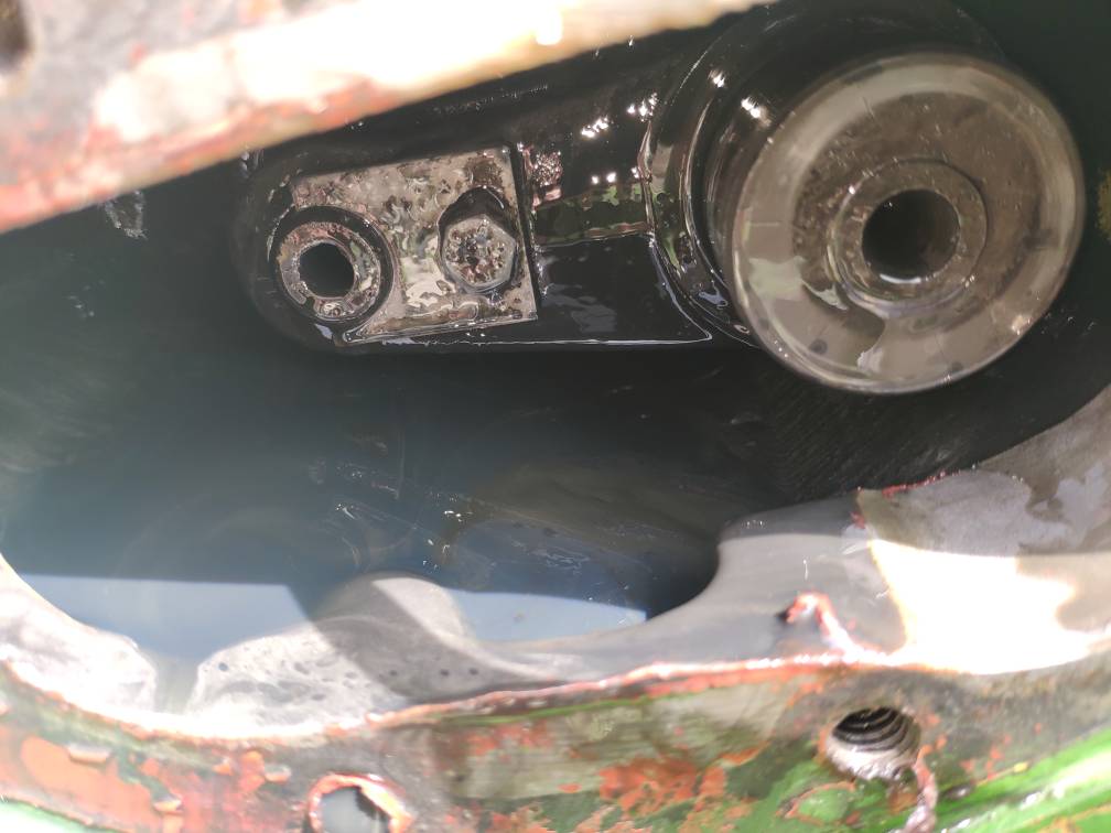

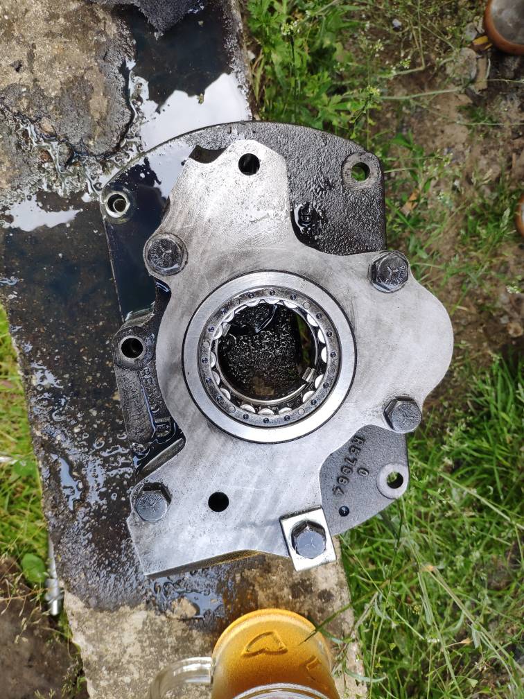

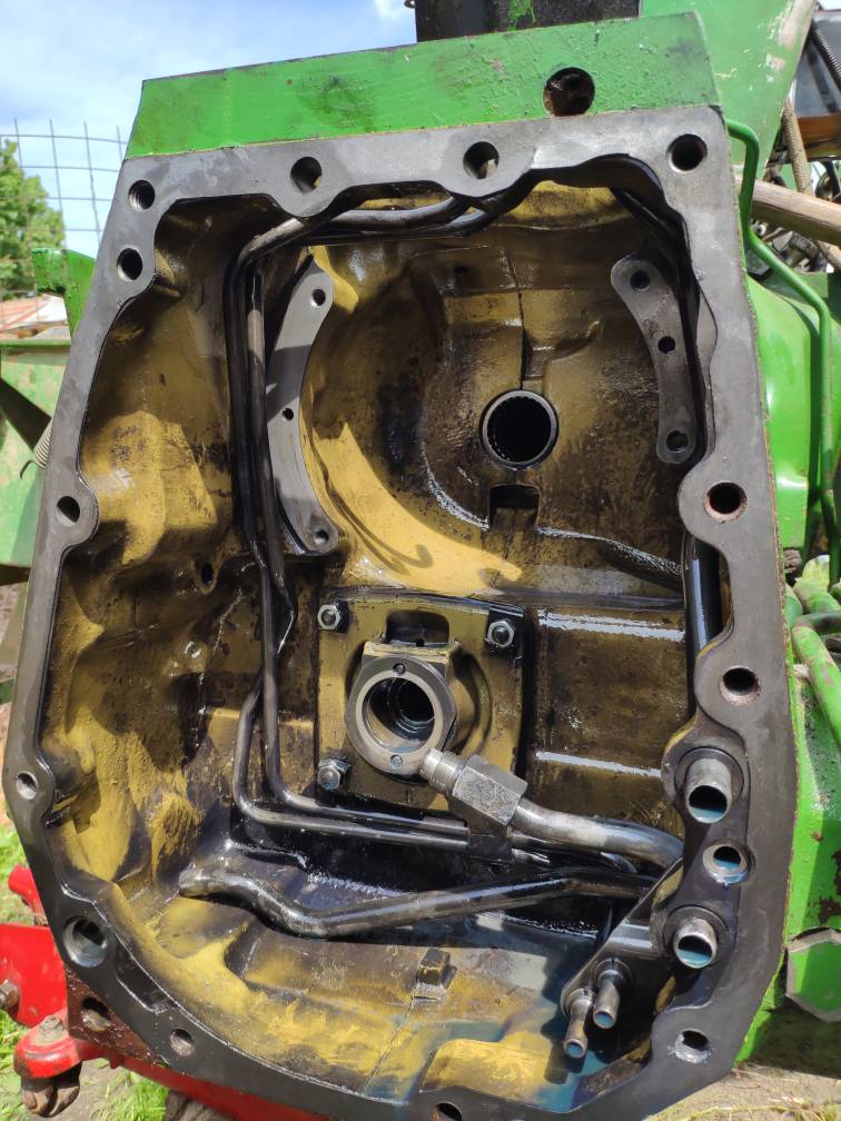

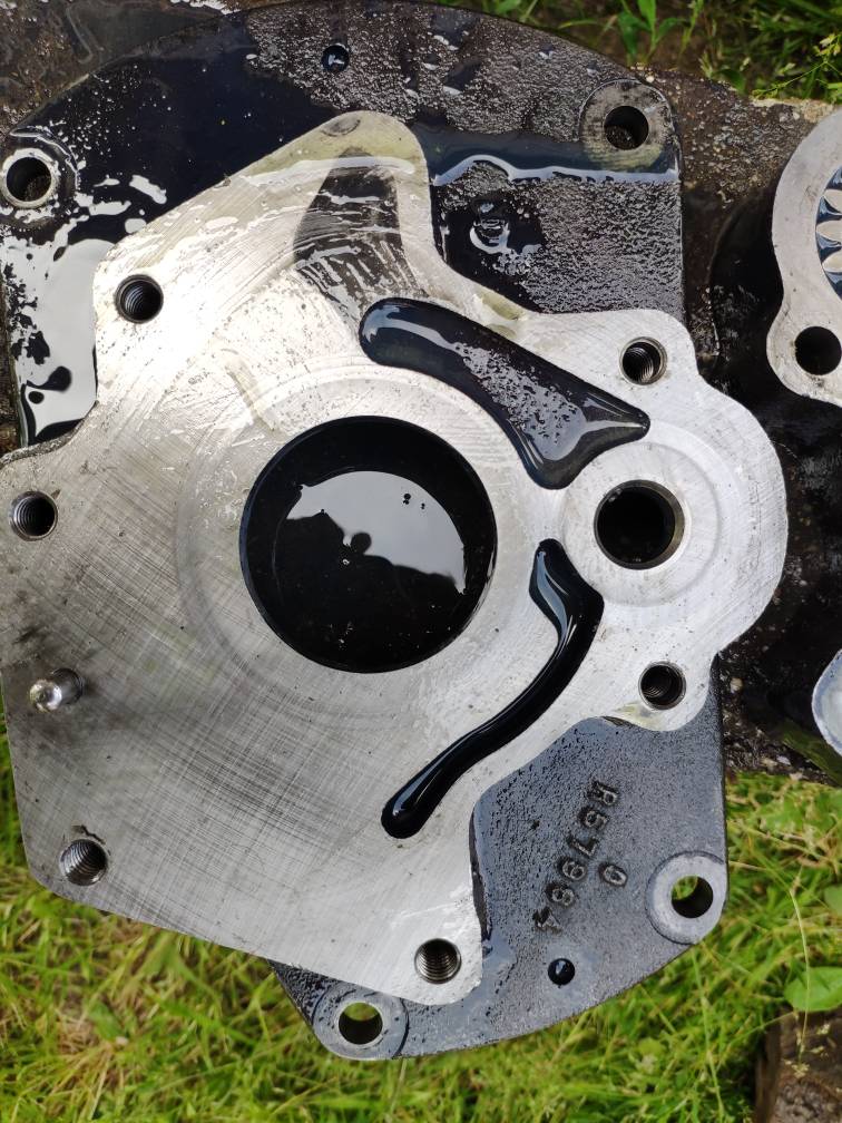

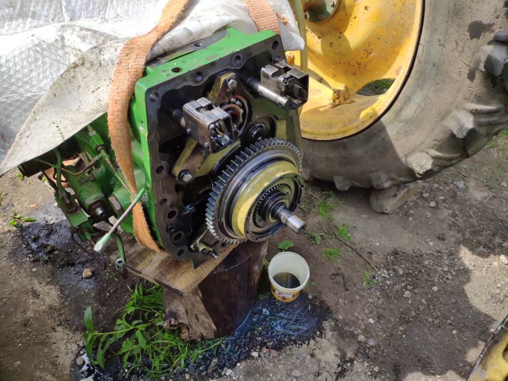

I finally had time to split it. Here are some pictures. I think the trans pump is shot. IMG_20200605_160044.jpegIMG_20200605_160047_1.jpegIMG_20200605_160110.jpegIMG_20200605_160636.jpegIMG_20200605_160813_1.jpegIMG_20200605_160817.jpegIMG_20200605_160836_1.jpegIMG_20200605_160927.jpegIMG_20200605_160932.jpegIMG_20200605_160949.jpeg

I found the pump, but haven't had any luck so far with that adapter.
   / John Deere 2130 hydraulics scheme #25
Did you do your tests before you oped up the tractor ?
Very big Q !
Golden rule no 1 Do your tests before splitting ! Then you know what to look for !
   / John Deere 2130 hydraulics scheme #27
Sorry to say....rebuild the tractor and do your tests as stated in post 2

#28
It has quite a bit of scarring. I saw a few videos online and they said that it should be glass like smooth. It also has a lot of play in the shaft

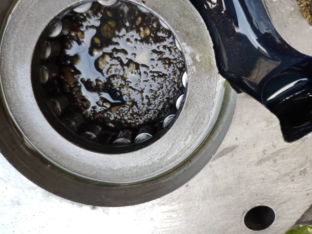

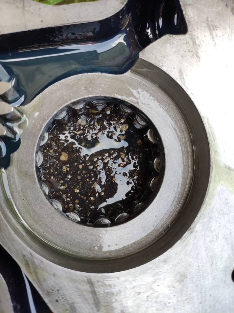

#29

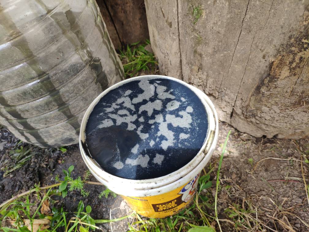

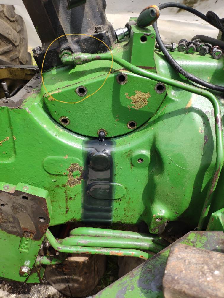

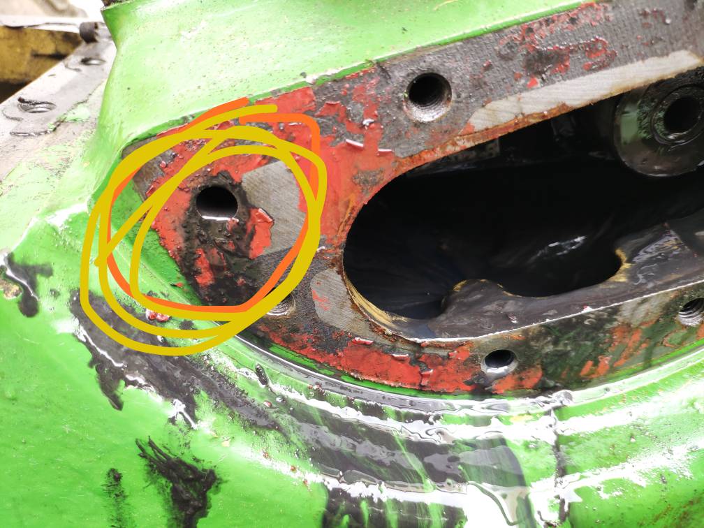

Today I opened up the cover underneath the steering column. The oil smelled really bad (burnt) and there is quite a bit of grey metal floating inside. The hole highlited on the last photo leads nowhere on the cover.IMG_20200606_123631.jpegIMG_20200606_124106_1.jpegIMG_20200606_124318.jpegIMG_20200606_123913.jpegIMG_20200606_125615.jpeg
   / John Deere 2130 hydraulics scheme #30
You have powersteering. I am willing to help you with this problem. That oilleak can be repaired after solving you main problem. Testing needs to be done !20200606_124712.jpeg
