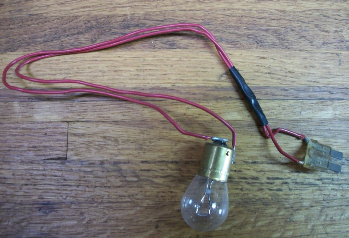

Some pics may help render an answer for you.
To poke around for the short that is causing the fuse to blow, rig up a jumper with a 12v bulb to plug into that fuse spot that blows.
   / JOHN DEERE 2305 FUSE BLOCK QUESTION #4
^^^Everyone should make one. I'm a retired electronic technician. A lamp in place of a fuse is fantastic because it's now a current limited circuit. Otherwise you just keep blowing fuses! A bright light means a heavy load (i.e., short). Now if it's a 10 amp circuit and normal current draw is, say, 4 amps the light will be bright even if all is well...you can just use a higher current bulb like incandescent headlight.
When bulb is bright you find short by unplugging things one at a time, moving wires, etc.
