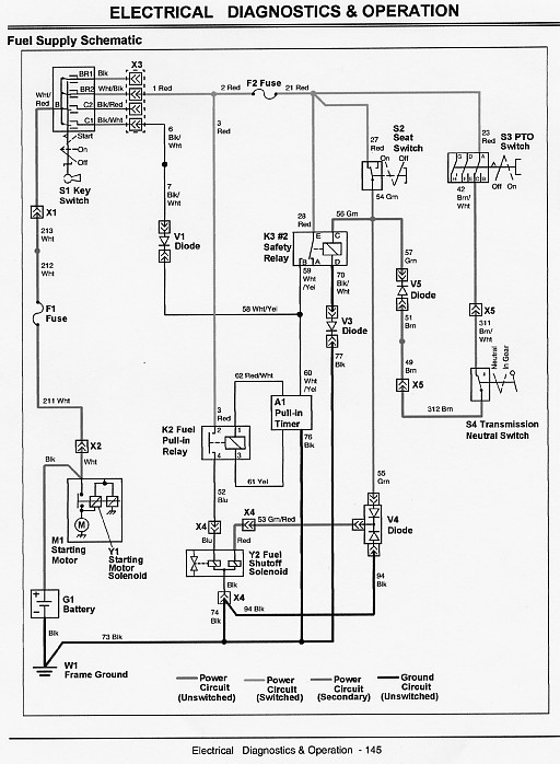

I have a 2008 JD 2305 With loader. Awsome little tractor. Recently it has not wanted to stay running. It has done this several times and cleared itself up until now. It starts and then dies just as quick. I have changed filter, checked fuel flow, checked saftey switces that I can think of. I have replaced the solenoid on the injector pump and still no change. If I remove the solenoid the tractor will run. $218.00 later im stumped. Any suqestions?

Hope this helps.

Sounds like the A1 Pull In Timer or V 4 Diode is malfunctioning. See if this diagnostic procedure will help isolate the problem.

"After watching the YouTube video, I would suspect that the V4 diode is failing or there is a circuit issue with the V4 diode. - Please Refer to Technical Manual "TM2289" pages 144-148 for testing and resolution of the V4 Diode, and this should remedy the problem you are having with your J.D. Model 2305. - Kindly note that the dealership can open a case with their dealer technical assistance center for additional help here should that be necessary."
